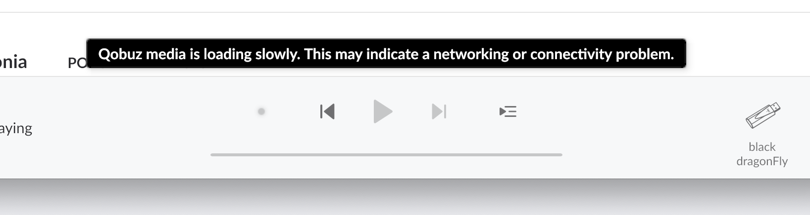

Slow Qobuz media loading indicates potential connectivity problem (ref#51T4F8)
· "Qobuz media is loading slowly. this may indicate a networking or connectivity problem"
· no issues prior to roon update.

This error indicates that the Qobuz API didn’t serve content to Roon before the audio stream caught up with the buffer.
Sometimes, this occurs because the DNS service assigned for your network can’t reliably resolve the URLs associated with Qobuz track streams, and RoonServer has to re-request them. We usually recommend checking this first, since your internet service provider can sometimes change the default DNS provider with router firmware updates.
Enter your router settings administration page and look for a section related to DNS. Assign Cloudflare (1.1.1.1) or Google (8.8.8.8) as the default DNS service. If you provide the make/model of router you use, we can assist with this step.
Another possible reason for Qobuz to download slowly to RoonServer is a bad network pathway - if you use a VPN with Roon, try disabling it or changing the geolocation.
Do you have any issues playing content in the native Qobuz app or web player?
