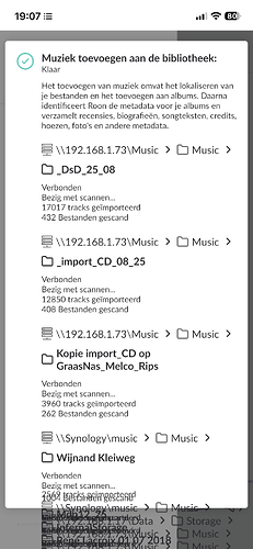

· Where internet acces the house there is a Ziggo Modem/Router(The Netherlands). From here an Orbi Mesh netwerk with RBR20 Master with 2 Satellites RBS20. From the Master RBR 20 to a Buffalo ■■-GS2016 switch. From this switch to my living where the Melco S100 switch goes to a Nucleus Plus with 4 TB internal storage. From the Melco S100 to a Wadax Studio Player.
In the same netwerk there is a Synology NAS for storend files. Also using TIDAL and Qobuz.
When music stops sometimes it looks like, without any reason, the complete libary is scanned. Till this is finished it’s not possible to play any tracks. More and more as a bypass I play now by TIDAL or Qobuz Connect by the Wadax Studio Player direct as Roon is not working at all.

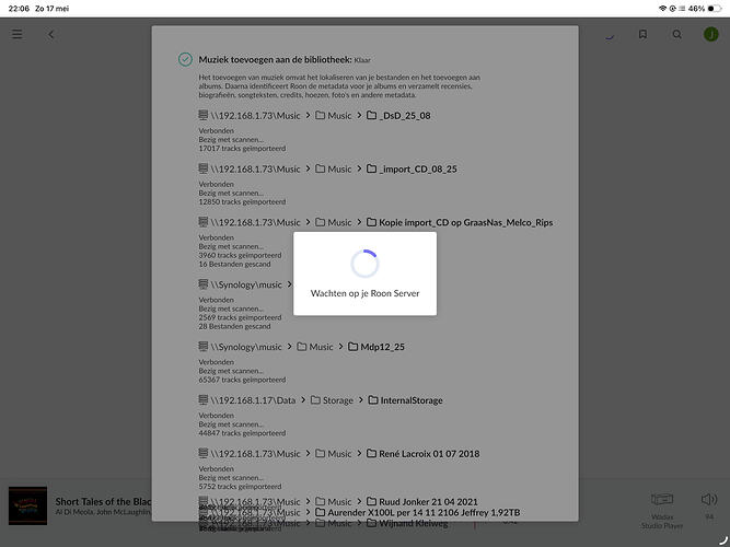

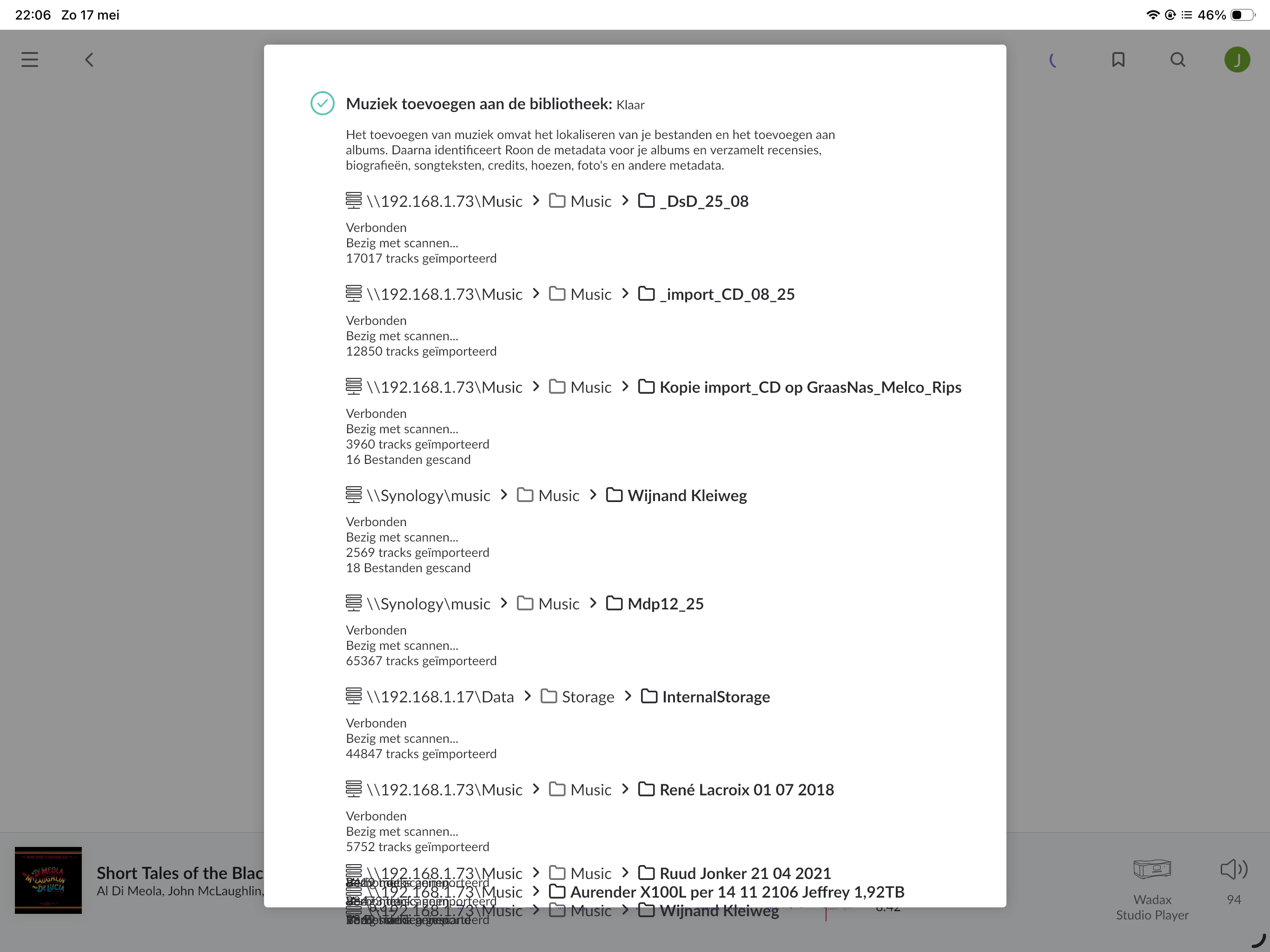

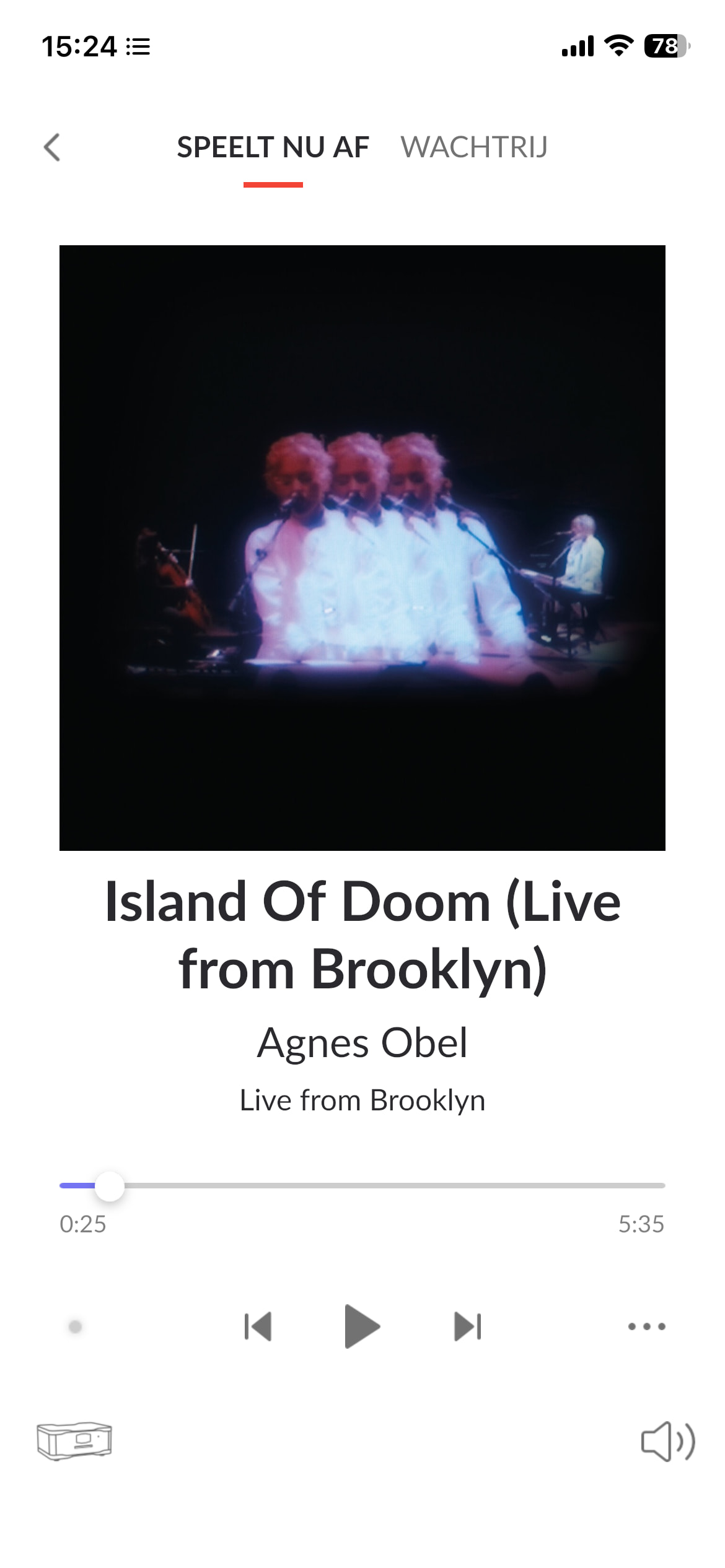

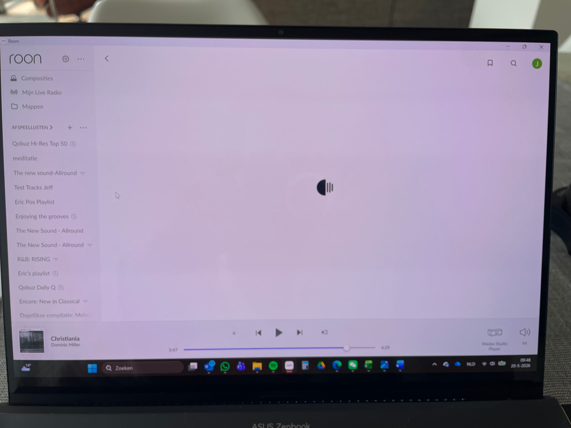

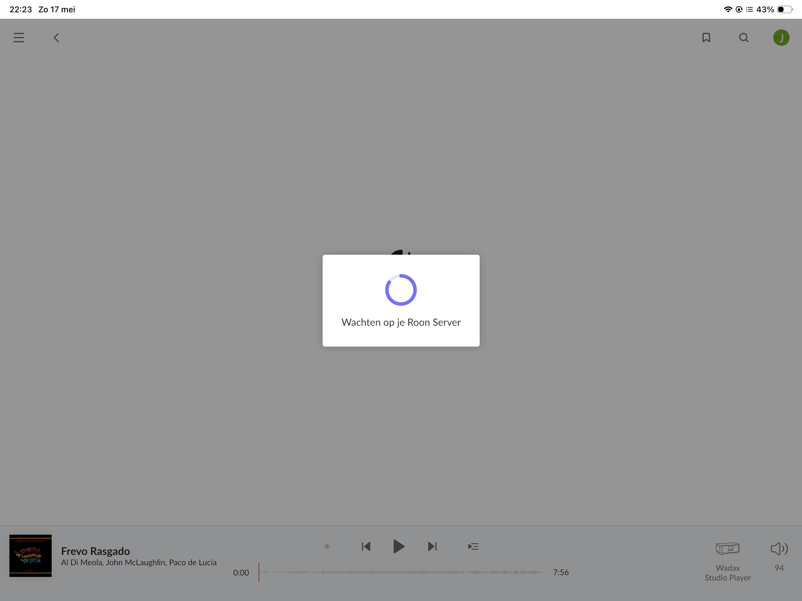

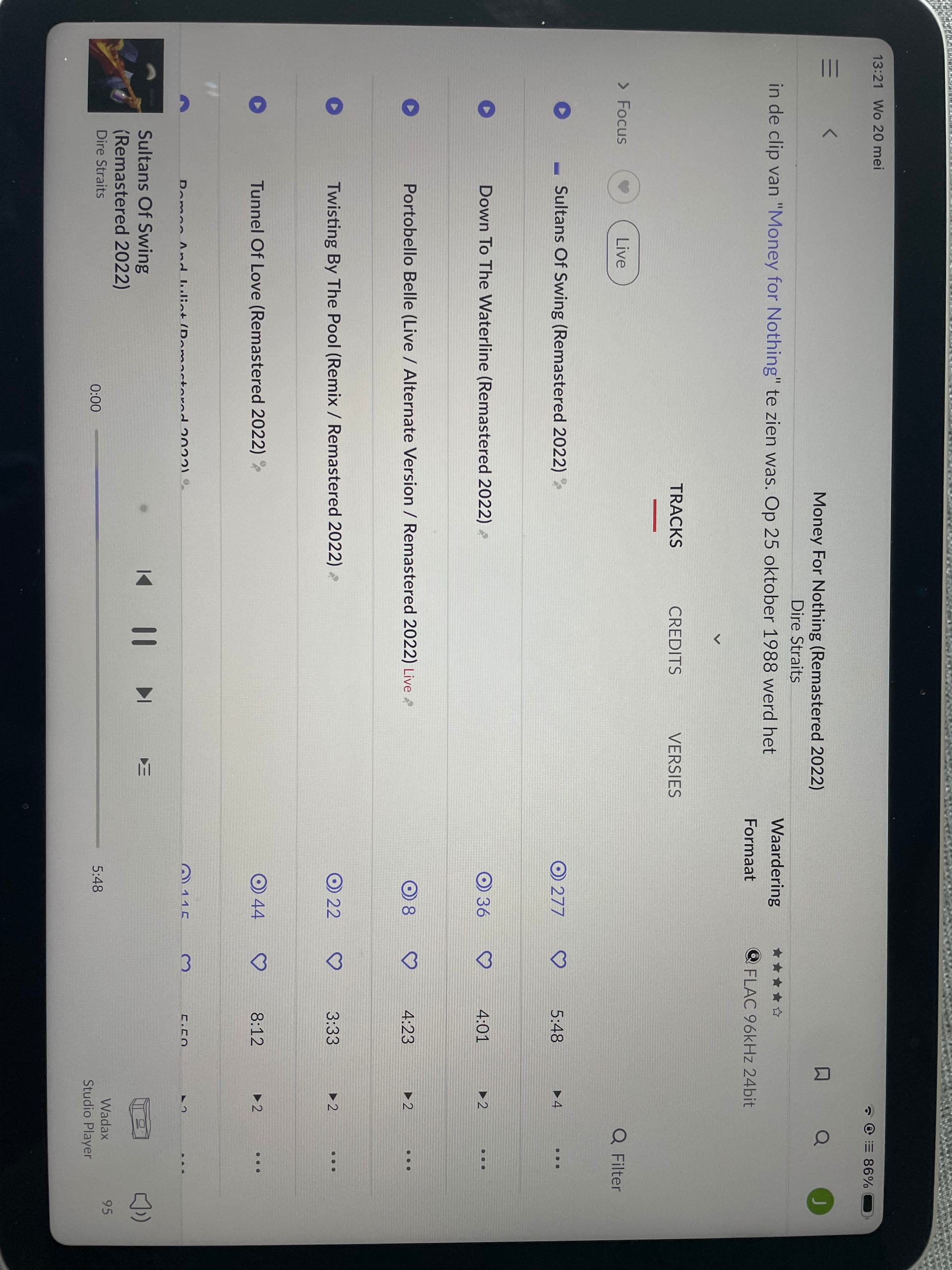

More easy is to look at the pictures I took where the exact time and date are shown. Be aware of the time zone in The Netherlands and you have the correct information when this happened.

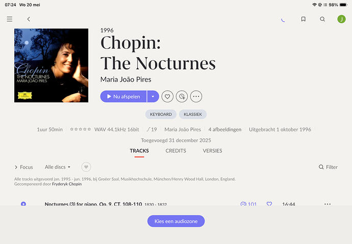

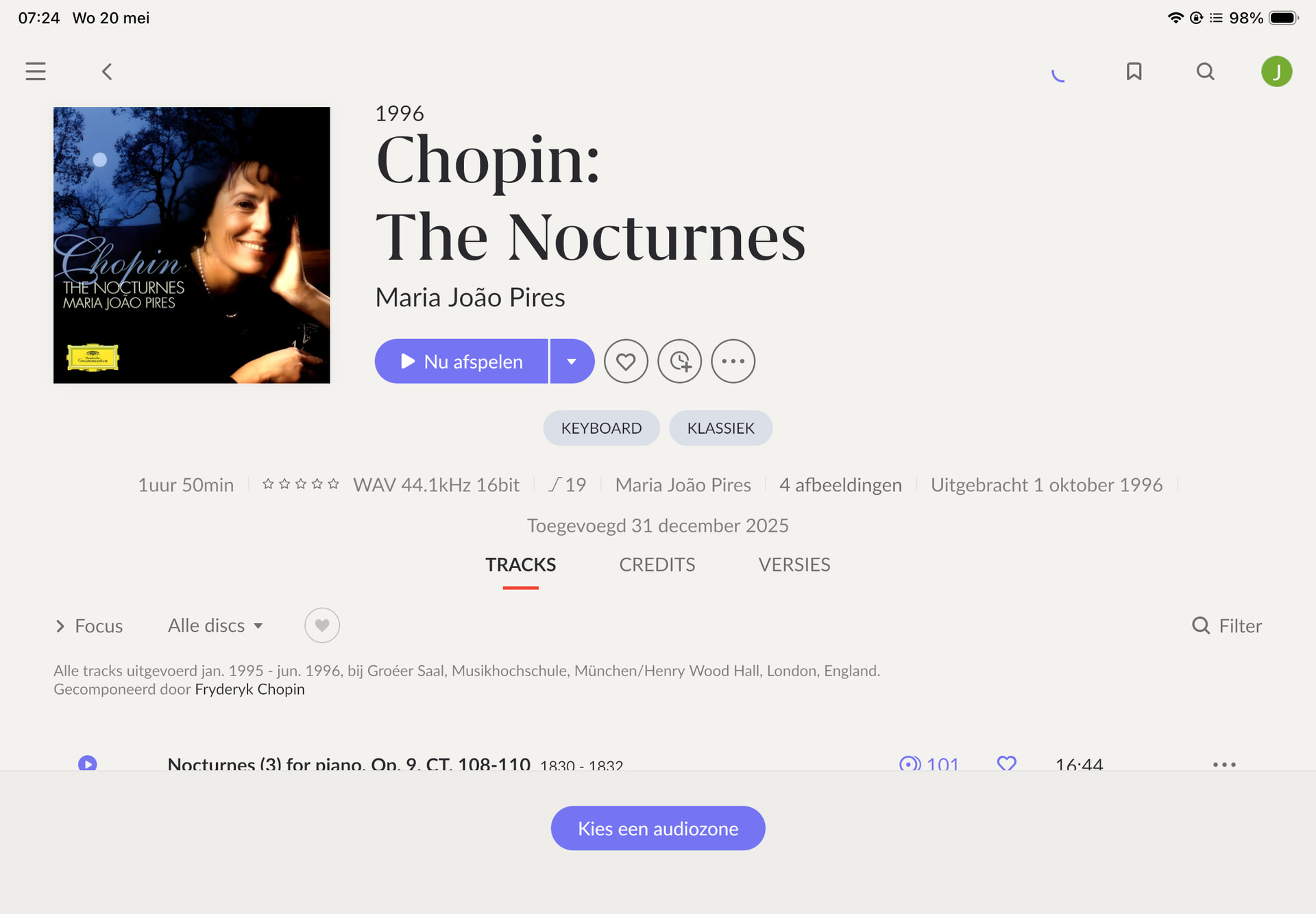

Hello Vadim,

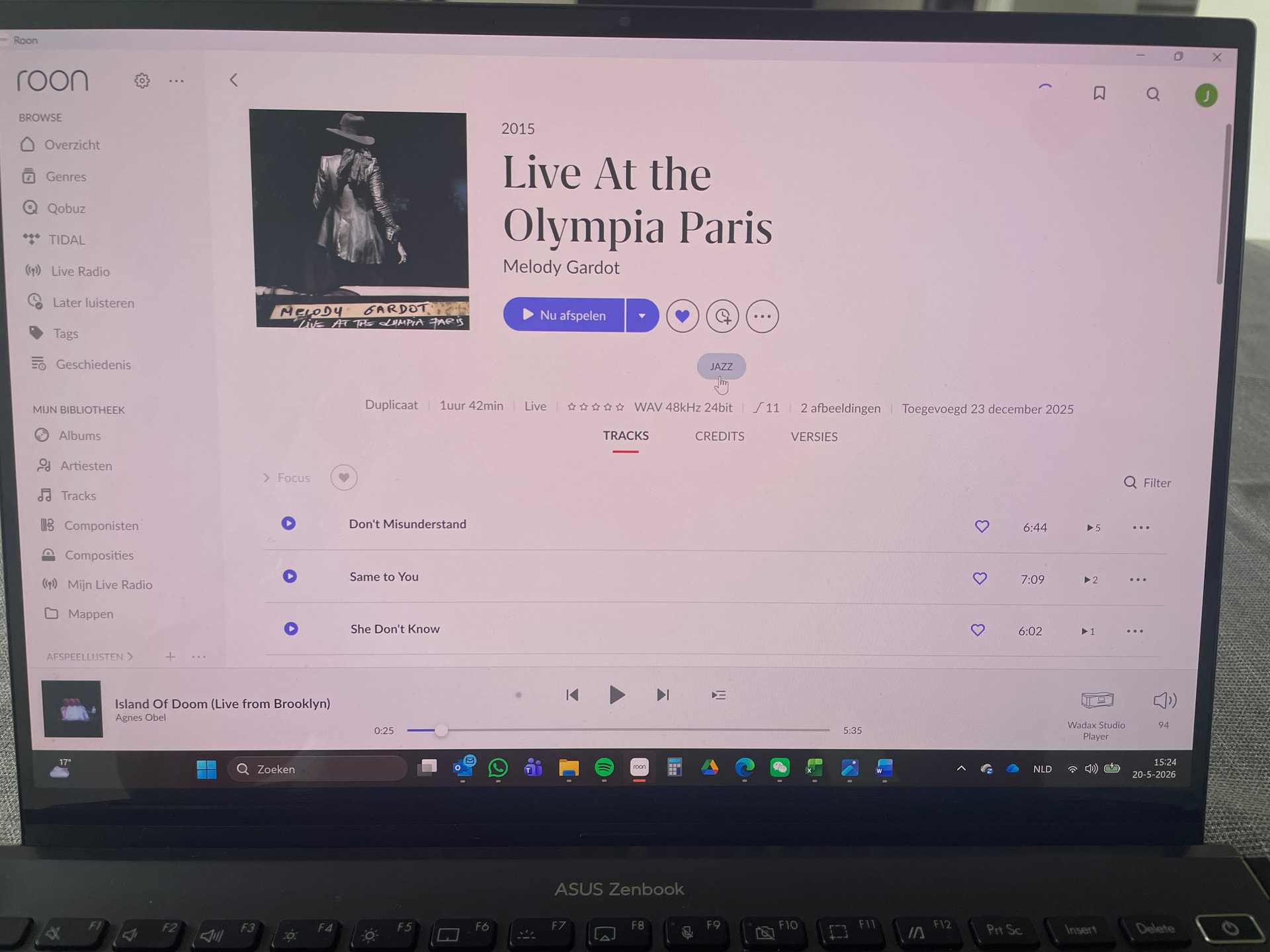

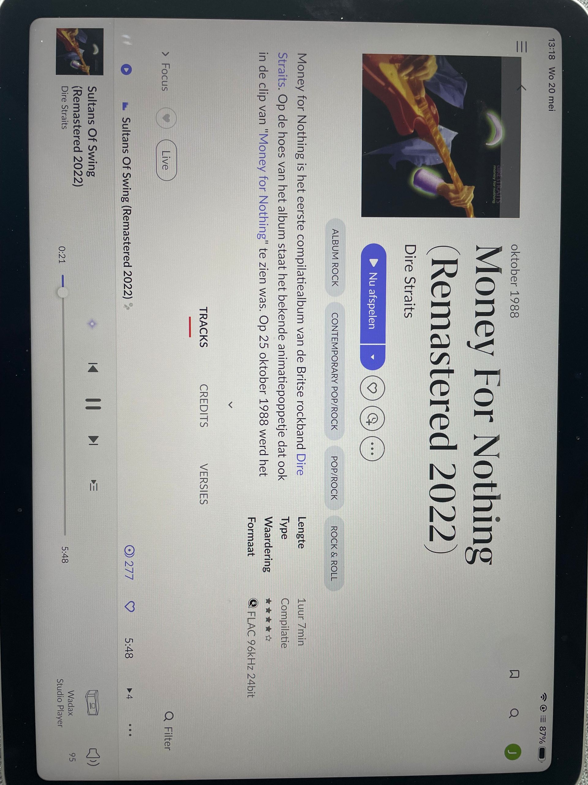

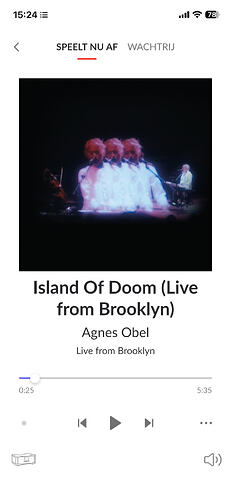

Not exactly the same issue but at the next picture the music stopped playing. Today at 7.24AM lost connection to audio zone but found it again. I had to push the play button again and the music continued where it stopped.

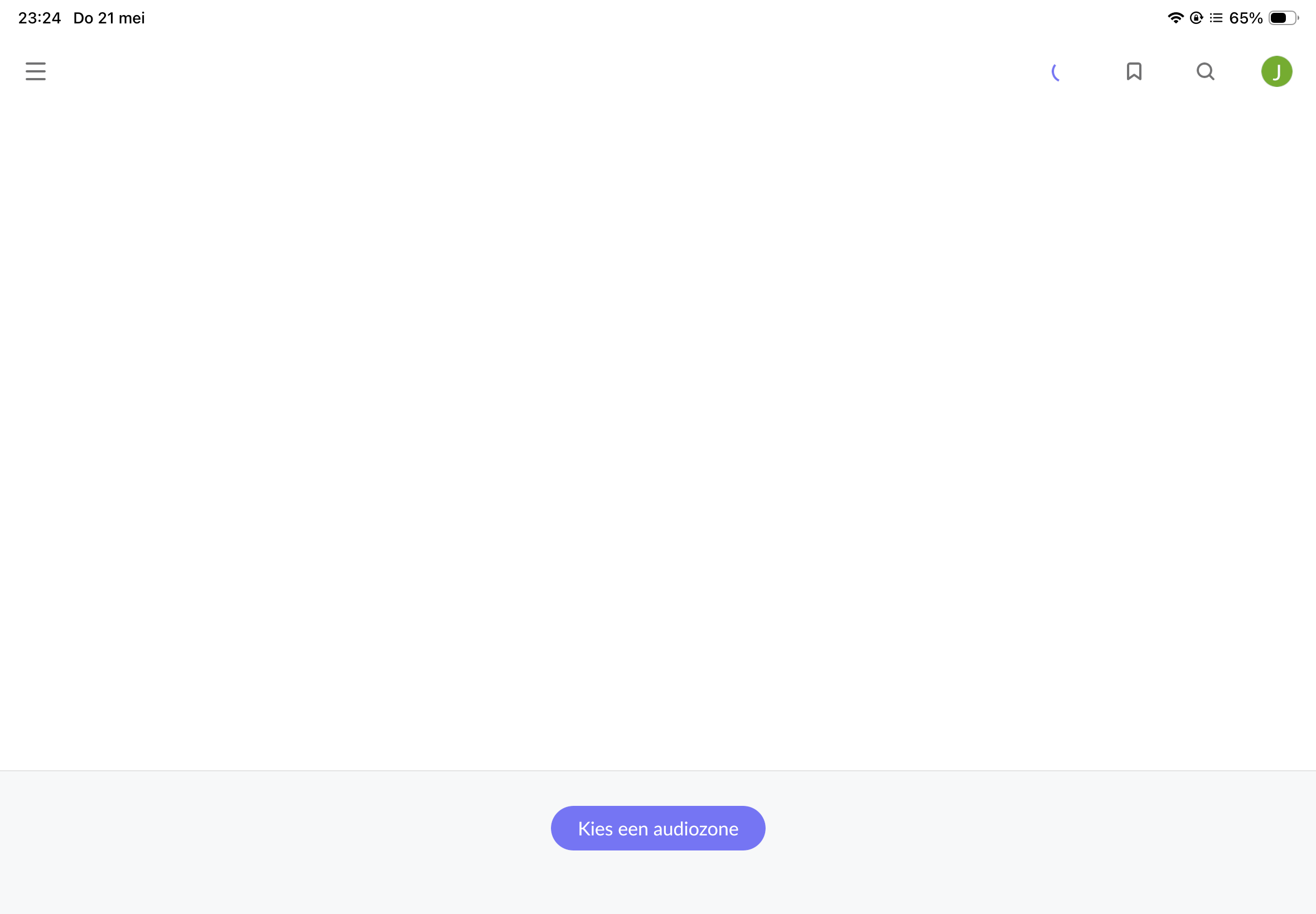

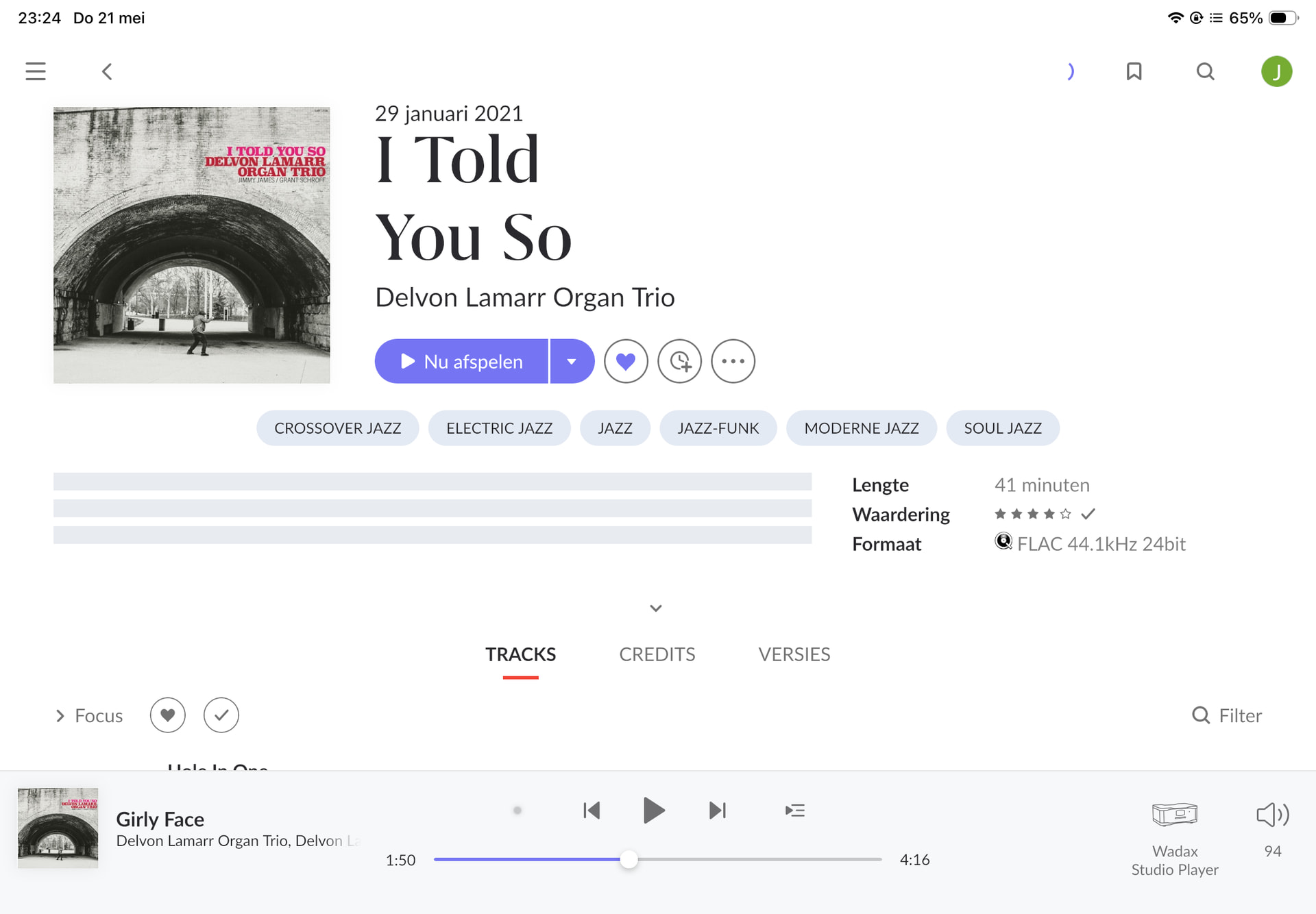

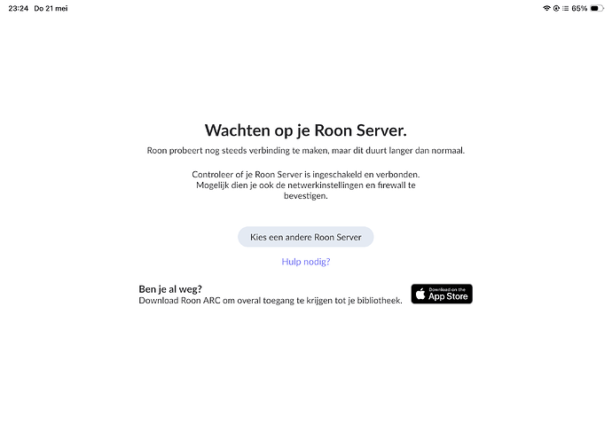

Hello Vadim,
Here some pictures where Roon lost the control and stopped. You can see the time and dates.

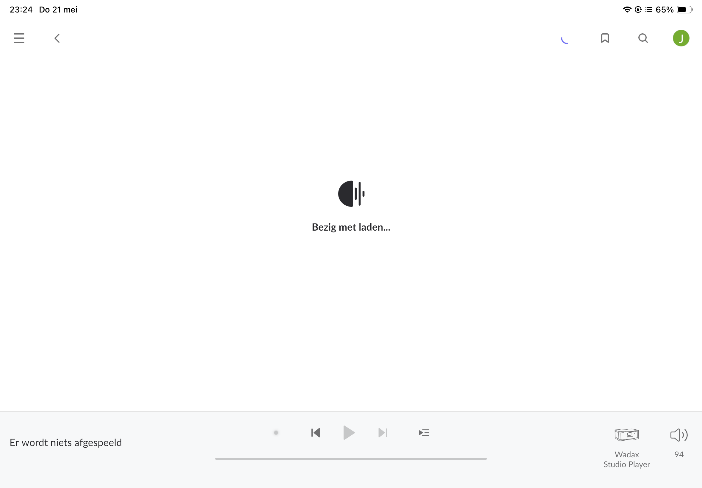

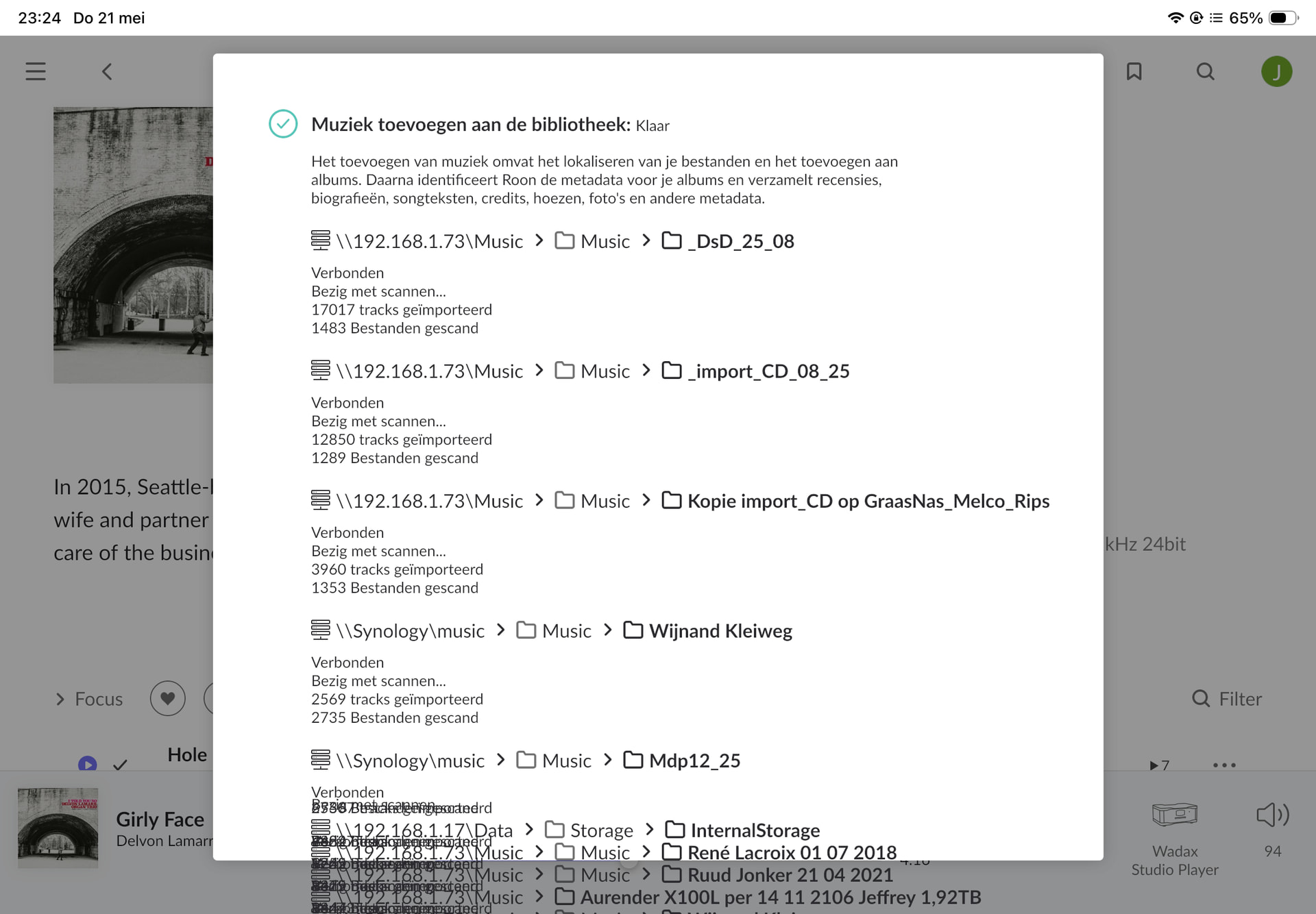

Hi Vadim,

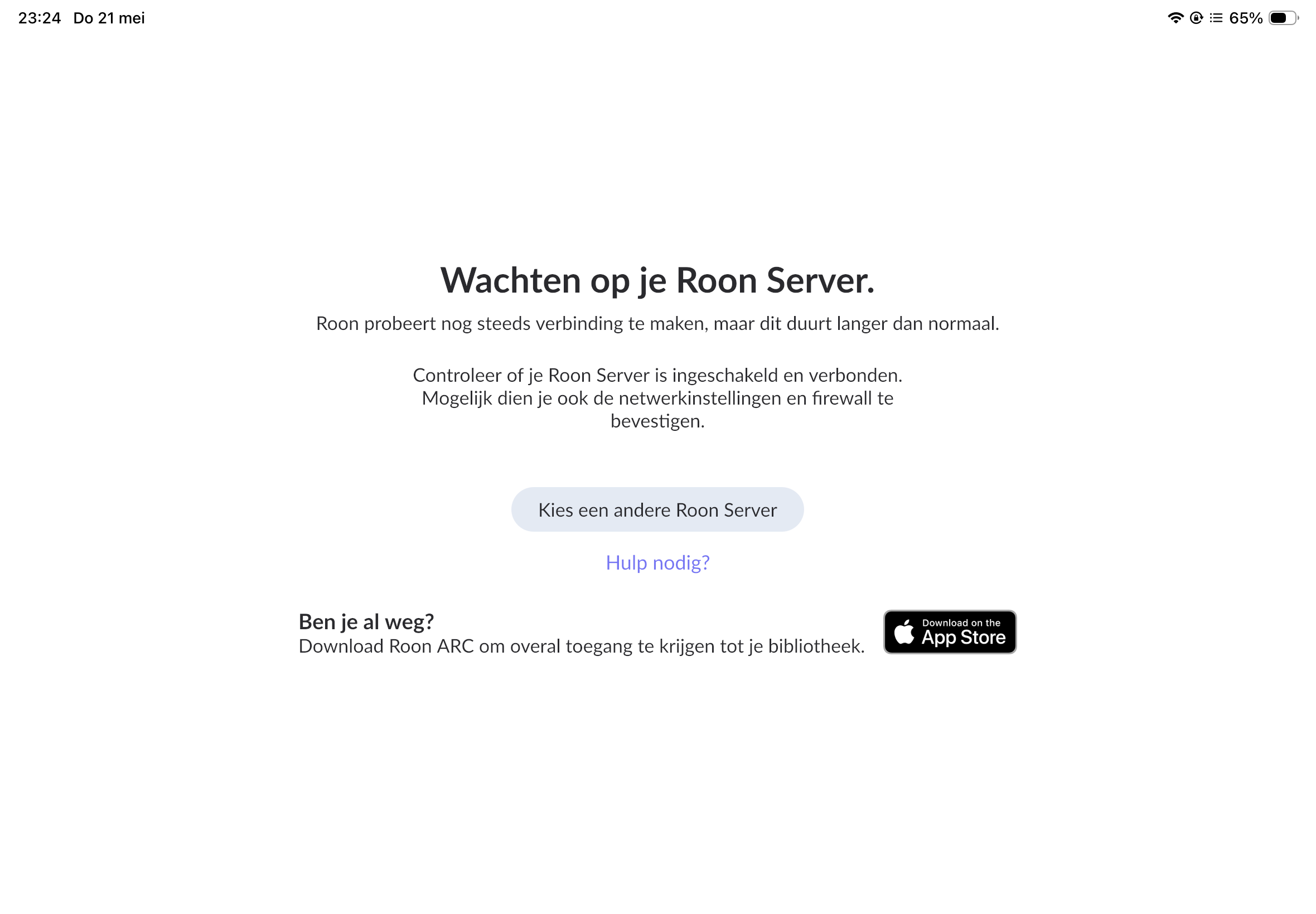

Just right now the exact same thing happened as I mentioned at my First message.
Listening to a track, the music stopped and see the screenshots I took and check the time and date at the left upper corner of each picture. Date 21st May 2026 started at 23.24 hr.
Hello @Jeff_S,
Thanks for the details and logs. They clearly show the cause of the freezes and continuous library scans:
  1. Network Micro-Drops: Your Nucleus+ is constantly losing connection to the audio endpoints (and even its internal processes) due to dropped multicast traffic.
  2. Scanning Loop: Because of these brief network disconnects, Roon temporarily loses sight of your Synology NAS. When it reconnects, it triggers a massive background re-scan that overloads the Nucleus and freezes the system.
  3. Complex Chain: Cascading multiple switches (Buffalo + Melco) behind a Mesh system is likely dropping the sensitive audio packets.

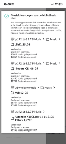

@benjamin Hello Benjamin,
Things have been changed, Roon was working fine but now a couple of times suddenly stopped playing music. Radio or Album track, same result.

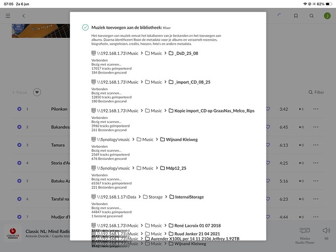

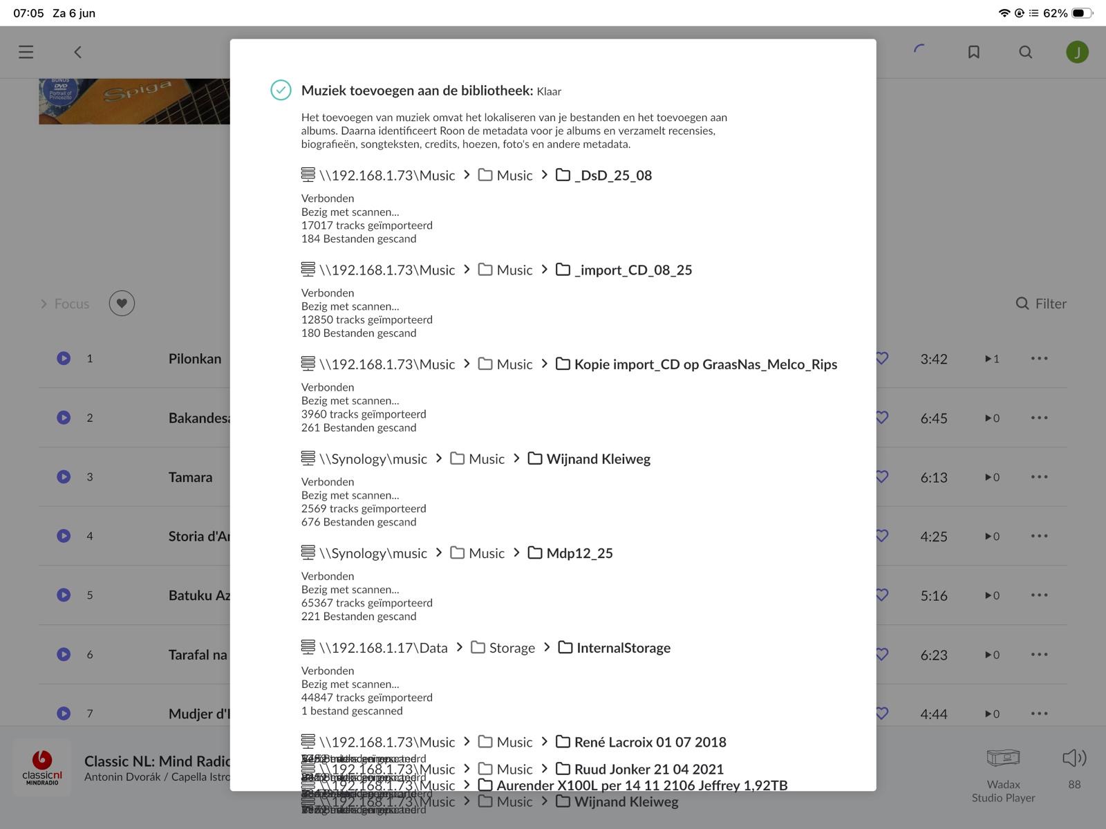

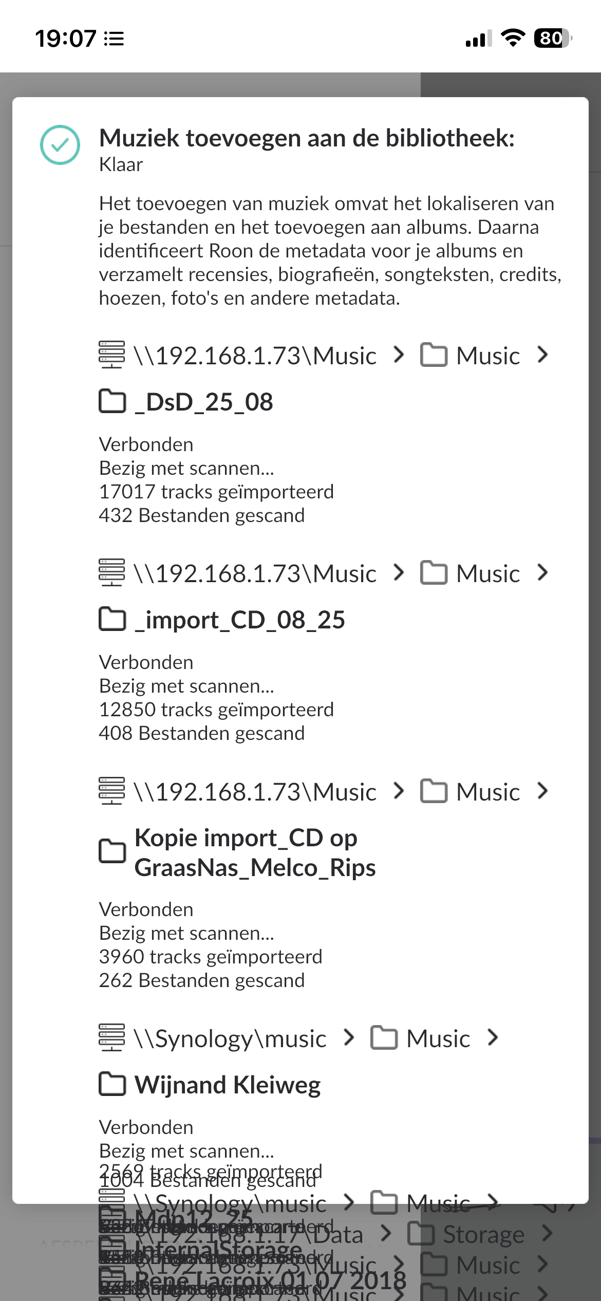

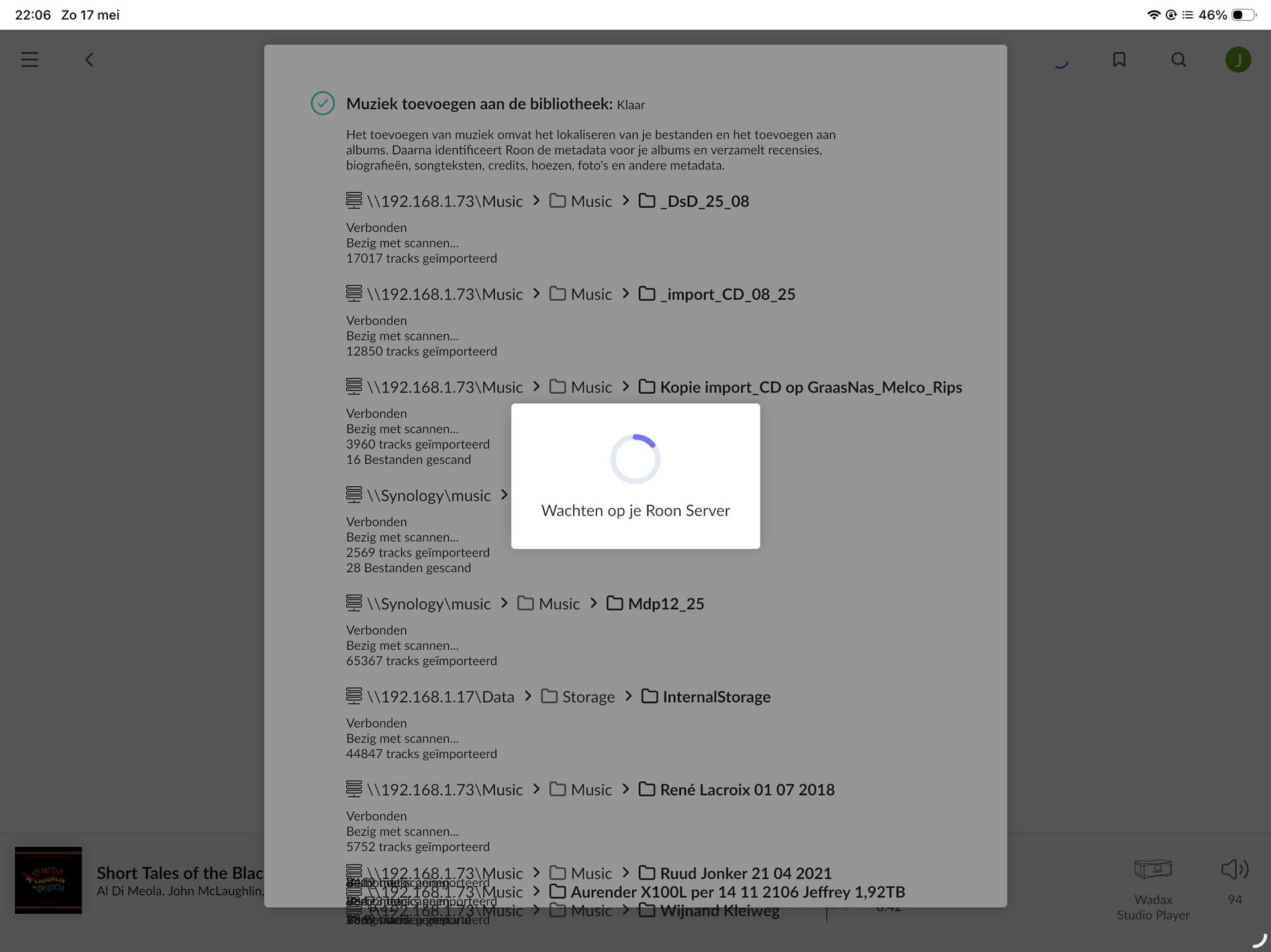

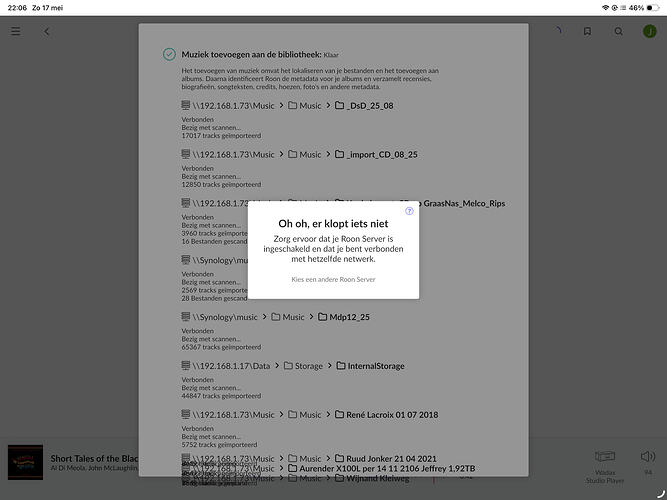

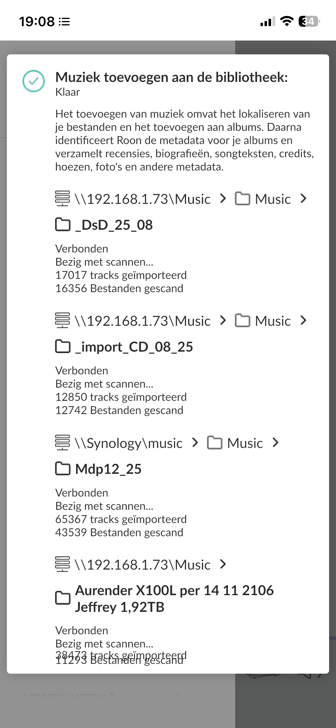

Without any reason the the system runs an index, see below and look at the different moments it’s happening. What could be the reason for this behavior? How to avoid this?
Hello Benjamin,
Unfortunately the behavior of Roon went down even more and stopped the music which was playing. Without no reason or adding any music, Roon started to re-index the library which stops the music for whatever reason. Even when all settled down it still is almost impossible to find an Artist, Album or Track. It takes ages like 20 minutes or not even at all to start any of the above when found.
