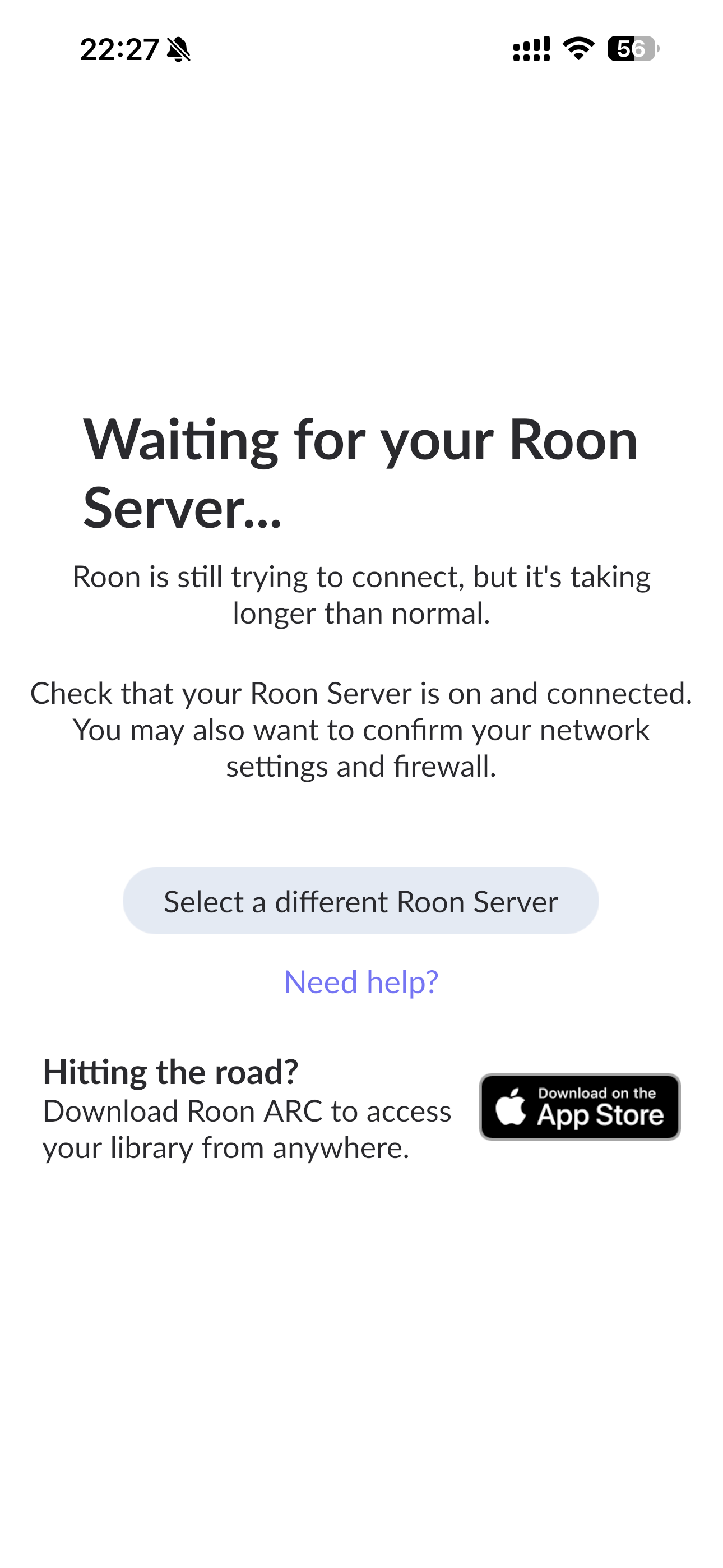

Slow Roon startup and long breaks between tracks (ref#V5UFRV)
What app are you having the slowness issue with?
· Roon
What kind of performance/speed issue are you experiencing?
· The app takes a long time to respond to commands
Please try to reboot your Roon Server
· No, the issue is still the same even immediately after a reboot
Please try to reboot your networking gear (Router/Switches/etc.)
· No, the issue is still the same even after a reboot
Is there any change in behavior if you try to navigate to Roon Settings -> Library and set both Background and On-Demand Audio Analysis to Throttled or Off?
Does the issue happen on multiple Roon Remotes (controllers) or just one?
· Issue happens on multiple remotes
Router Domain Name System (DNS) change
· I don't know how to do this
· Nucleus
Which model Nucleus do you have?
· Nucleus+ Rev A
Timestamp of issue occurrences
· Notices this several times each day. Last time was around 9:03pm nepal time, apr 21. Following this there was a number of succesfull attemps on opening Roon.
Long Roon startup (10-30 sec); long breaks between tracks etc
ISP is Worldlink in Nepal. Router is TP link GXE75. TP link switch is connected to the router. Nucleus+ revA; My NaimQb; and two blusound speakers are connected with ethernet to the switch.
