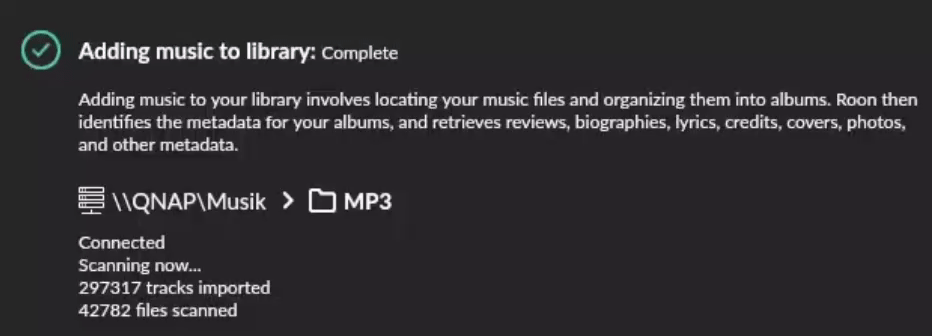

Scanning is extremely slow, it took a week to scan approx. 65 % of the files.

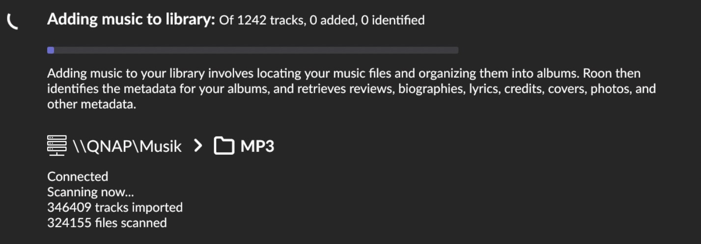

Unfortunately it looks like there’s still something wrong.
I thought that after the initial analysis only new files would be scanned and added, but now I see this:
EDIT: I have deactivated the QNAP storage now and will replace it by a USB drive connected to the roon server.
Let me know when I shall activate the QNAP storage again for troubleshooting.
