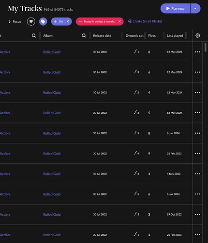

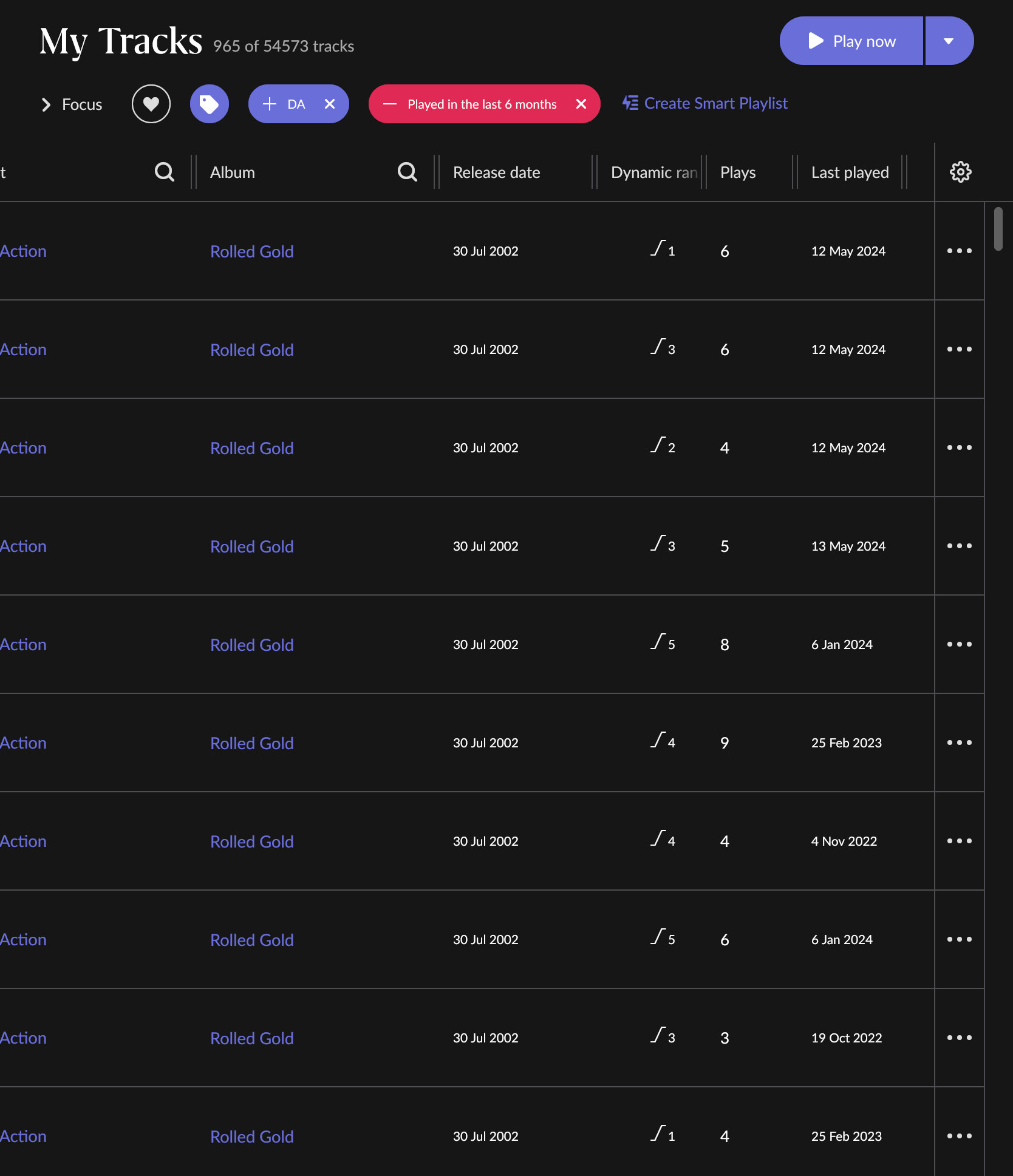

I think the closest you’ll be able to get - and I’m guessing this is what @Suedkiez tried and redacted - is to tag your favorite albums and then go to track mode and select your tag and filter on last played like so:
But this won’t include one-off songs from your favorite albums that you have heard in the past 6 months….
