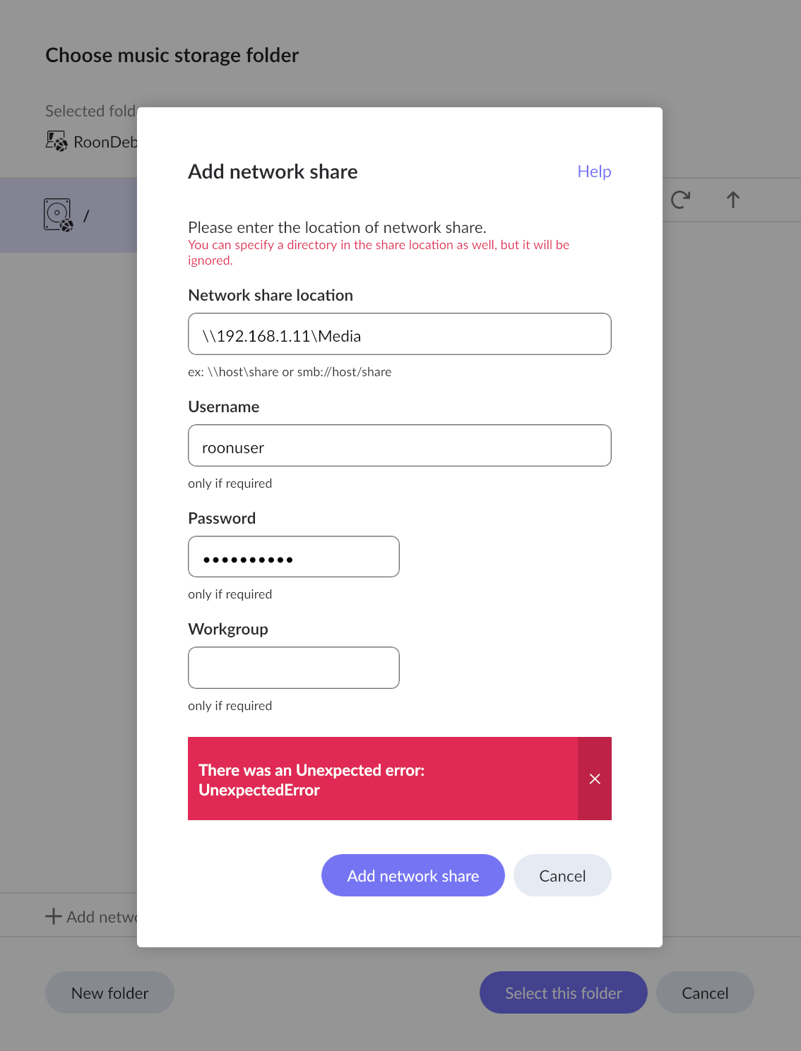

SMB mount failing with "UnexpectedError" on Roon (ref#PELXCM)
· SMB mount failing with "UnexpectedError"
· Share sits on a truenas server, roon core is running on a clean debian install.
For additional information: this mount succeeds with no problem if I do it manually via fstab / cifs with the same credentials. I also get a different error message “share not found” if I instead type an incorrect share. There is no information in the server logs for any failure

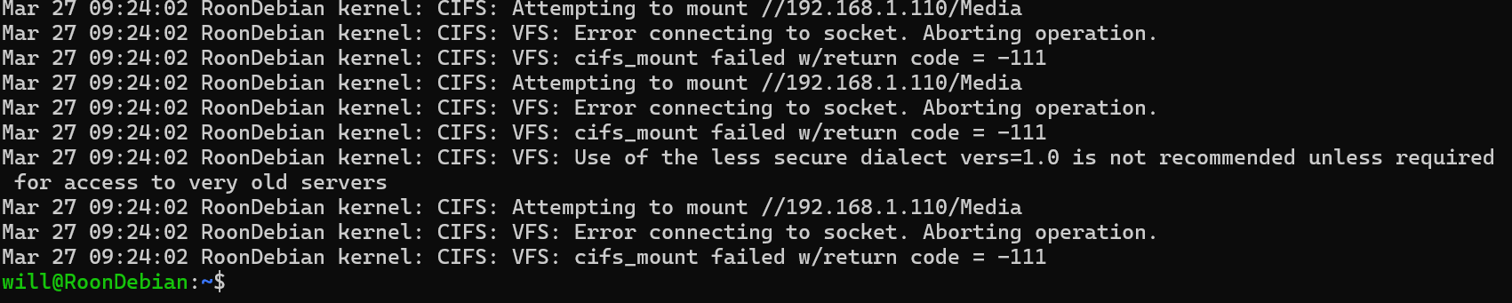

Thanks BlackJack, it does look related though I see different errors in the CIFS logs when attempting to mount through roon. Honestly if I could just schedule forced rescans every x timeframe for “local” folders I’d be happy as I could just do an os level mount through fstab.
