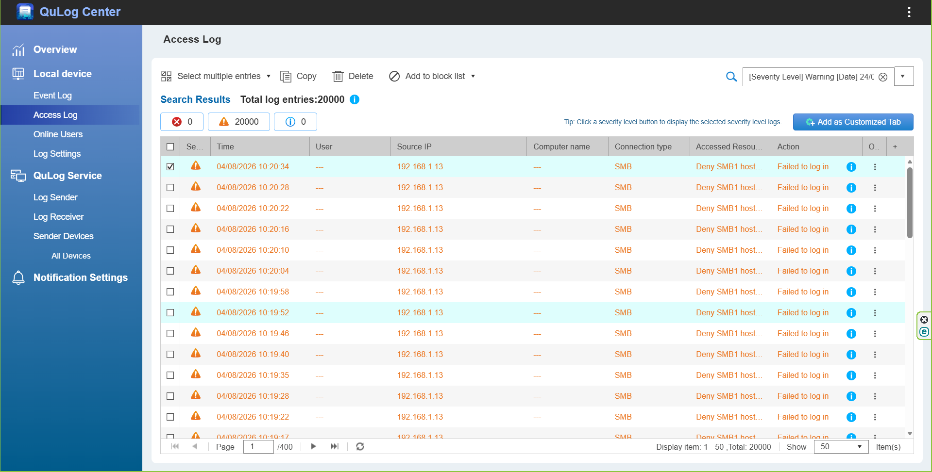

SMB v1 requests fail on Roon ROCK to QNAP network share (ref#MXRGF0)
· SMB v1 requests fail from Room ROCK Version 2.1 (build 271) to QNAP network share every 5 seconds
· QNAP does not accept SMB v1, it is depreciated. Why is Roon ROCK using it? Roon works as normal ....

Ah, OK. Thanks for the explanation! It’s annoying but not the end of the world. Maybe I’ll just exclude that from the logs as it’s filling them up nicely.
Thanks also Vadim. There’s no way I was going to re-enable SMB v1! I do see a valid connection as it progresses up the SMB versions. Just thought I might be able to exclude the Roon ROCK from the smb logs somehow. I will keep an eye on the v3.0 update.

More importantly, when we looked at the full diagnostic logs rather than just the summary, we found this isn’t just background negotiation noise like we first assumed. Your hd audio share specifically is not mounting at all right now. We can see repeated connection attempts roughly every 5 seconds, and every single one fails, across all three SMB versions Roon tries, not just SMB v1. Your Music share on the same NAS is mounting and working fine, so this looks specific to hd audio rather than a general SMB v1 compatibility issue.
A few things would help us narrow this down. Could you please check in Roon under Settings > Storage whether the hd audio location currently shows as available, or whether it shows an error or offline status? Could you also please confirm on the QNAP side that the hd audio share still exists under that exact name, and that the Roon user account still has read/write permission to it? If anything changed recently on that share (renamed, moved, permissions edited, or SMB1 handling changed specifically for it), that would be useful to know as well.

Interesting. I did have an HD Audio folder/share too but had multiple HDD issues recently on the QNAP followed by the Roon account locking on the QNAP. I never bothered to reinstate it in Roon and today I removed it! The share is reinstated on the QNAP and probably just needs reconnecting, but I barely used it. The relevant permissions should have been given to the roon account but I may not have bothered! Trying SMB versions in descending order does make more sense. I think we can call this one known, thanks everyone for your help.
