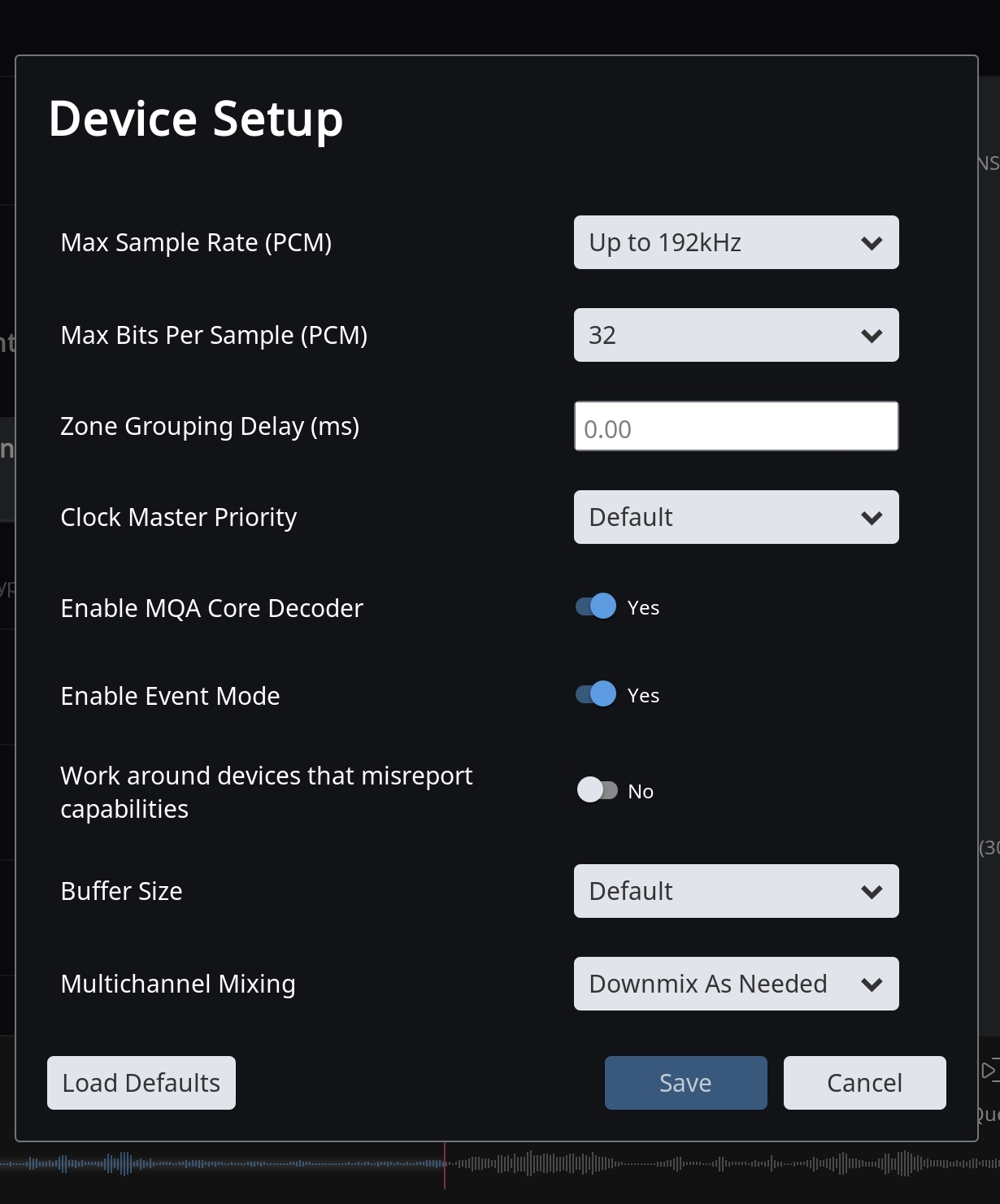

Post a screen shot of your âsignal pathâ while playing DSD material, and also one of your Audio settings for this endpoint.
Itâs easier to see whatâs going on.
These are the screens weâd like to see:

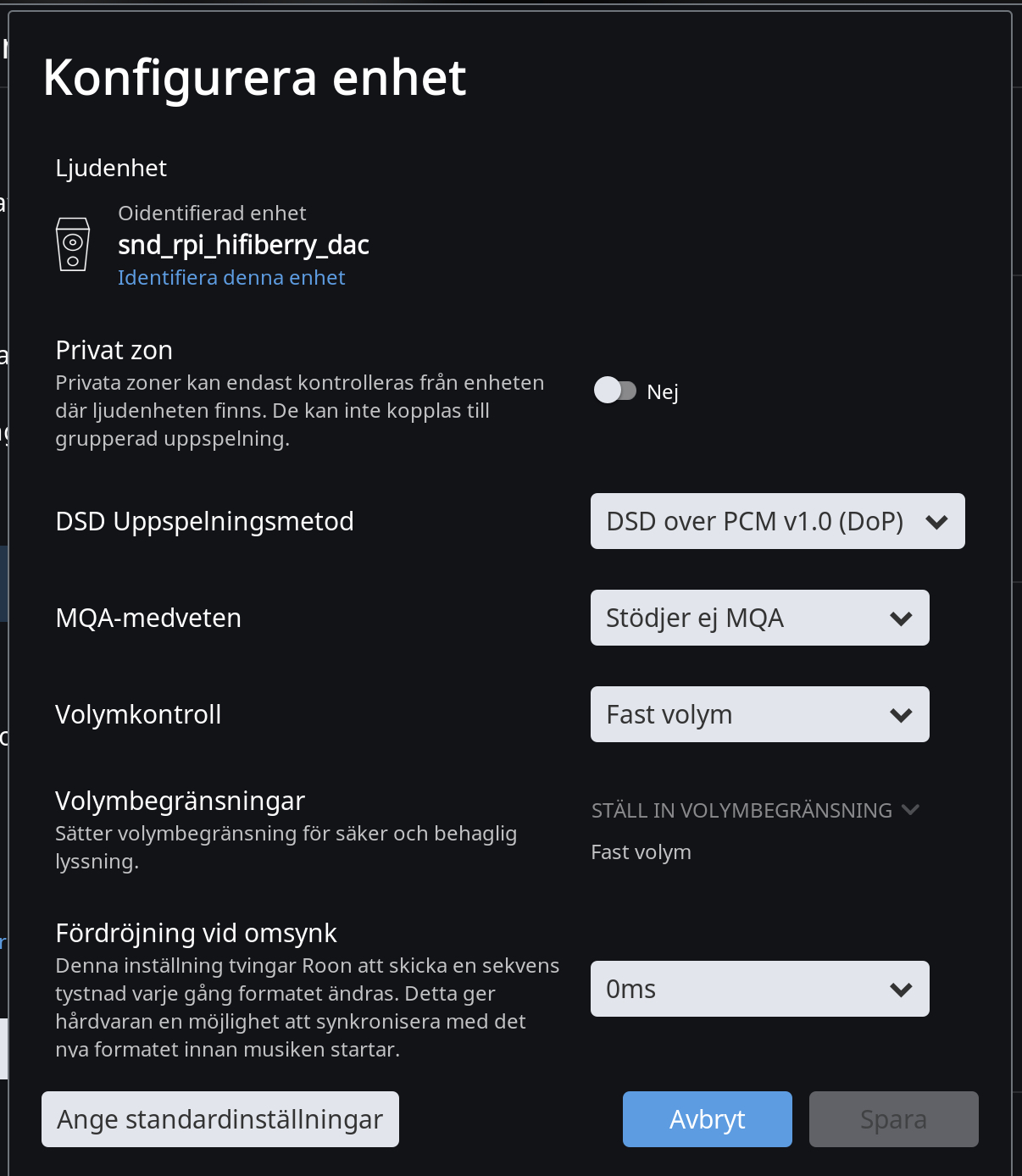

If you have another SD flash drive card maybe try a different OS like www.ropieee.org as this maybe has better device support.

Attached are screen shots. I tried jriver and it reported it was playing in DSD64, which was what I expected. It sounded awesome in any case.

Iâm new to all of this too. I have exactly the same issue as @Aaron_Lynch in that I have latest roon core running on a linux quad core asus laptop and a ropieee bridge connected to the smsl m100 via usb. When playing any flac source up to 96khz I have no issues getting 768 pcm to the dac and it sounds great. When upsampling to dsd of any bitrate from 64-512 I get massive white noise and the volume goes off the scale. When changing to DoP on the device and sending flac upsampled to dsd I get no sound at all.
I was wondering if you got yours working with dsd and dsp Aaron?
Any help is appreciated. Cheers, Mark
