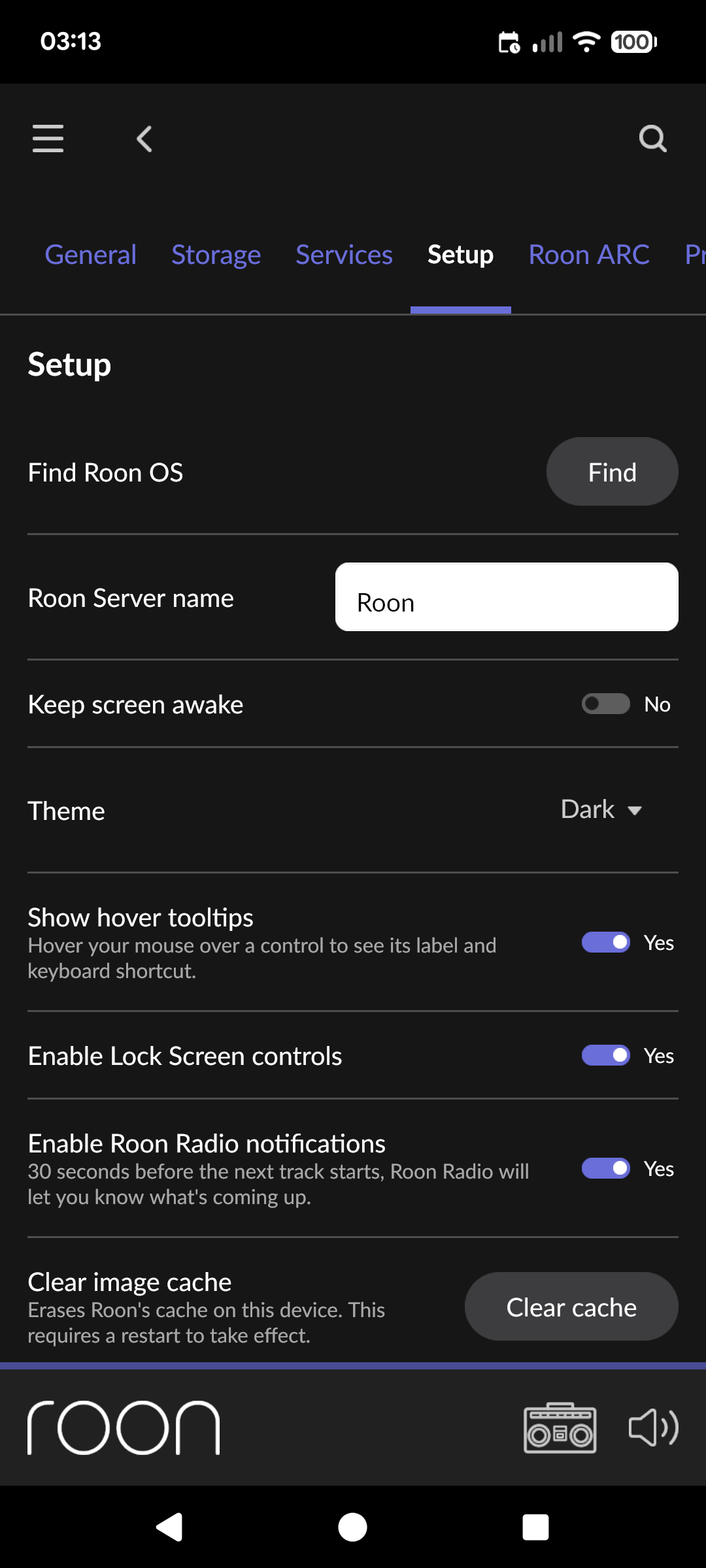

What is your Roon Server Name set to in Roon Settings Setup ( set to “Roon” in the screenshot below)?
If it is set to “ROCK”, try setting it to “NucleusTitan”.
@Wade_Oram - the Roon Server Name in :gear: > Setup is independent of the hostname, so changing this won’t have any effect on the hostname.

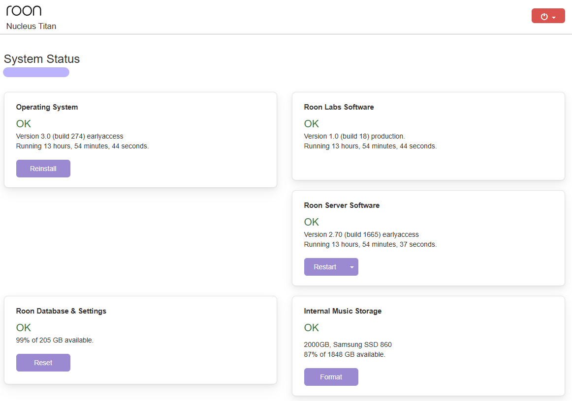

But, I agree with your suggestion: @gsuzor91 - could you please post a screenshot of your Titan’s Web Administration Interface screen?
I’ll provide more context in a bit, but I at least need some coffee first since I just woke up.
Here it identifies correctly as a Nucleus Titan. Therefore, it seems that what I wrote here is still a possibility:
