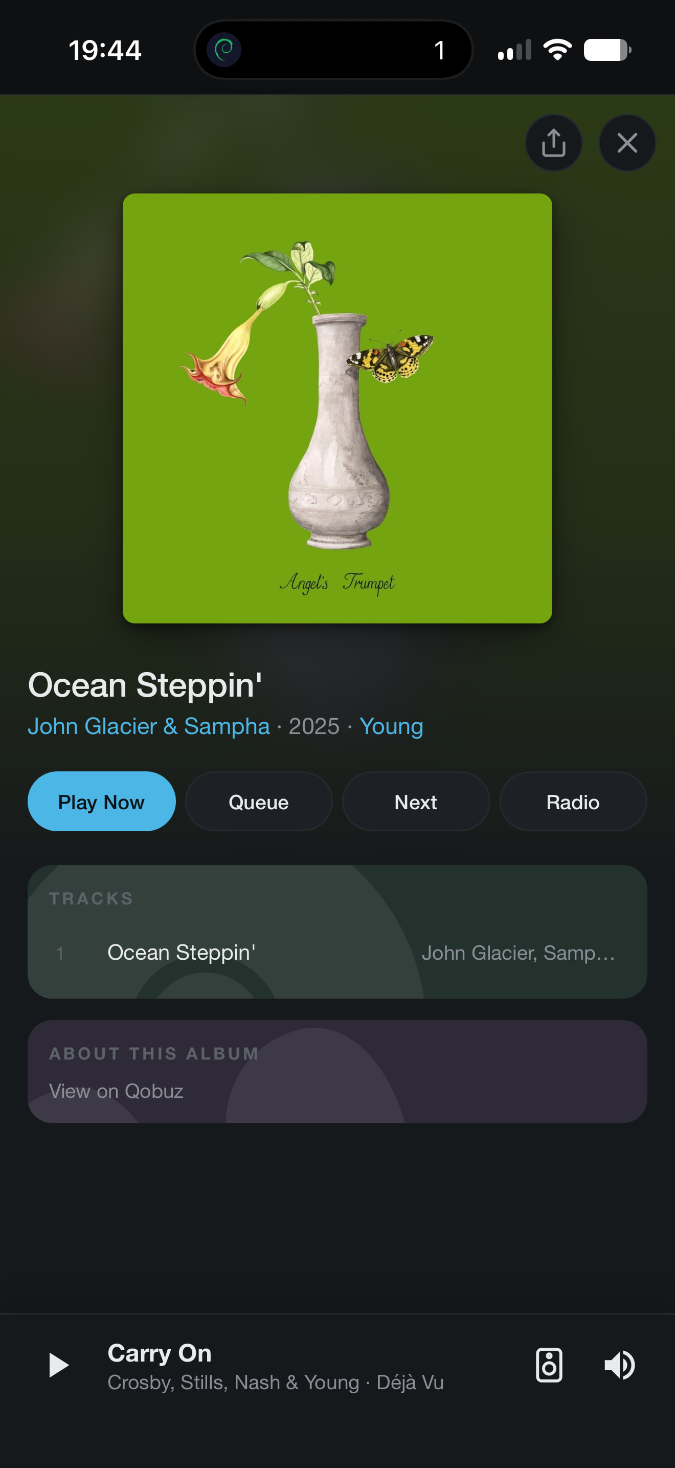

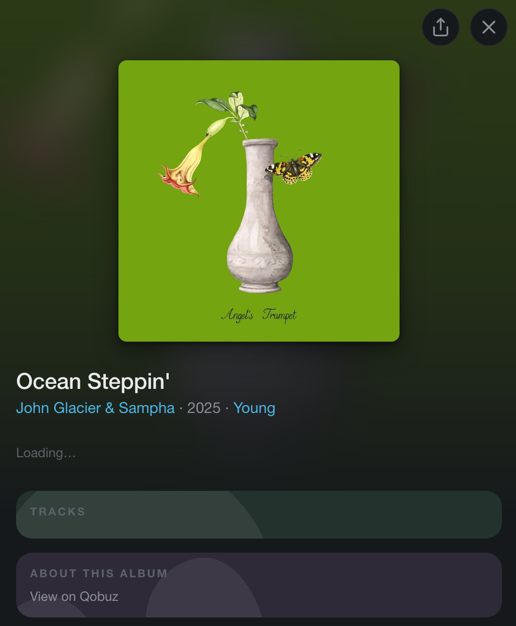

Summary
Description
An album is presented by the extension, but when selected, there are no tracks to play.

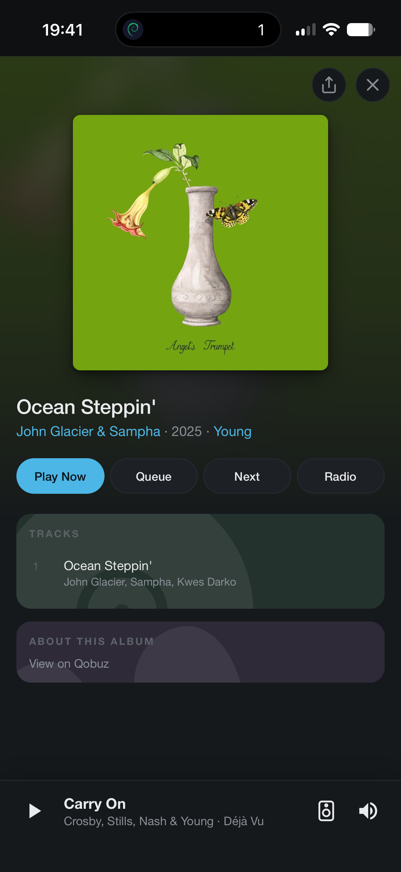

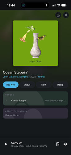

I’m a few dev builds on from the latest version and tested based on that and I see the track being available.
I’ll rollback to test.
v1.6.38
Hmmm… I’ll continue local troubleshooting. Thanks for testing with build 38 and confirming things are working as expected.

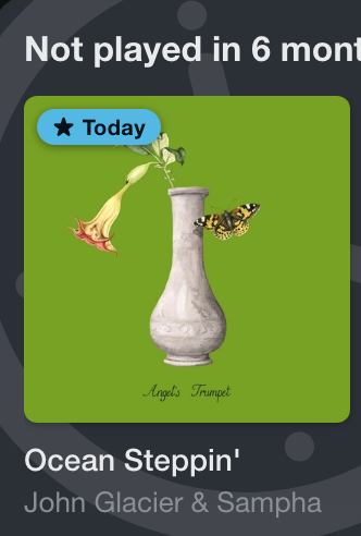

Also to confirm
You may see albums under the ‘not played in 6 months’ that you have played within the last week etc. This is Roon’s API limitation.
After 6 months you’ll see a greater benefit from this section. A ploy to keep you using it :wink:

I fully remove the container and data folder. Deleted Roon and installed the latest EA. Reinstalled my extension and I get the same as you. Another user has reported the same.
Roon API is bust for extensions pulling from Roon. The TV:Remote app on my Apple TV doesn’t work.
Playing an Album in Roon remote will show playing in the extension because Roon API is sending it.
But my extension isn’t getting accessing Roon
Yes, running the latest EA Roon build (2.71 1674).
