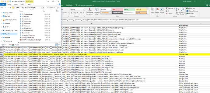

I also thought this might be the case so I exported all tracks to Excel and sorted by file path. See the below screenshot. It seems as though Roon is definitely only seeing track 10 when there are another 9 tracks in the same file location.
