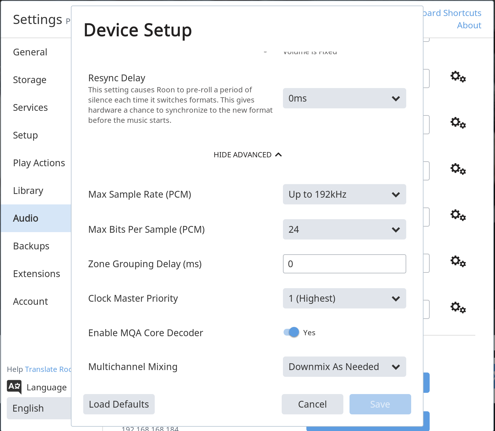

Here are the screenshots you requested… First the device setup:
