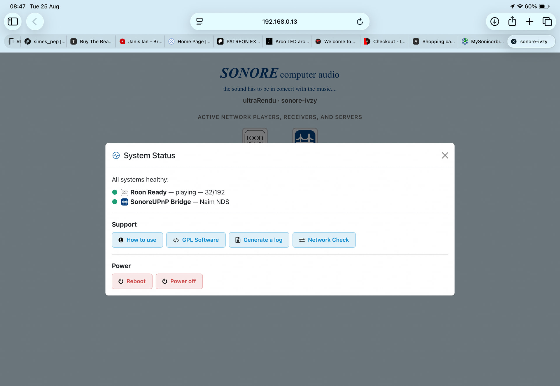

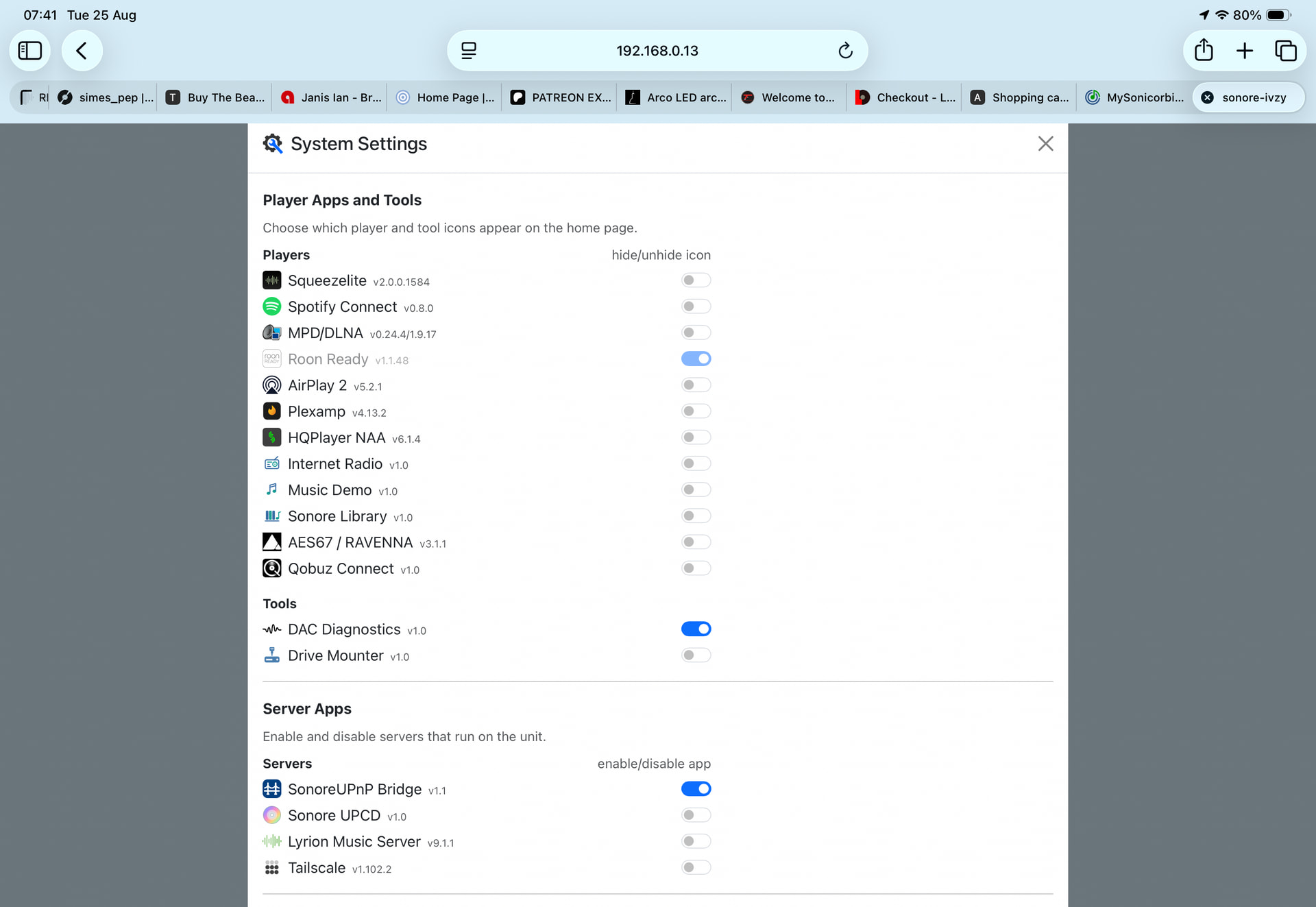

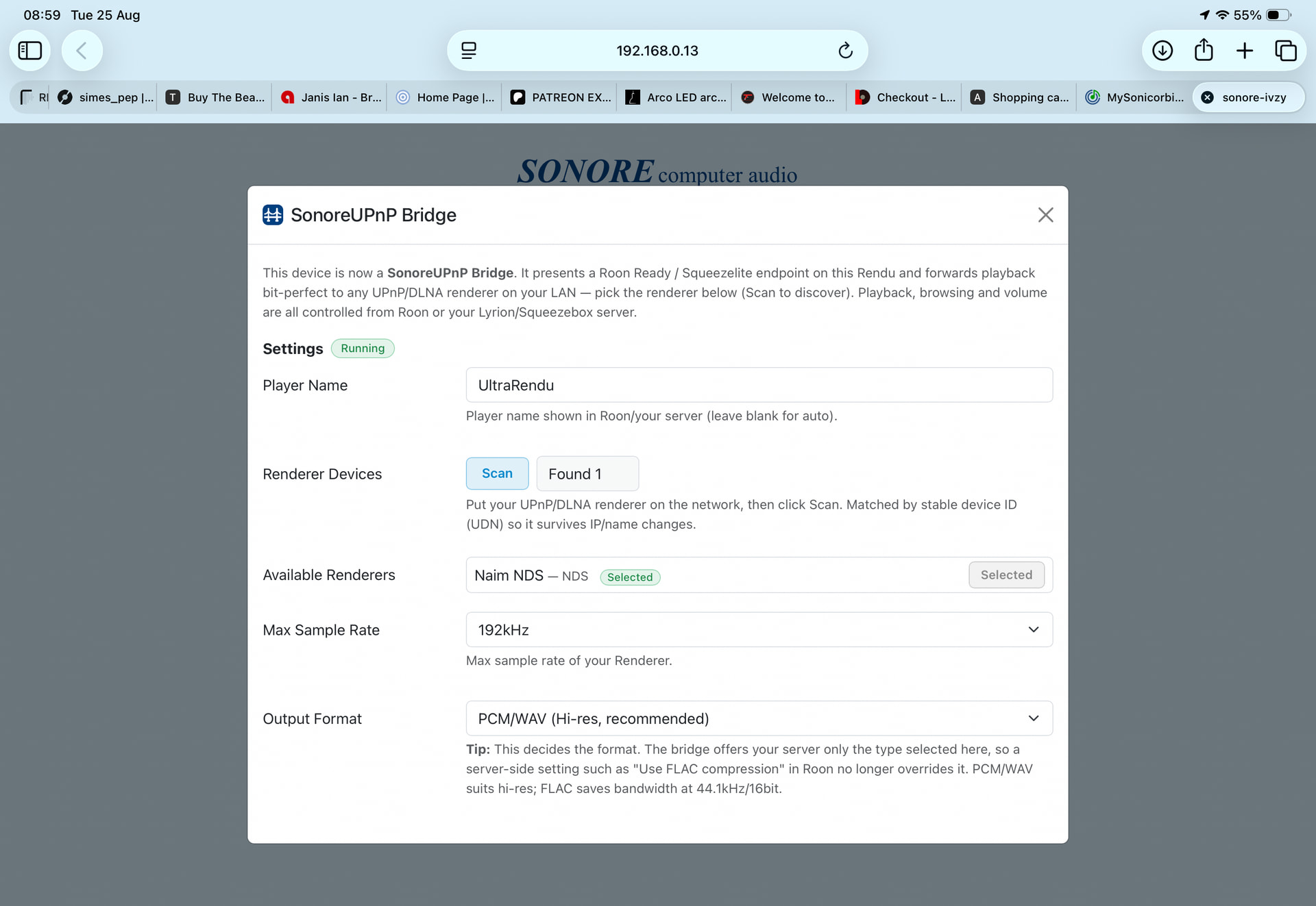

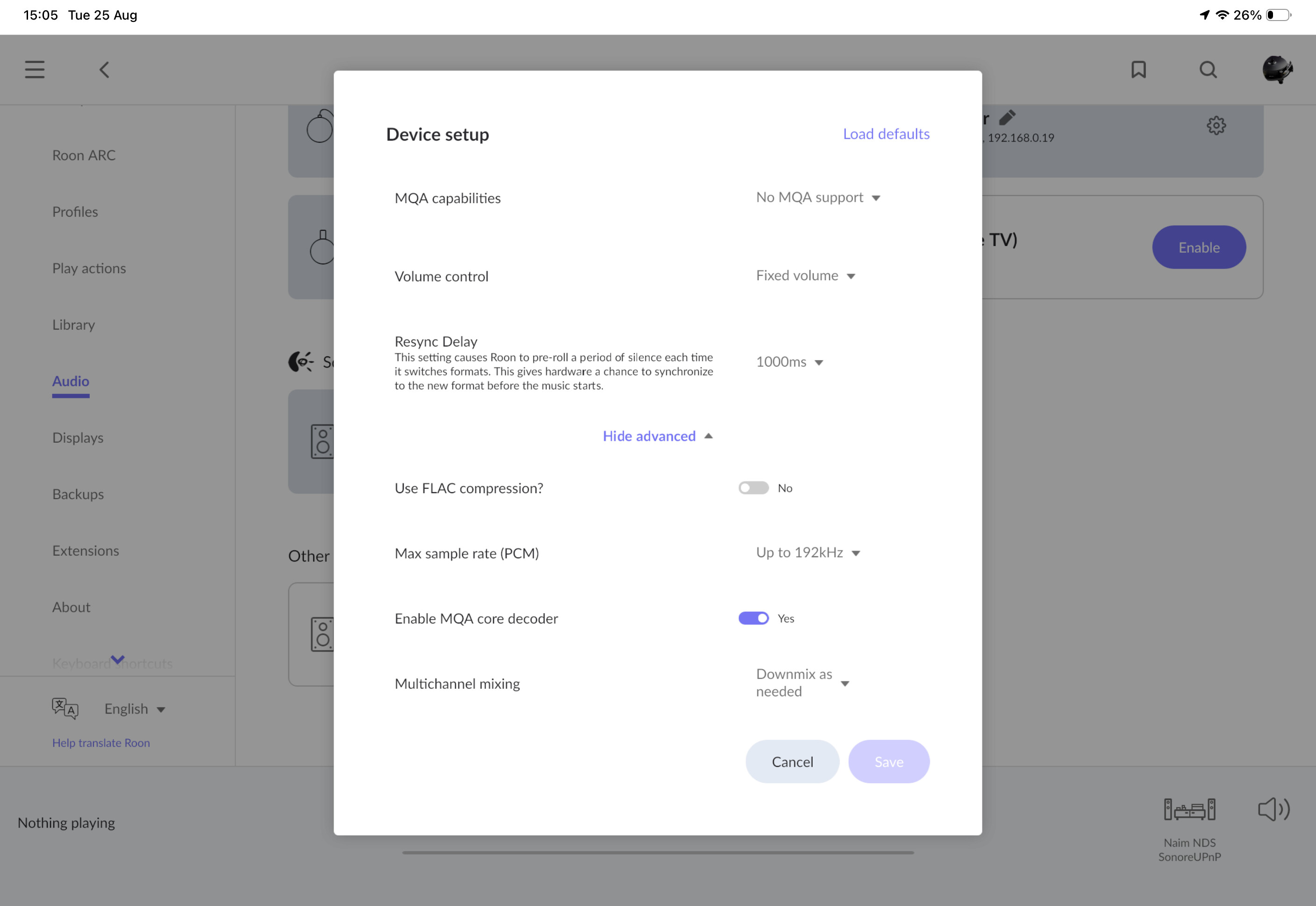

Some revised settings of the revised operating platform.

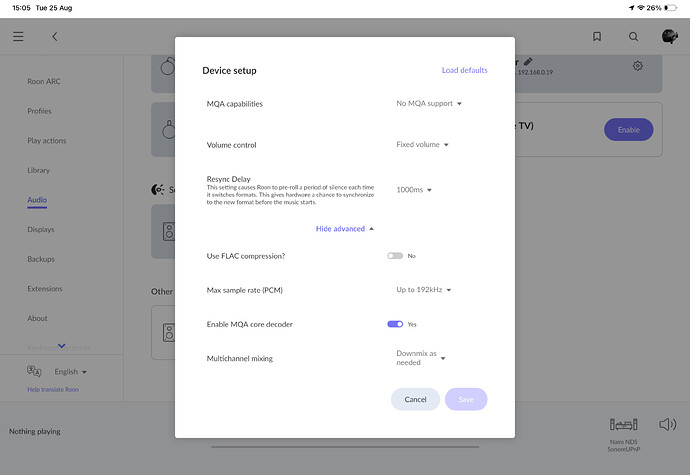

The SonoreUPnP Bridge now needs a Max Sample Rate of 192KHz set, before it is correctly recognised in Roon.

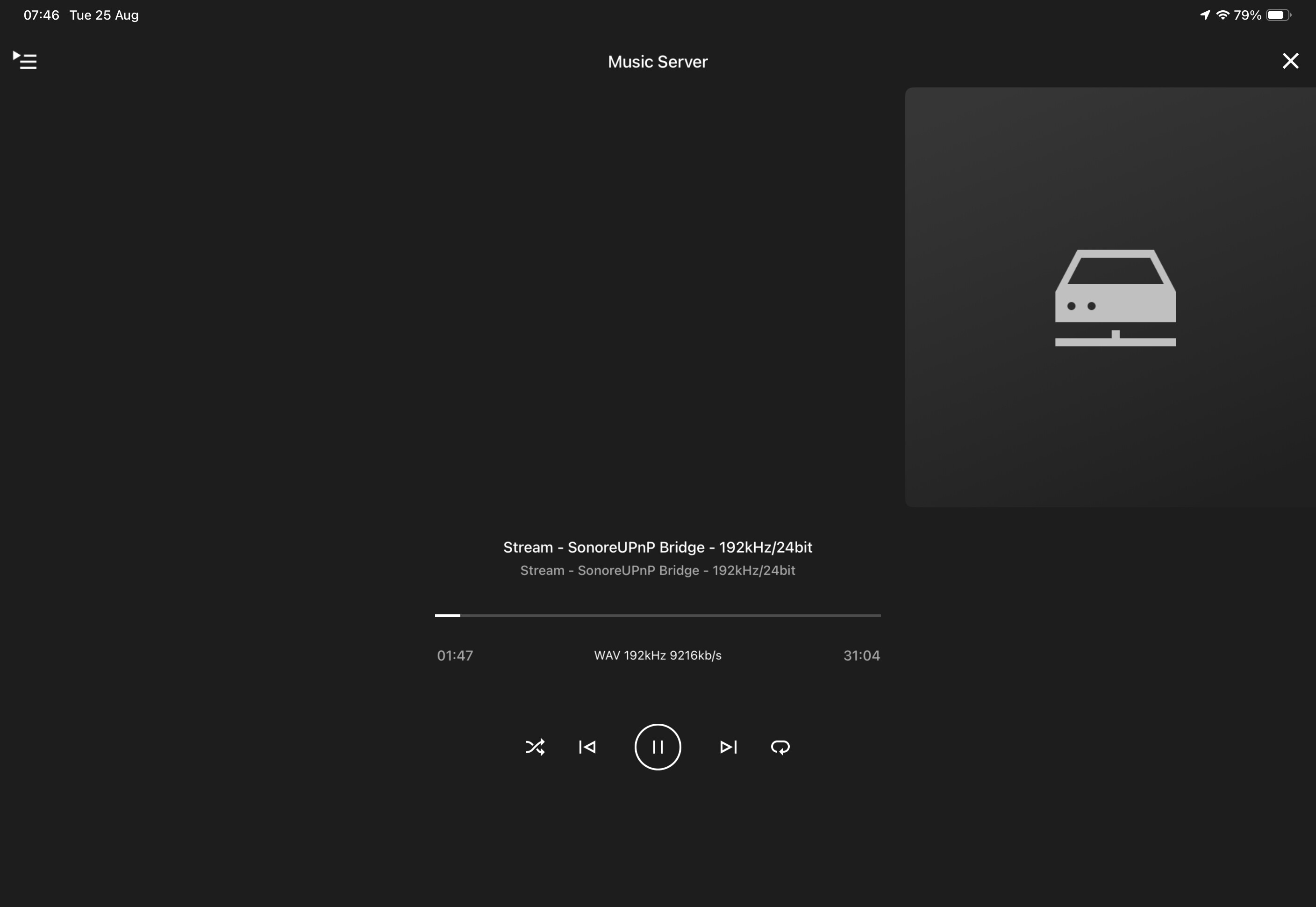

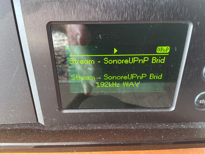

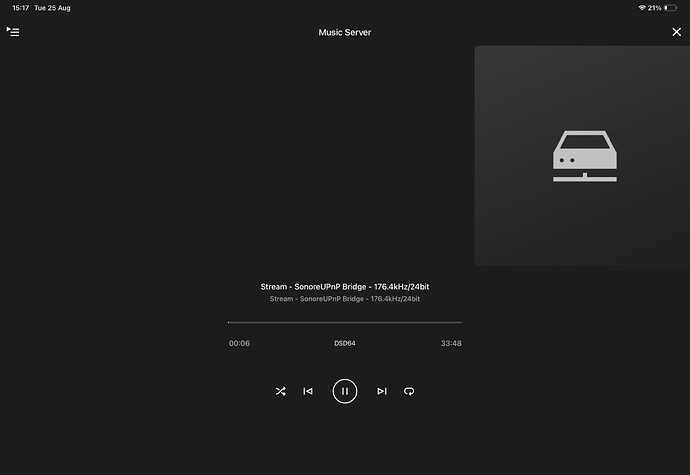

And when there is Playback what is displayed in the Roon app and on the device
SonicOrbiter 3.0 also brings lots of new releases & capabilities, such as:
  • UPCD (ability to plug in a USB CD reader and stream the contents to a UPnP renderer) if you didn’t have a CD transport.
  • Bluetooth dongle support - plug in a dongle and use the device as a Roon zone with Bluetooth devices.
  • Add as a server, running files from its SD card as internal memory
