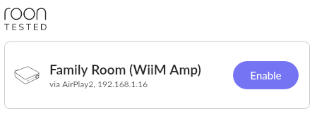

Roon identifies a Sonos Amp (gen2) as a WiiM Amp
All Unifi. UDM Pro + 24 port wired switch and 4 APs. All media devices except for a couple of Sonos speakers are wired. No mesh. No extenders.

Still says WiiM Amp.
Screenshot 2024-12-12 at 1.38.04 PM
Sorry for the delay. I was traveling the last couple of days.

I have rebooted everything multiple times. I have not rebooted my router (Unifi DM Pro) since I know that does not have anything to do with this (been building software, networks, and PCs for 30 years). I definitely do not have any conflicting IPs anywhere.
Regarding the “Specifically the WiiM and Sonos in question.” I mentioned this early in the thread, but I do NOT own a WiiM Amp, so this is all about a current Sonos Amp being confused with a WiiM Amp. The only WiiM hardware I own is a WiiM Pro that is properly identified as Roon Ready. I have confirmed the IP.

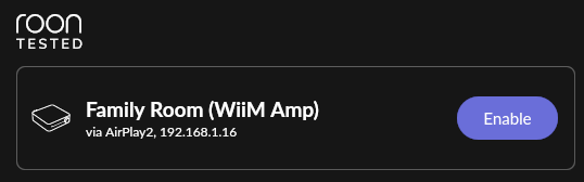

I followed the instructions above, and it is still showing my Family Room Sonos as a WiiM Amp. If it matters, I am not able to play to that endpoint if I were to enable it. I press play, and nothing happens.
Edit: Another piece of info if it matters. My Sonos Amp is wired into my 24 port Unifi switch. It is not WiFi or Sonos Net. All but a couple of my media endpoints are wired.
Any other thoughts?
I went through the process above again today (including reboots), and my Sonos Amp is still being identified as a WiiM Amp un Roon Tested. In “Other network devices”, it does show up as a AMP via Sonos Streaming.
