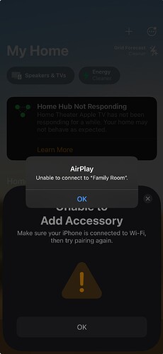

I was able to install Early Access. Here is the error I get when trying to add to Apple Home. There may be some compatibility issues with my Eero router and Apple Home but I followed all the troubleshooting instructions from Apple and it still won’t connect.
After several hours, I finally got Apple Home to add the Sonos Ultra. I think the issue was that right out of the box I used an ethernet connection and never set up wifi. I had to do a factory reset but it is now added to Apple Home.
