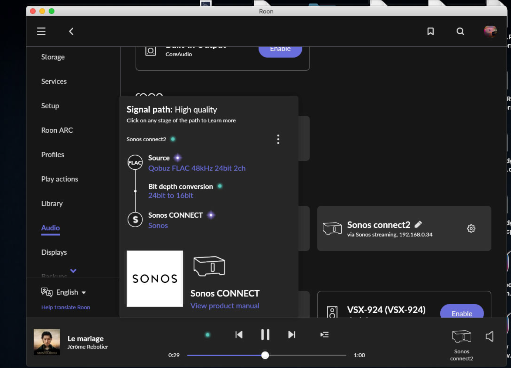

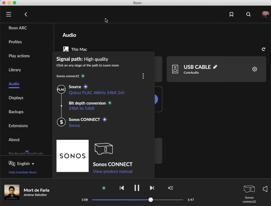

My sonos connect gen 2 not playing 24/48 natively like it was yesterday now everything he plays 16/48 can you fix software as it was before update

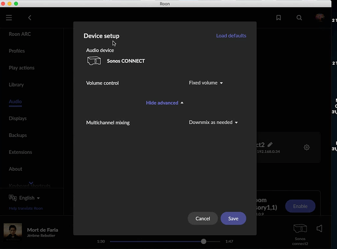

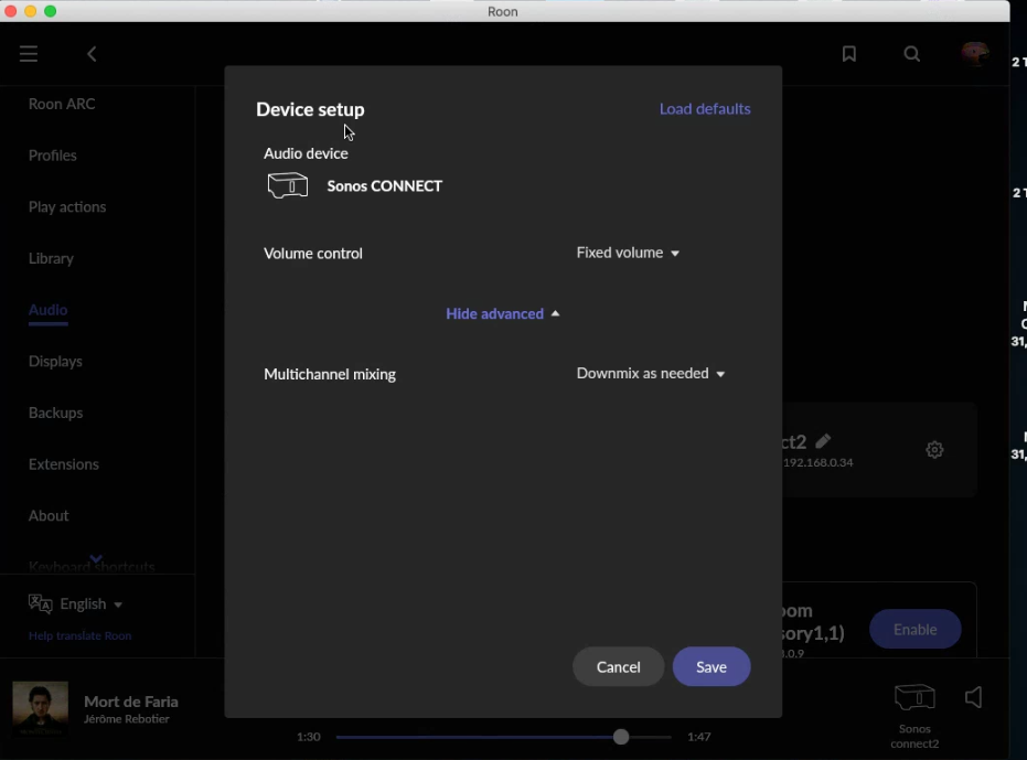

hello its missing option now on keep native 24.48 after update please can you fix this

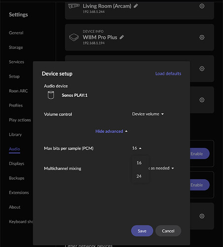

All my Sonos devices still have 24 bits and 16 bit options under Advanced Settings
Yes it was fine yesterday today is just 16 bit

This can sometimes happen and I have checked all mine and the 24 bit options are still there.
Can you send a screenshot of the Advanced audio settings? Like this

there you go yes it is sonos 1 device

hello so i have power cycle both devices and unfortunately still the same issue no advance options in sonos connect format selection disapeared please help !!!
