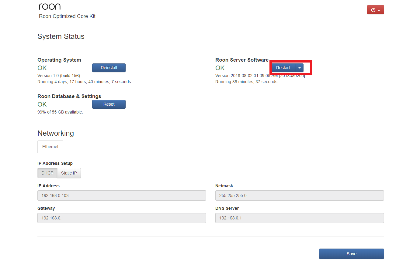

Thanks for reaching out with your query. I activated diagnostics mode for your account and what this does is upload a set of logs to our servers. Looking over your logs, it looks like your ROCK wasn’t able to get an IPv4 address at the start of the log until later on in the day. Looking over the Sonos error, I can see a No route to host error. Can you please try to perform a restart of RoonServer on your ROCK via the Web UI and let us know if this corrects the issue?
