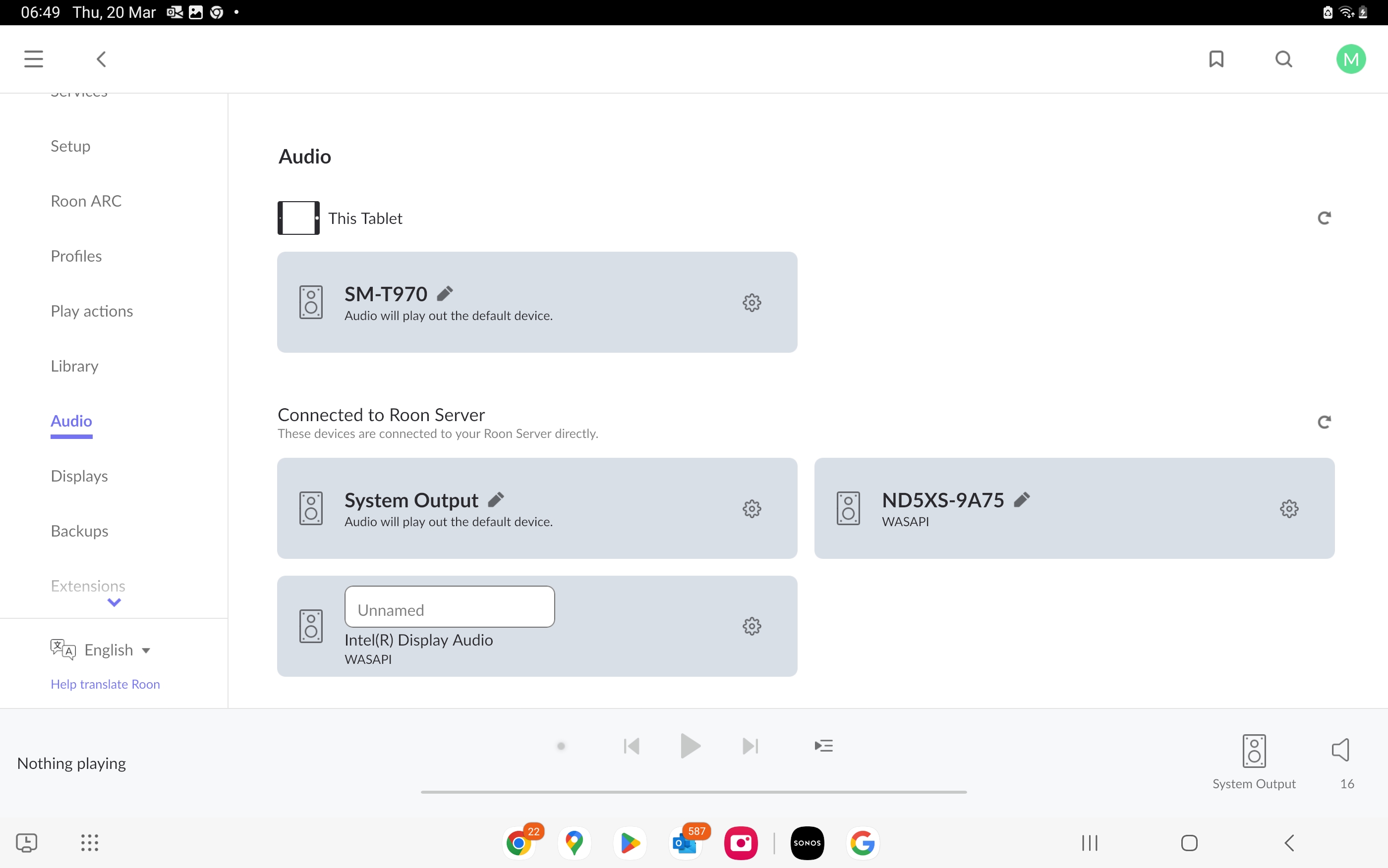

I can't see Sonos speakers in the Roon app. They were there yesterday but have suddenly disappeared.

Can you see your Sonos speakers in the Roon app? That would imply the issue is in my Roon app.
I’ve tried uninstalling and reinstalling the Roon app and am still getting the same problem. Sonis speakers are not available.

I fixed it now by turning the server app off and on again.
This is the 2nd time I’ve had to do this. I checked and both Roon and RAATServer are allowed through the firewall. So there seems to be some instability somewhere in my setup. However, at least I know how to fix that problem if it happens again.
