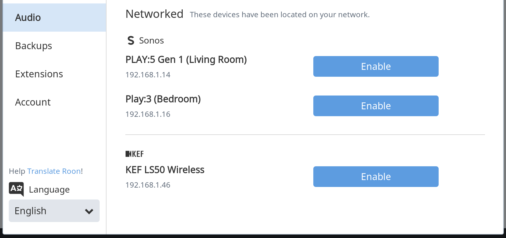

OK on my laptop everything is available as expected under networked.
