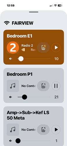

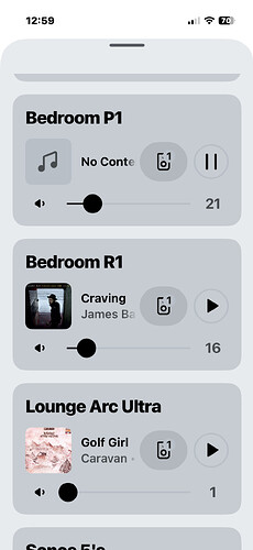

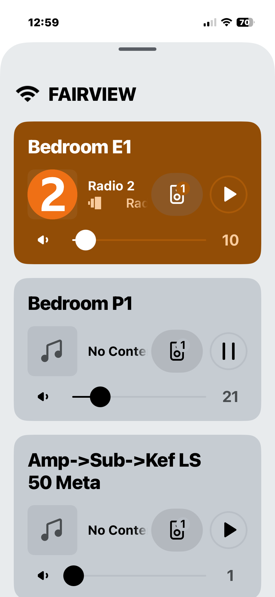

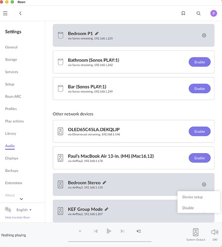

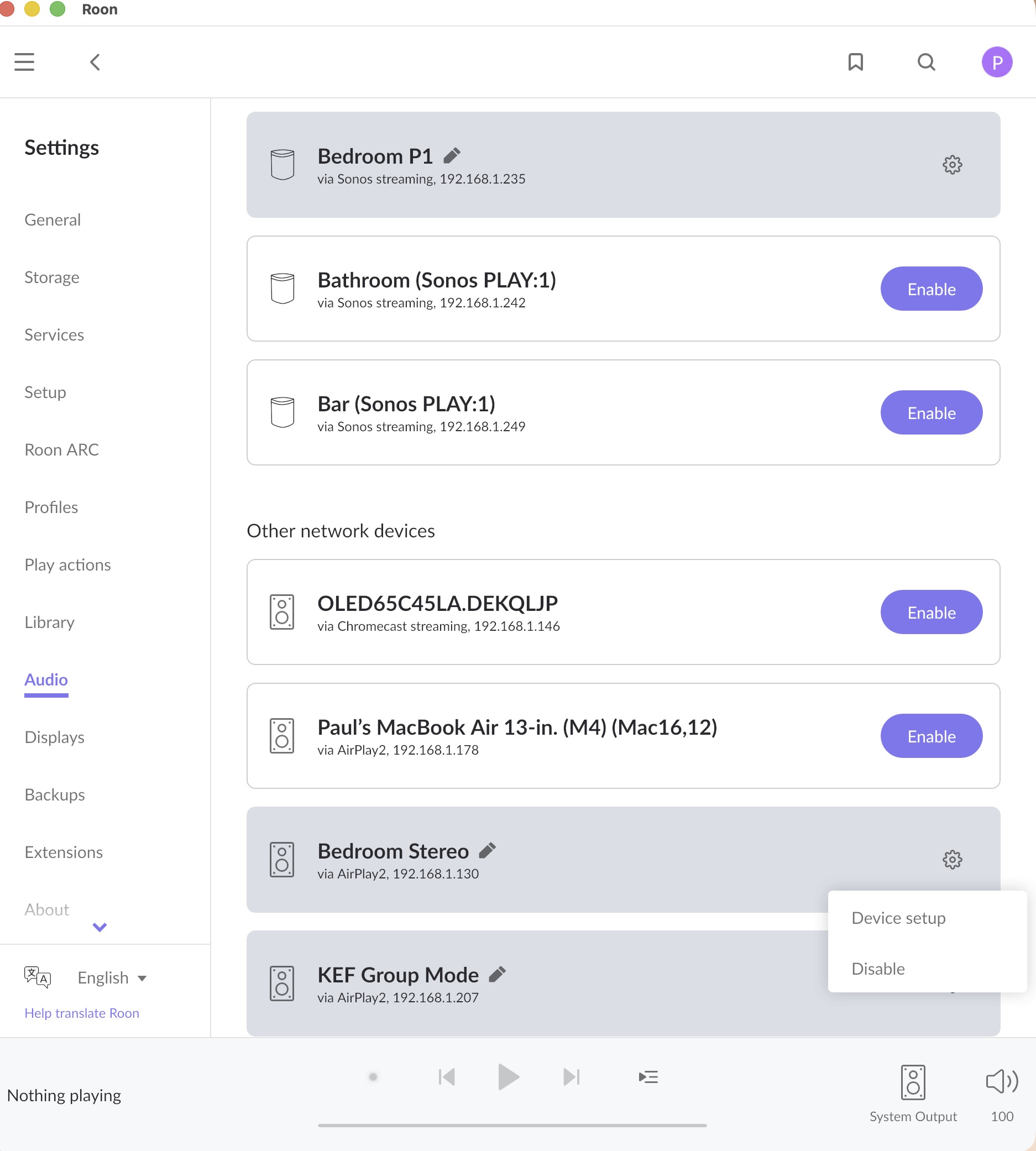

Attached screenshots showing:
  • Sonos Streaming vs AirPlay2 endpoint discovery
  • Stereo pair behaviour in Sonos
  • Roon zone separation during playback tests

The point about the Era 100 is particularly interesting, as throughout my testing the Era 100 only appeared in Roon as an AirPlay2 endpoint, while the Play:1 appeared as a Sonos Streaming endpoint.
I was able to create a Sonos group consisting of the Play:1 and Era 100 within the Sonos app, but when playback was initiated from certain Roon endpoints, the grouping was separated again on track changes.
Based on my testing I’ve currently settled on using the Play:1 as the Roon endpoint and then grouping the Era 100 from within the Sonos app when required. It’s a workable solution, but it does leave me wondering whether there is something that could be improved either on the Sonos side or the Roon side.

The Era100 should definitely offer itself as a Sonos Streaming endpoint, but as I noted it does need to be discoverable via UPnP. Since you already have a number of other Sonos rooms successfully enabled for Sonos Streaming it doesn’t sound as though there’s a system-wide issue. I take it you’re running the most up to date Sonos firmware. Is there anything peculiar about your network topology which could be affecting UPnP discovery broadcasts to that Era100?
As for grouping Sonos Streaming and AirPlay2 endpoints in Roon I suspect that the differences between the two streaming protocols, buffering strategies, format support and so forth make such an idea a non-starter.
