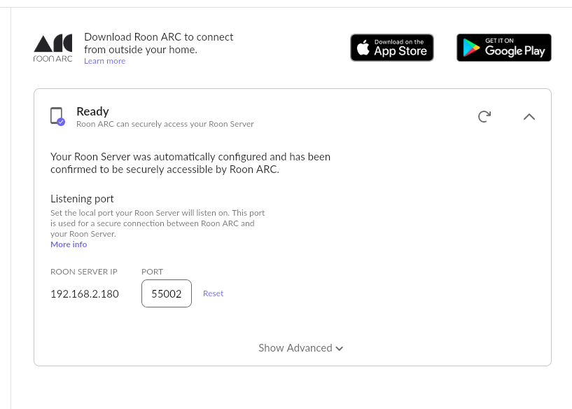

If you’re using ARC outside your network and can’t connect can you share a screenshot of your Roon settings → ARC page and any error messages that show up?

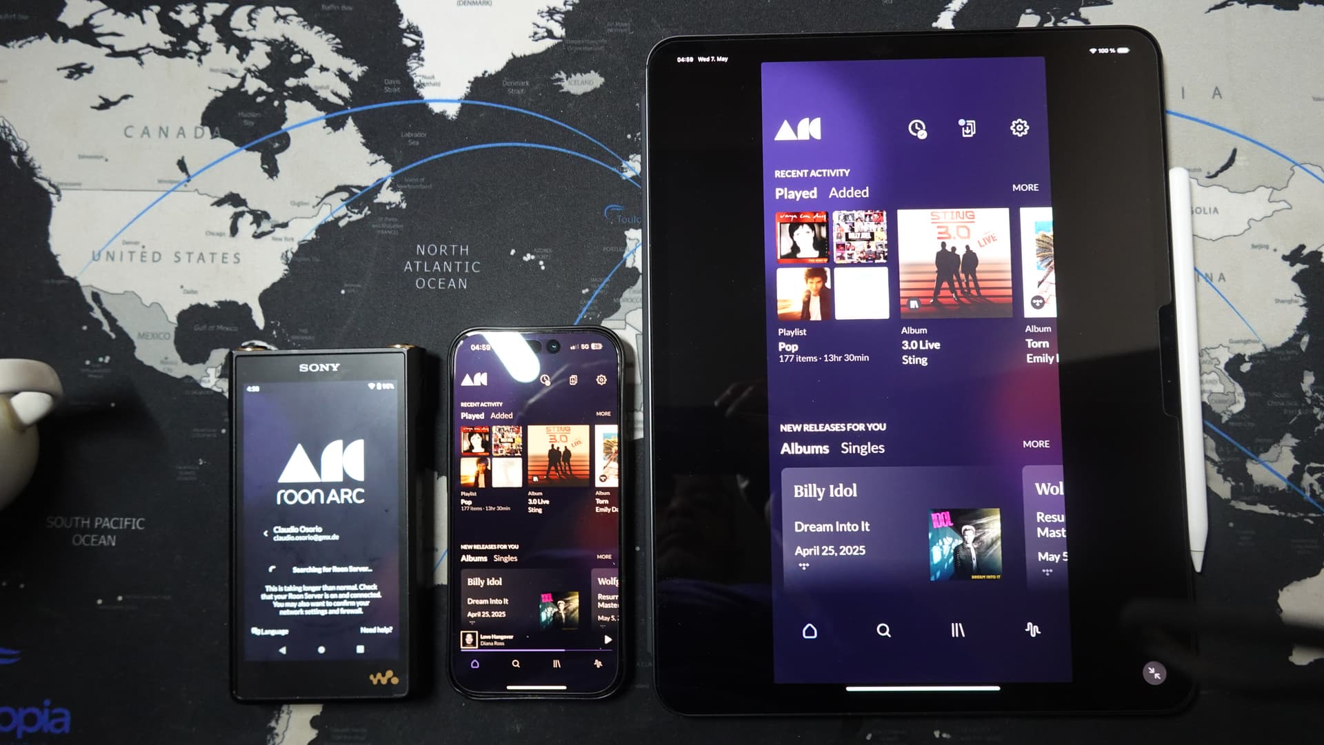

I send you a plot-screen from the Roon ARC screen, and the iPhone, iPad connected and the Sony DAP “looking” for the server.
I am in my local network (iPad & Sony) and the handy throught 5G.

Hi Daniel, Thanks, yes, I try. actually the picture is the new installation after the request and still the same.
What is crazy, that ARC worked no so fine but it worked, it connect to the server. I uninstalled it (while offline the app) and since then…
the DAP has connection because it connects and recognized my license, but can not find these server. ARC works because iPhone and iPad connects, as you can see in the picture, iPhone and iPad connected (iPhone via 5G-cell and iPad via wi-fi at my friends place) no home.
the picture of the ARC screen in Roon is when I return the same dy to my place
