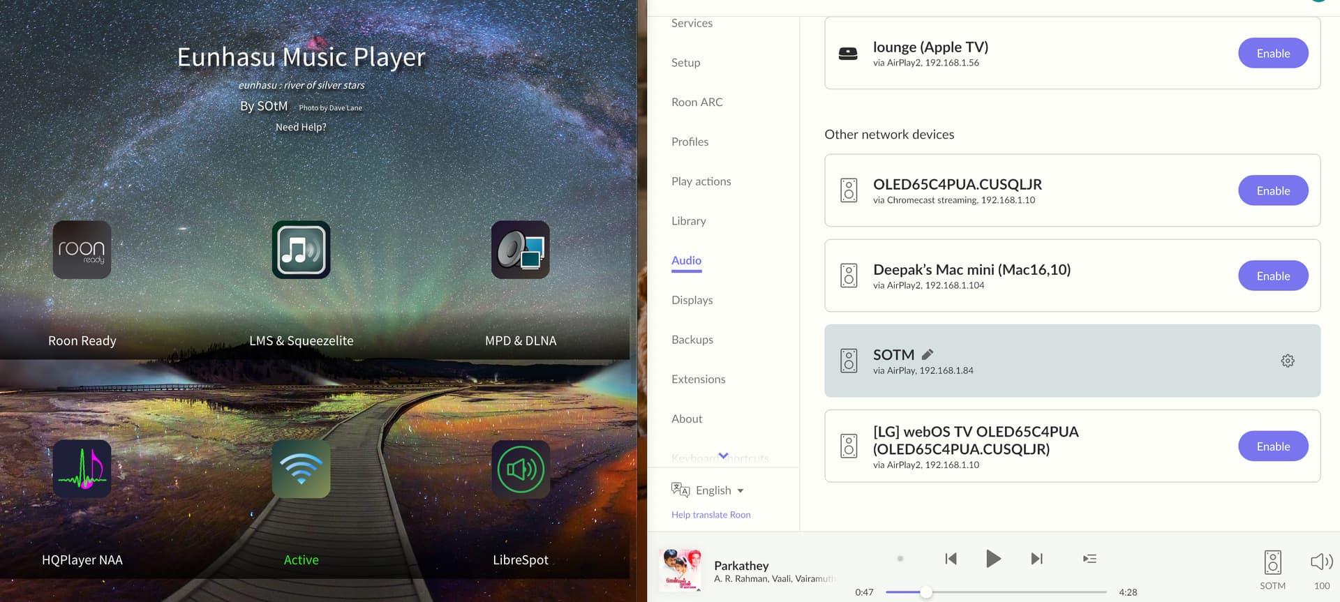

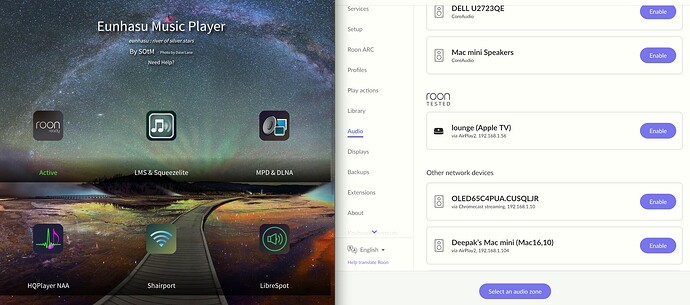

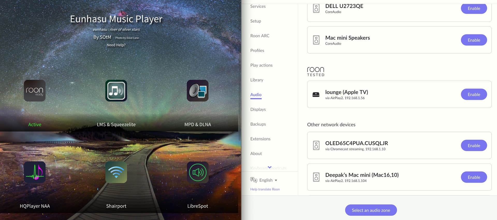

Thank you for your reply! I did try what you told me and still do not see the SOTM as roon endpoint. You can see ROON Active, but not showing on the right.
I will now turn on sharepoint and you can SOTM listed as an Airplay device

btw: the SoTM should be displayed in the Roon ready section…your picture shows Roon tested…

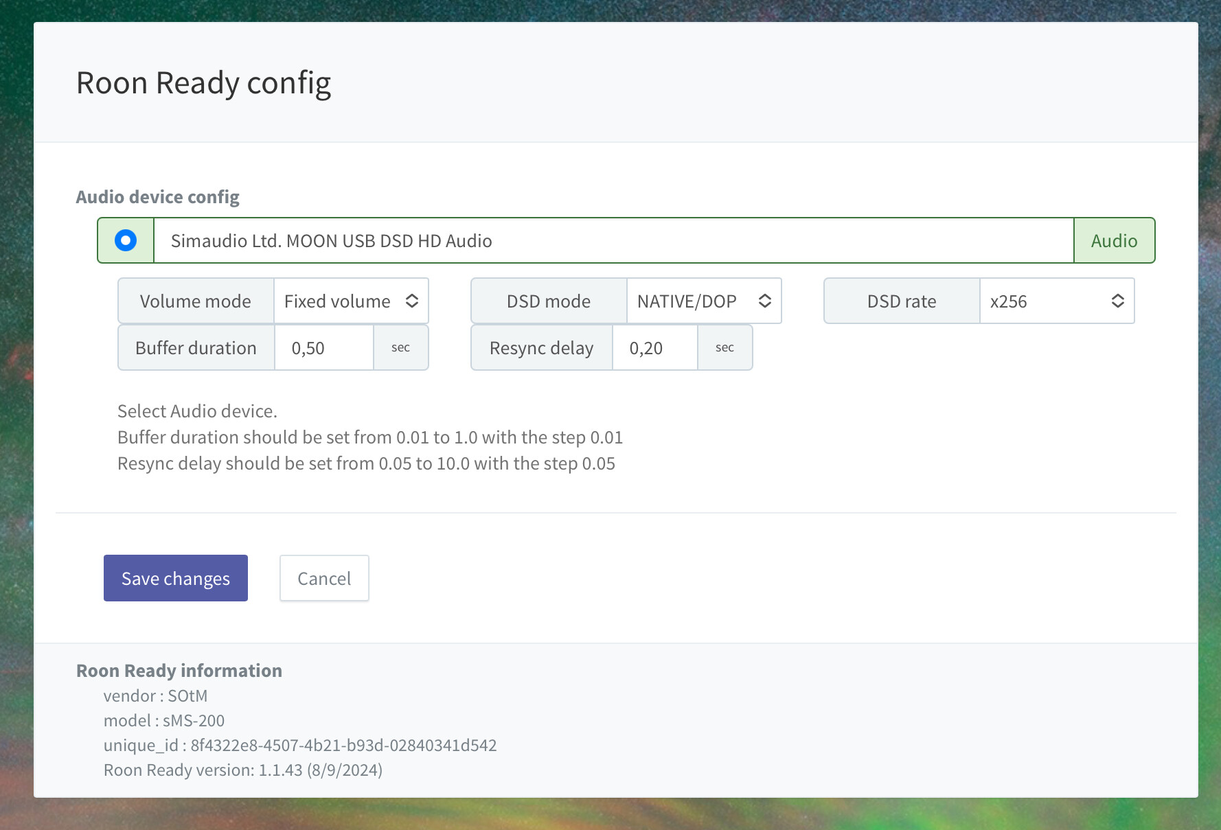

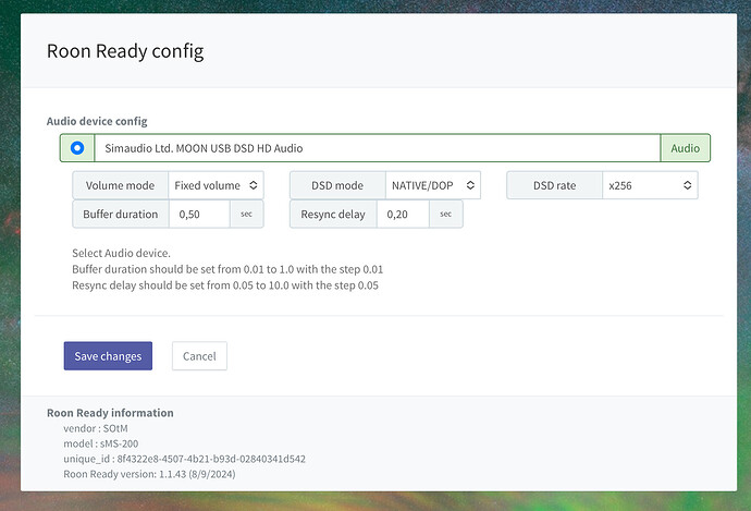

In the first setting, please show a screenshot of the Settings under Roon Ready in Eunhasu.
Like this:
Since one of the last firmware updates my Neo will also sometimes not shown as Roon Ready device.
Obviously in the setup Roon is marked as active, I’ve then to reload (or disable + enable) the Roon setting an then it appears as Roon Ready device in Roon again.

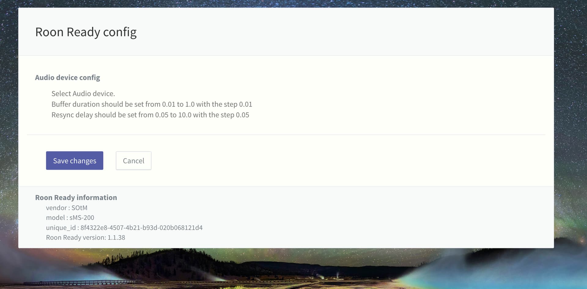

I do not even see the option you are showing Mikael. All I see is this on the Roon Ready Config

@Deepak_Manoharan your firmware seems to be on V 1.1.38. @Mikael_Ollars firmware is V 1.1.43. Have you, or can you, update your firmware and see if this helps resolve your issue?

Unlike @Burkhardt_Petermann my two SOtMs are 100% stable and sounding the best they ever have with the latest firmwares and some tweaking.
