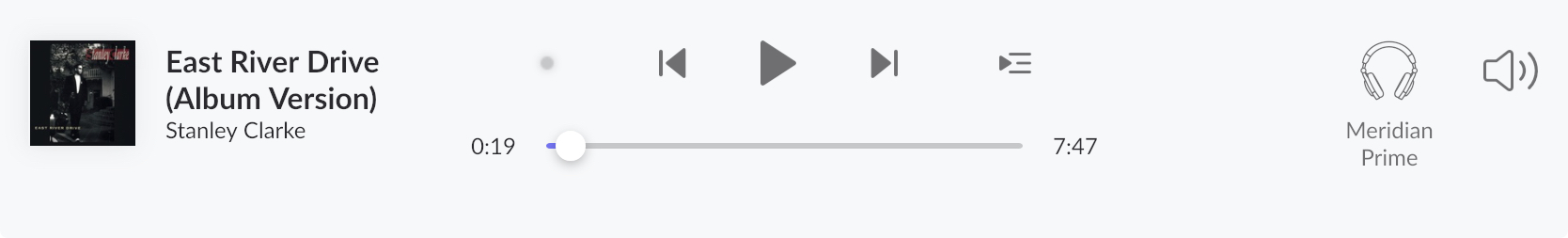

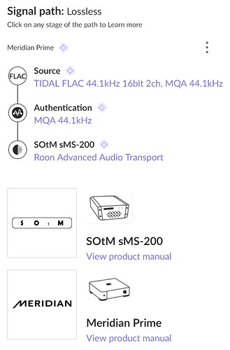

This old screenshot illustrates what the connection should be…

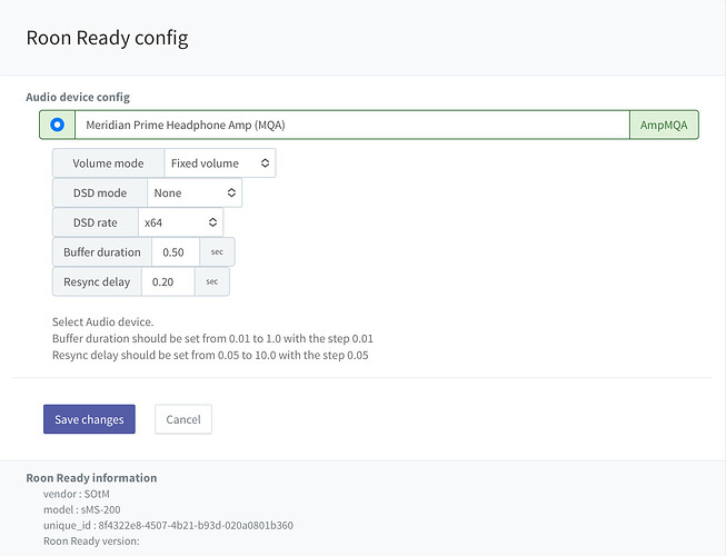

Please post the Roon Ready Settings, thanks!
Such as this:

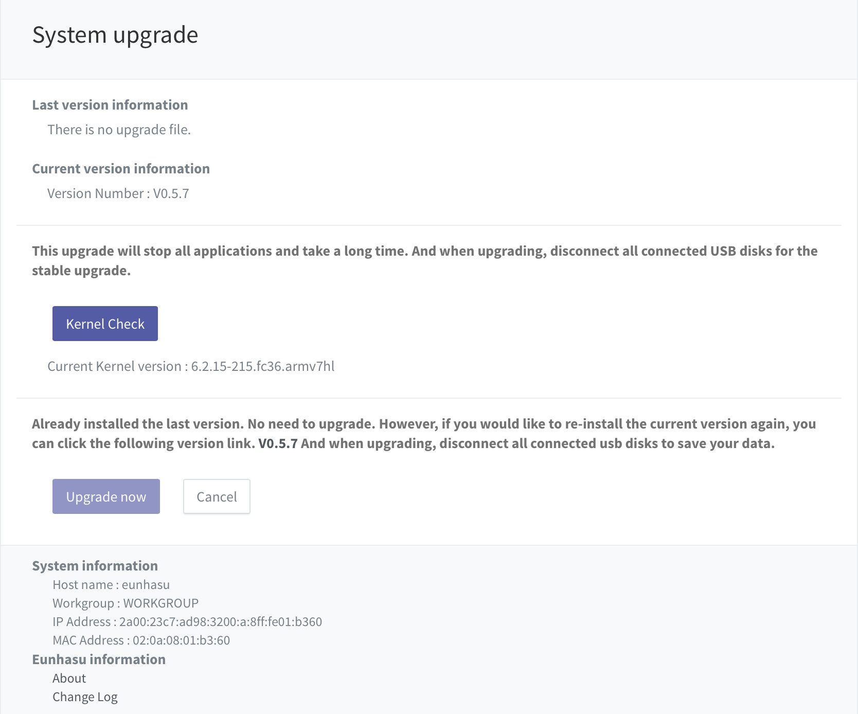

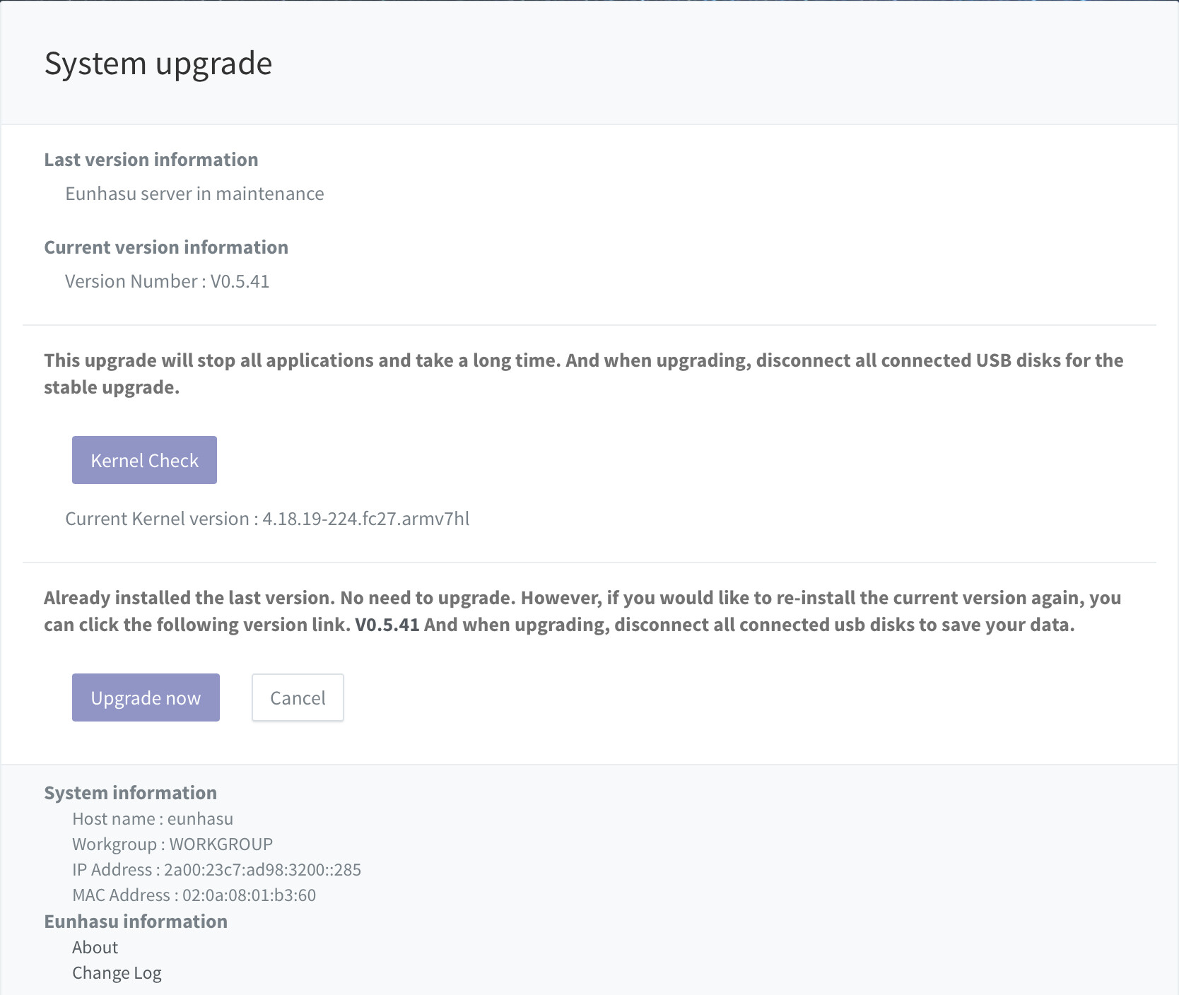

The SOtM Server is currently in maintenance mode, so I cannot update my kernel to the latest 6.2.15-215 version (which, I suspect, is the problem)…
Oh, i suggest to image the latest version (5.7) onto a low level formatted microSD, see the first post in the linked thread!
You will be pleasantly surprised!
And, there seem to be some issue with your internet access, the SOtM servers are available to me. And your firmware seem to be from last summer.

yes, the firmware & the kernel version numbers are the old one, please update both to the latest version and test it out. You can follow the instruction here, en:eunhasu:burn_sdcard_image [SOtM docs]

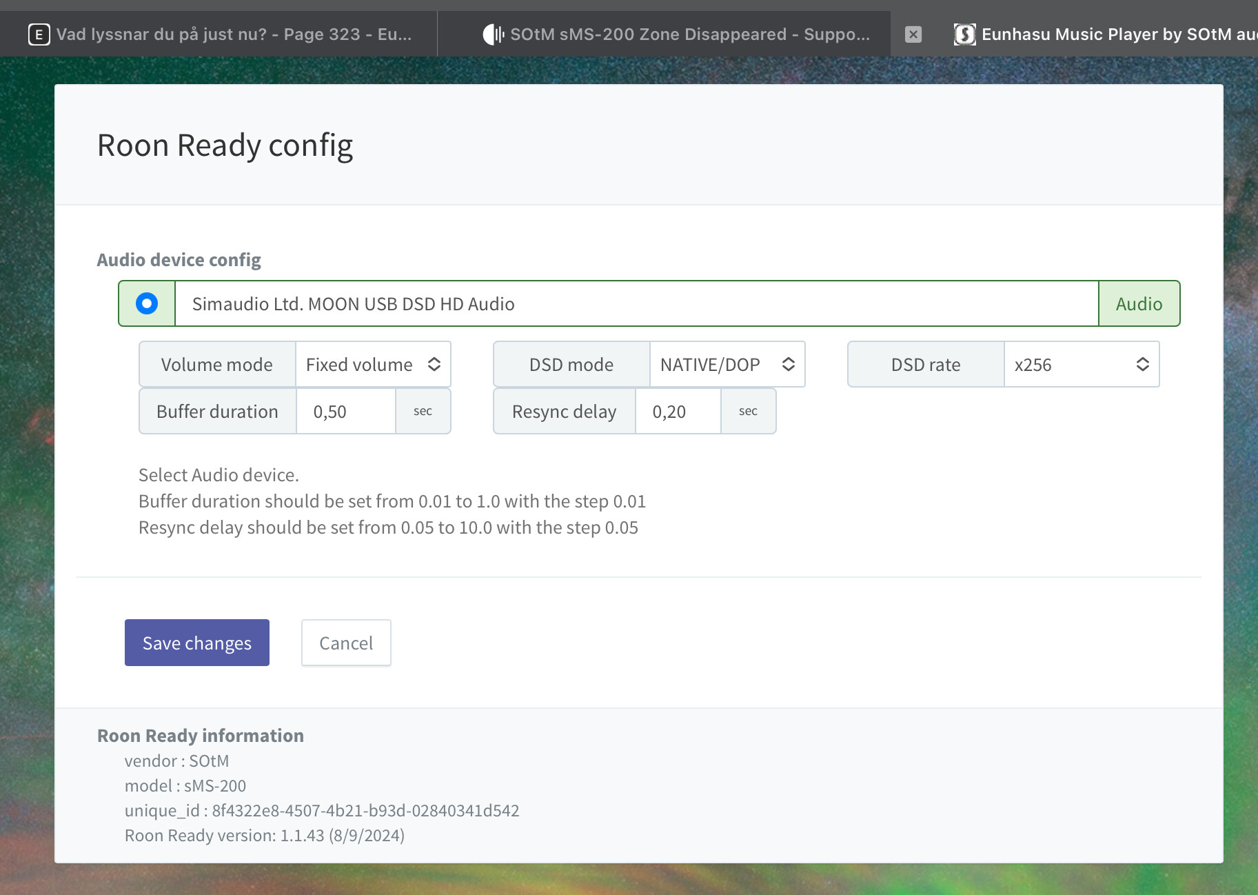

I have two sMS-200 and they work just fine with fw 5.7 and these: Simaudio Moon 280D, Simaudio Moon 430HAD (DAC3), Denafrips Ares II, Audiobyte Black Dragon, Topping E50, Chord Hugo 2, Chord Mojo.

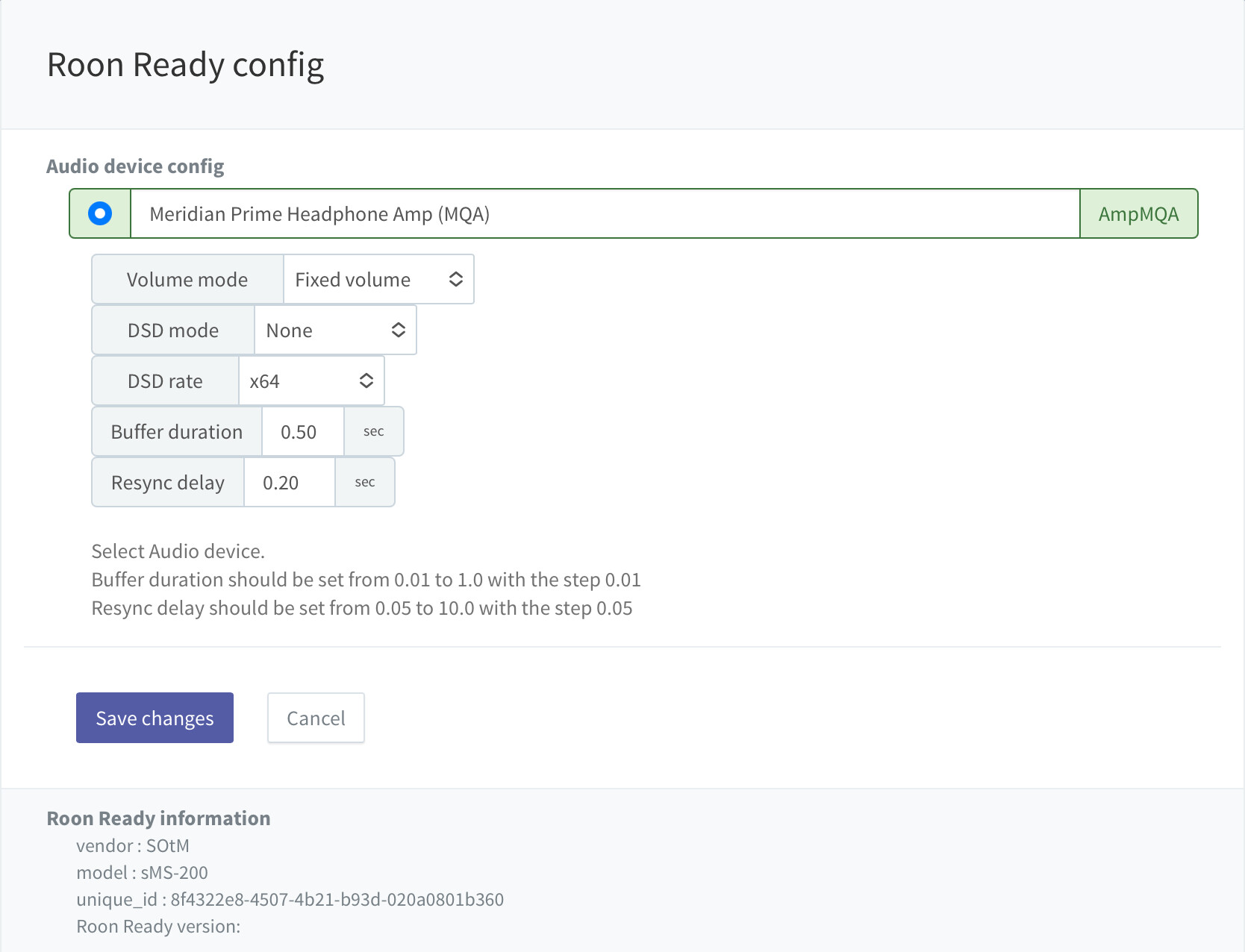

Only after going to the setting site and reload here the Roon setting (which was always shown as active), it appears as endpoint.
Solution for me was: Save the Roon settings again with the used DAC connected.
Touch Wood; I do believe that I’ve resolved the issue.
In the Eunhasu menu; changing the buffer duration and resync delay on the Roon configuration - and on switching-off DSD Mode - resulted in my Meridian Prime being instantly visible as a Roon Zone.
After the firmware update, I needed to go to ROON → SETTINGS → AUDIO to enable/activate the SMS-200 again or it wouldn’t be selectable as a device. If nothing works, try that. The device should be showing there under ROON READY.
