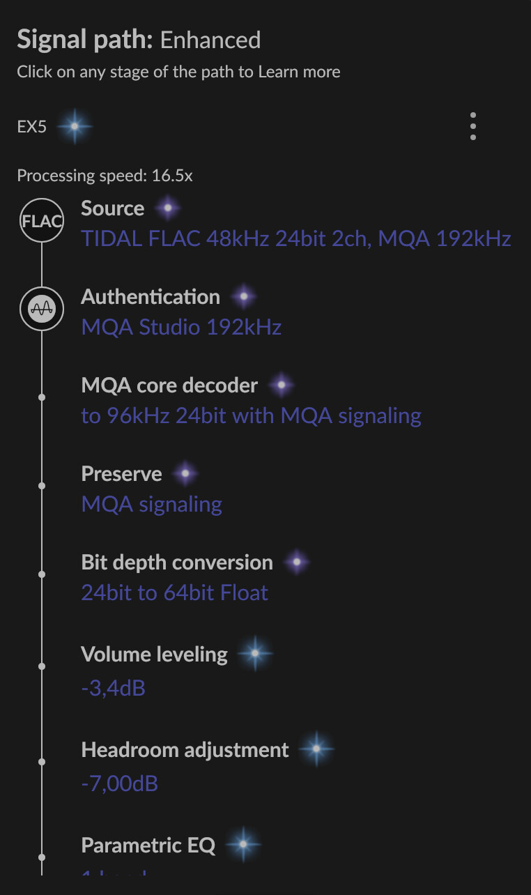

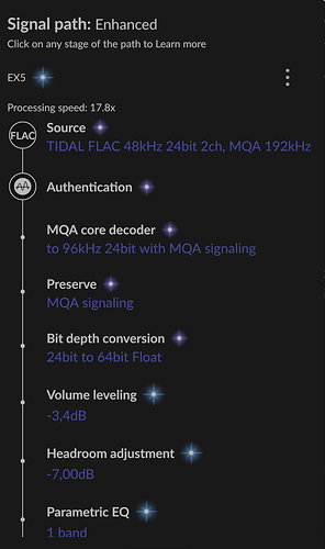

Later I discovered (due to my DAC Topping EX5 displaying the current bitrate) that for a gapless MQA192 file, when switching between tracks, 192 disappears for a fraction of a second, 96 bitrate appears, and immediately returns to 192.
In the signal path in the Authentication position, the signal parameters disappear, which I managed to capture in the attached screenshots.
I also turned off all elements interfering with the signal path - headroom, up-sampling, EQ, etc… Adverse effects disappear.

  1. when playing “gapless” MQA albums with a bitrate higher than 96k, e.g. MQA196, in the transitions between tracks there is a short break in MQA authentication and the bitrate changes to 96k, which causes crackling in the played sound.
  2. This phenomenon only occurs when there are DSP corrections in the signal path.
  3. With DSP corrections turned on, the phenomenon disappears when after the MQA Restore step we insert the DSP volume control.
