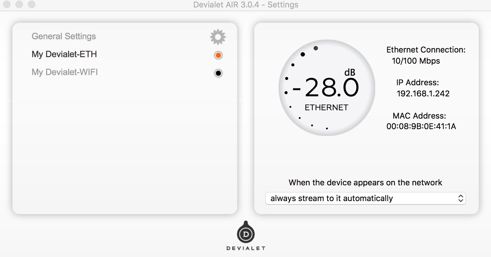

Can you please verify for what the experience is like when you change “always stream to it automatically” (under “when the device appears on the network”) in the DEVIALET AIR SETTINGS window to “never stream to it automatically” as mentioned in our knowledge base here.
So far so good … I have changed that setting …and have been listening now for nearly an hour without any issues. Sorry - I hadn’t looked in detail at the Devialet pages !
