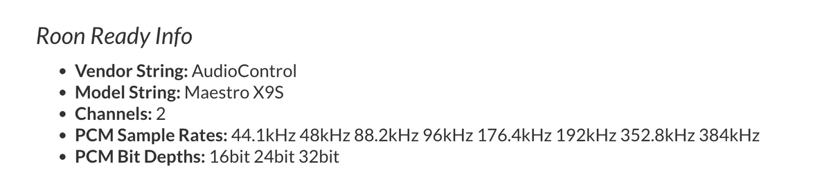

Technically direct connection should not result in different sounding, but please see below a photo with specs of RAAT (Roon’s protocol) for this device and consider limitations:
For example if you are going to play more than 2 channels then direct connection would make sense because RAAT is limited to 2 channels and so on.
