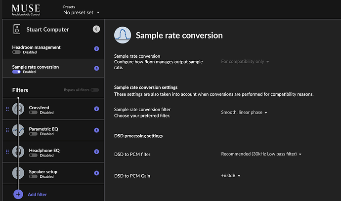

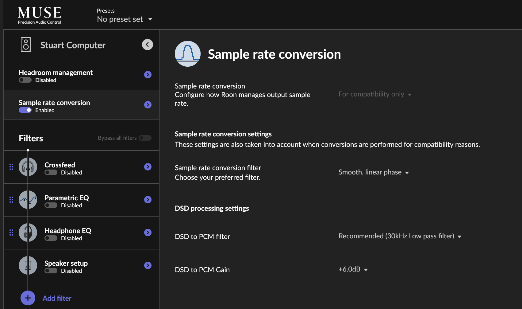

Fix — enable DSP Sample Rate Conversion in Roon:
  1. Muse
  2. Enable Sample Rate Conversion
  3. You can play around this setting like “For compatibility only” or “Custom.”
This will resample all 44.1 kHz content before it reaches the device, and you should be able to play without exclusive mode.
Hi @vadim thank you! I agree this seems like the cause. I did as you said (i cannot enable custom though, its stuck on for compatibility only which is suspicious to me) but it still fails.
I was on 24bit / 192. I changed to 16/48khz because I figured that would be better supported but the same result.
