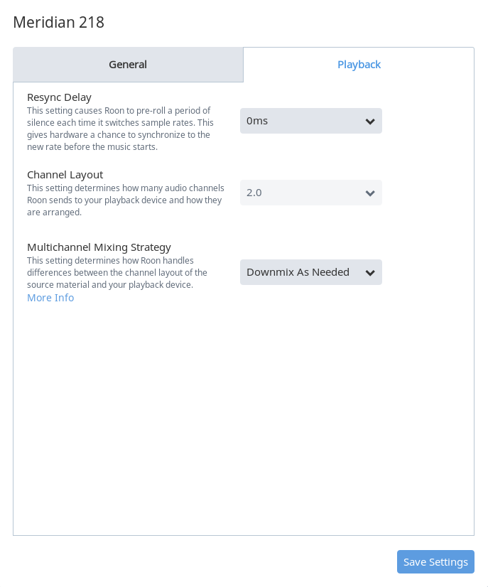

Thanks for assisting me with this. I have attached five screenshots that should show you all the details of how my system is set up. If I’ve missed anything please let me know: I’ve only been using Roon for a week with this new Meridian equipment.
The TS-251 is dealing with a library of 19,891 tracks and I have no other audio zones in my system. The 218/AC200/DSP7200.2 is all there is.
The network topology is as follows. The TS-251 is connected to a Netgear Prosafe GS105 switch. This connects via ethernet to the Meridian 218. The Meridian speakerlink then passes to the AC200 and from there to the DSP7200.2s. The Roon Remote is on a Windows 10 laptop and connects to the core via Wi-Fi.

Just an idea (with no deepest technical background, just try & error)…did you try to adjust the “Resync Delay” to 1 or 2 seconds?
Hi Oliver
I’ll try that tonight when I get home from work. Thanks for the idea.
Alan
I’ve tried the resync delay. It made no difference. I’m still getting the splat. I’ve also noticed that if I pause a track and then restart it, I get the splat then too.
