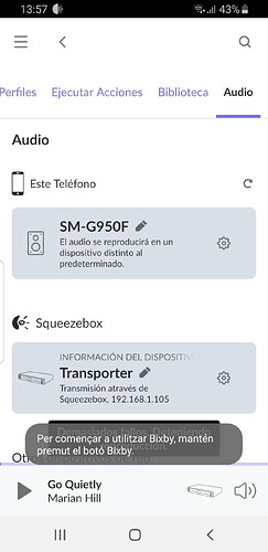

· The System Output has *no problem*, it's only my other Zone.
· Network - WiFi
· Squeezebox
· Yes, it shows up there, but it isn't Enabled
Does the "Enable" button unlock the Zone?
· I pressed Enable, but the Zone remains disabled
· As previous said: 13:30 local time, local stored track "Differently" from Marian Hill

are you using Bixby to control roon, or the Transporter?
is there an LMS instance running somewhere on your network?
Hello
Bixby appears on the screenshot by mistake. Me, touching everything on the screen for making the capture:)
It is not even configured

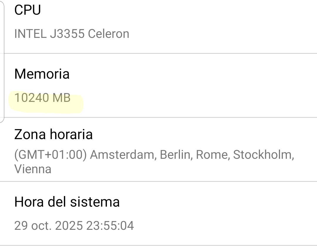

I expect new RAM to arrive this Wednesday so there will be 2Gb + 8Gb on the free slot available.

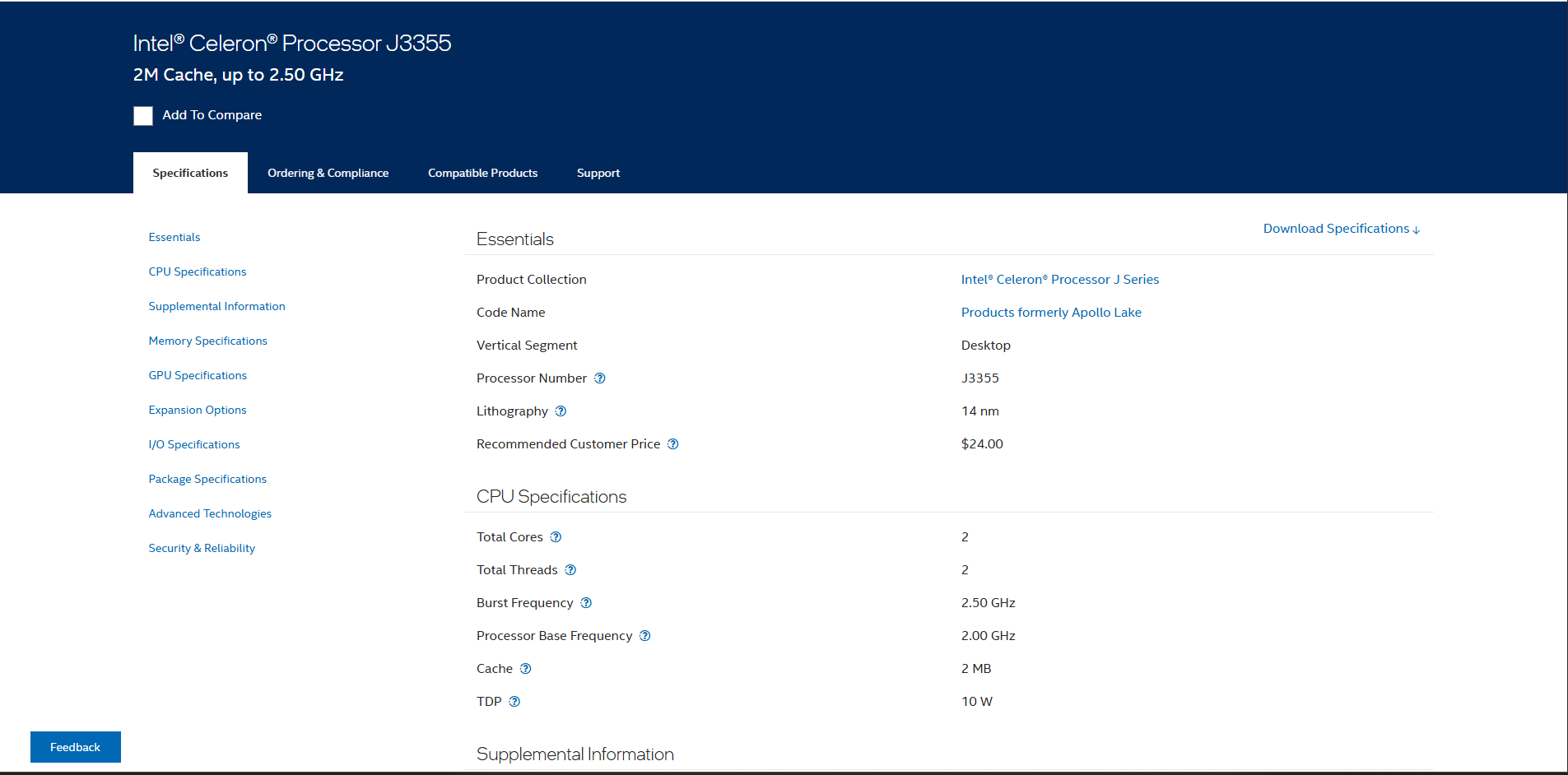

Please also note that your NAS uses an Intel Celeron J3355 processor, which is below our officially supported specifications for running Roon Server. This CPU can struggle with database management and real-time audio streaming, especially when handling network zones or high-quality music, or DSP settings
While your planned upgrades will certainly help, if playback issues persist even after these improvements, we recommend considering running Roon Server on a more powerful dedicated device (for example, an Intel NUC or desktop computer) for the best experience.

RAM has grown
