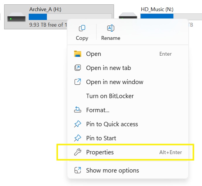

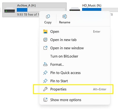

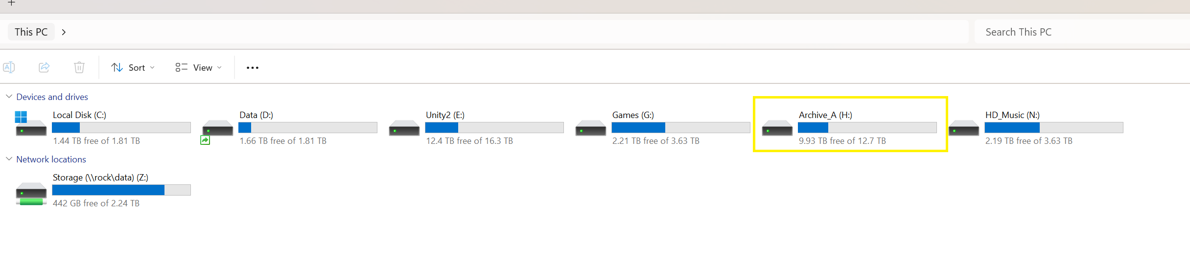

If you don’t know how to check on the format, turn off the Nucleus One, then move the drive to the Windows PC. Click on the This PC icon, which will bring up all the attached drives. In this case the drive called Archive_A is an external USB hard drive.
Right click on the drive to access the menu
Choose Properties and the Property screen should pop up.

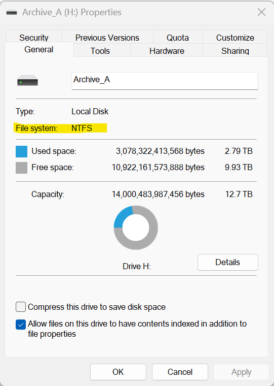

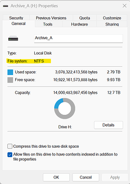

Note what is says under File System. In this case the drive is formatted NTFS, like we suspect yours is.
