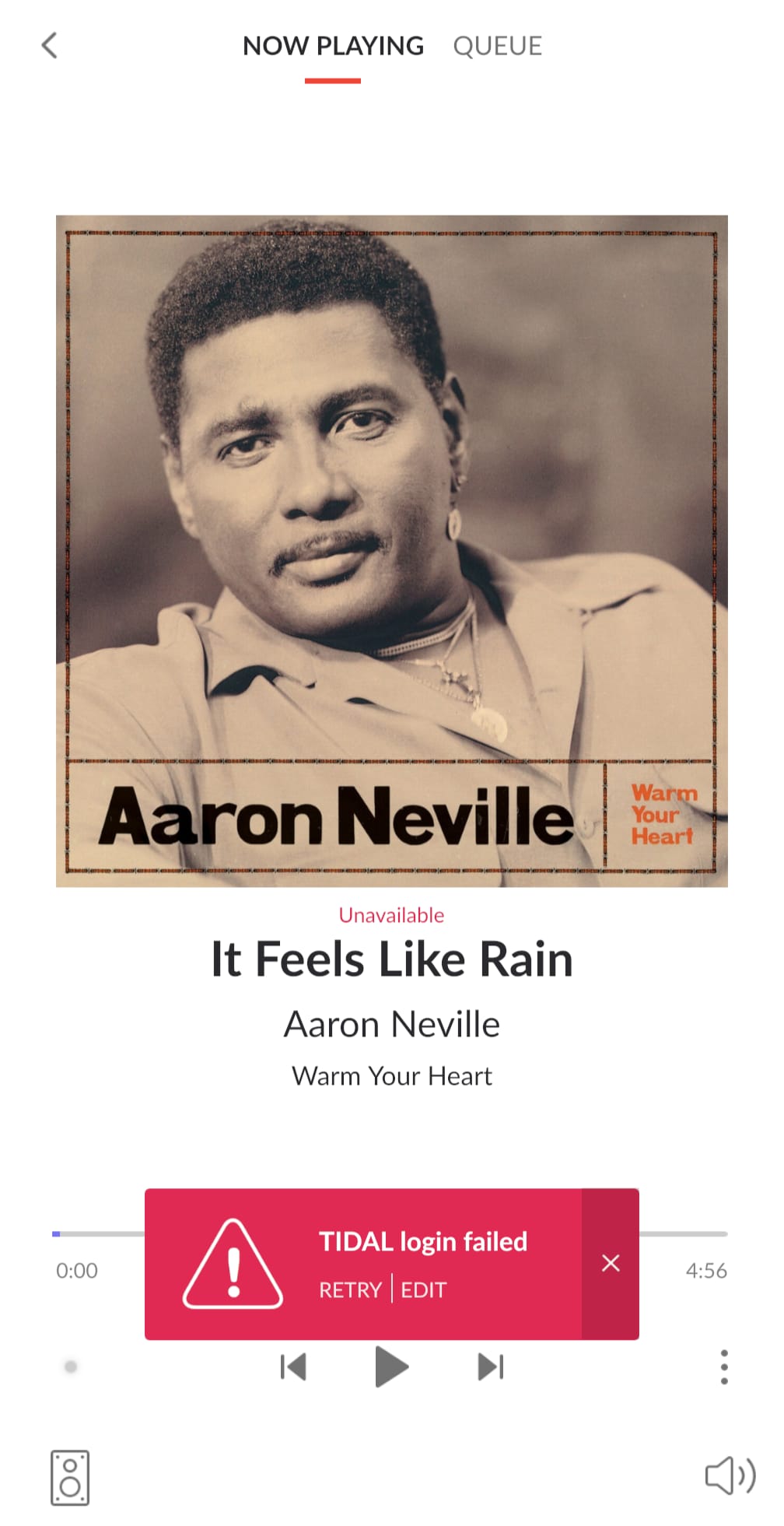

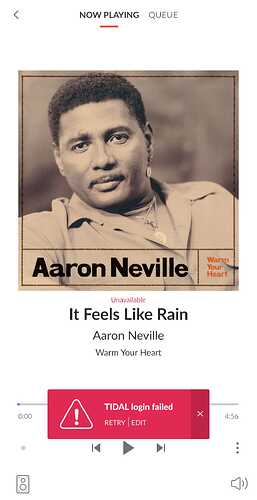

We see a Tidal Login failure in the Roon remote. We need to retry several times while a music from Tidal is playing, or playback will stop.
As soon as the Tidal error shows in the GUI, the SSL error is visible in the log.

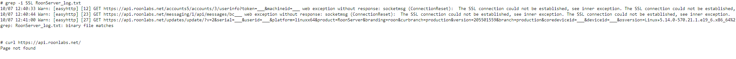

A curl to the same site, does not result in SSL errors:
# grep -i SSL RoonServer_log.txt
10/07 12:40:33 Warn: [easyhttp] [12] GET https://api.roonlabs.net/accounts5/accounts/3/userinfo?token=___&machineid=___ web exception without response: socketmsg (ConnectionReset):  The SSL connection could not be established, see inner exception. The SSL connection could not be established, see inner exception.
10/07 12:40:44 Warn: [easyhttp] [23] GET https://api.roonlabs.net/messaging/1/api/messages/bc___ web exception without response: socketmsg (ConnectionReset):  The SSL connection could not be established, see inner exception. The SSL connection could not be established, see inner exception.
10/07 12:41:00 Warn: [easyhttp] [27] GET https://api.roonlabs.net/updates/update/?v=2&serial=___&userid=___&platform=linuxx64&product=RoonServer&branding=roon&curbranch=production&version=205501559&branch=production&coredeviceid=___&deviceid=___&osversion=Linux+5.14.0-570.21.1.el9_6.x86_64%2brt&os64bit=true web exception without response: socketmsg (ConnectionReset):  The SSL connection could not be established, see inner exception. The SSL connection could not be established, see inner exception.
grep: RoonServer_log.txt: binary file matches
# curl https://api.roonlabs.net/
Page not found

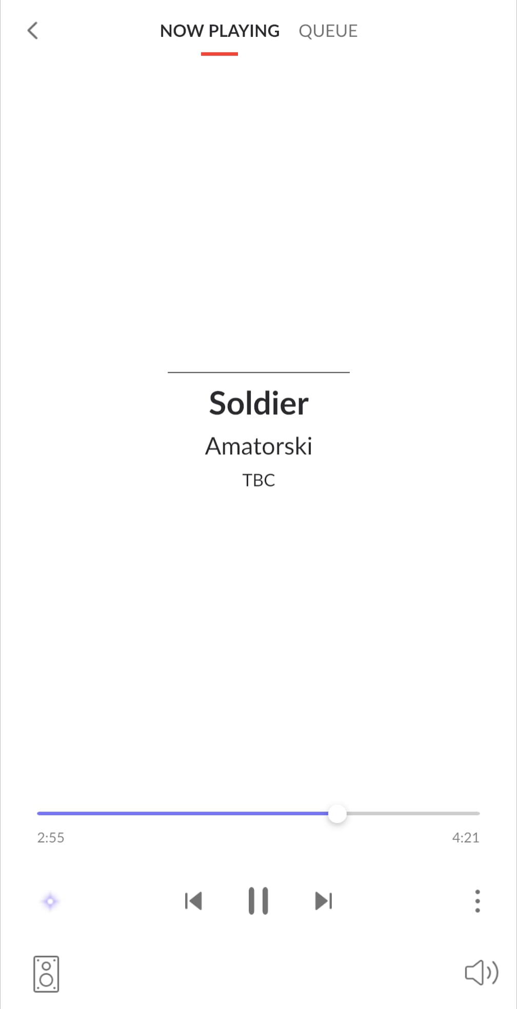

The SSL errors also affect cover art, e.g. playing this Amatorski album from Tidal, there’s no cover:
10/07 15:08:56 Warn: [broker/images] unexpected error GET'ing https://imagecache.roonlabs.net/im/1/albums/a6003139343230313830/cover/1024.jpg: statuscode=999 error=System.Net.WebException: The SSL connection could not be established, see inner exception.
