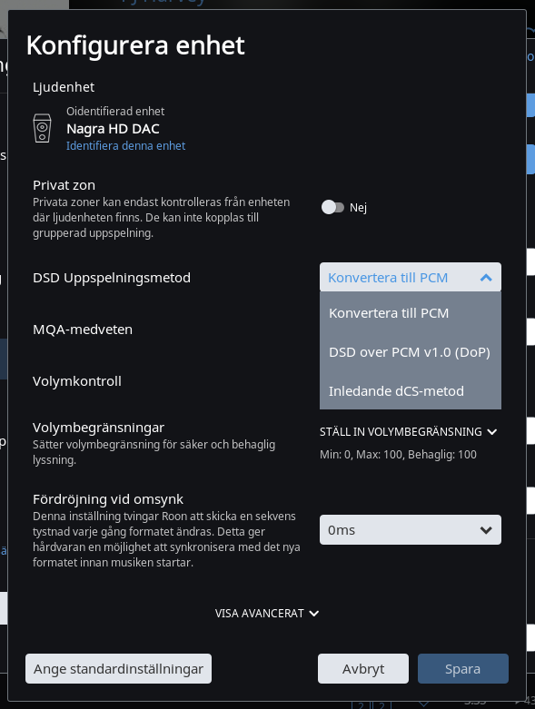

Sorry Harry, but i cannot seem to get Roon to recognize my Nagra HD DAC as DSD Native capable? Or am i missing something?
Feedback ID: ac9c38e974994663
Yeah… it identifies differently. The guys at Nagra tested this with a Nagra DAC, and not an HD.
I need to check with the Nagra team. I’ll get back to you asap.

Hi @Mikael_Ollars,
I’ve reached out to the Nagra team and they told me that there are 2 versions of the Nagra HD DAC.
The ‘old’ one and the upgraded one. You have the old one, which is capable only of doing DoP.
Alright, thank you for the response Harry! It’s not an issue though, sounds pretty convincing with DoP also! :smiley:
