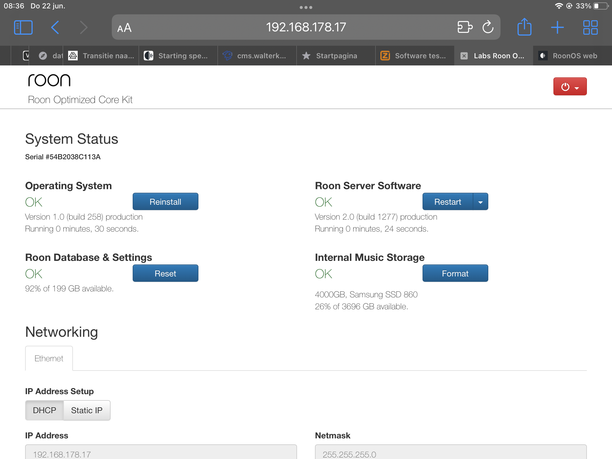

As a good next step, I would create a fresh backup and then reinstall the Nucleus OS via the webUI. Here is how to access the webUI:

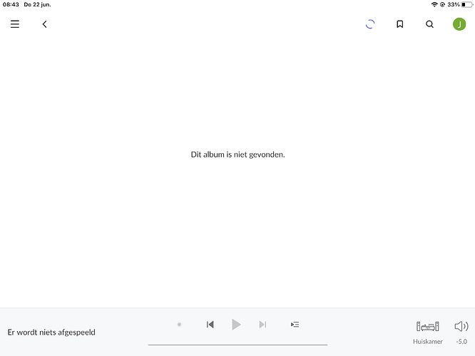

I did as you suggested and it seems to solve one of the problems. Searching for an album is almost instantly and starting a track of this album is within 1 - 3 seconds. Not bad result.
If switched off the Nucleus Plus completely or after a reboot, online by the web browser it is available within a minute but really able to use and start playing music, still takes about 8 minutes.

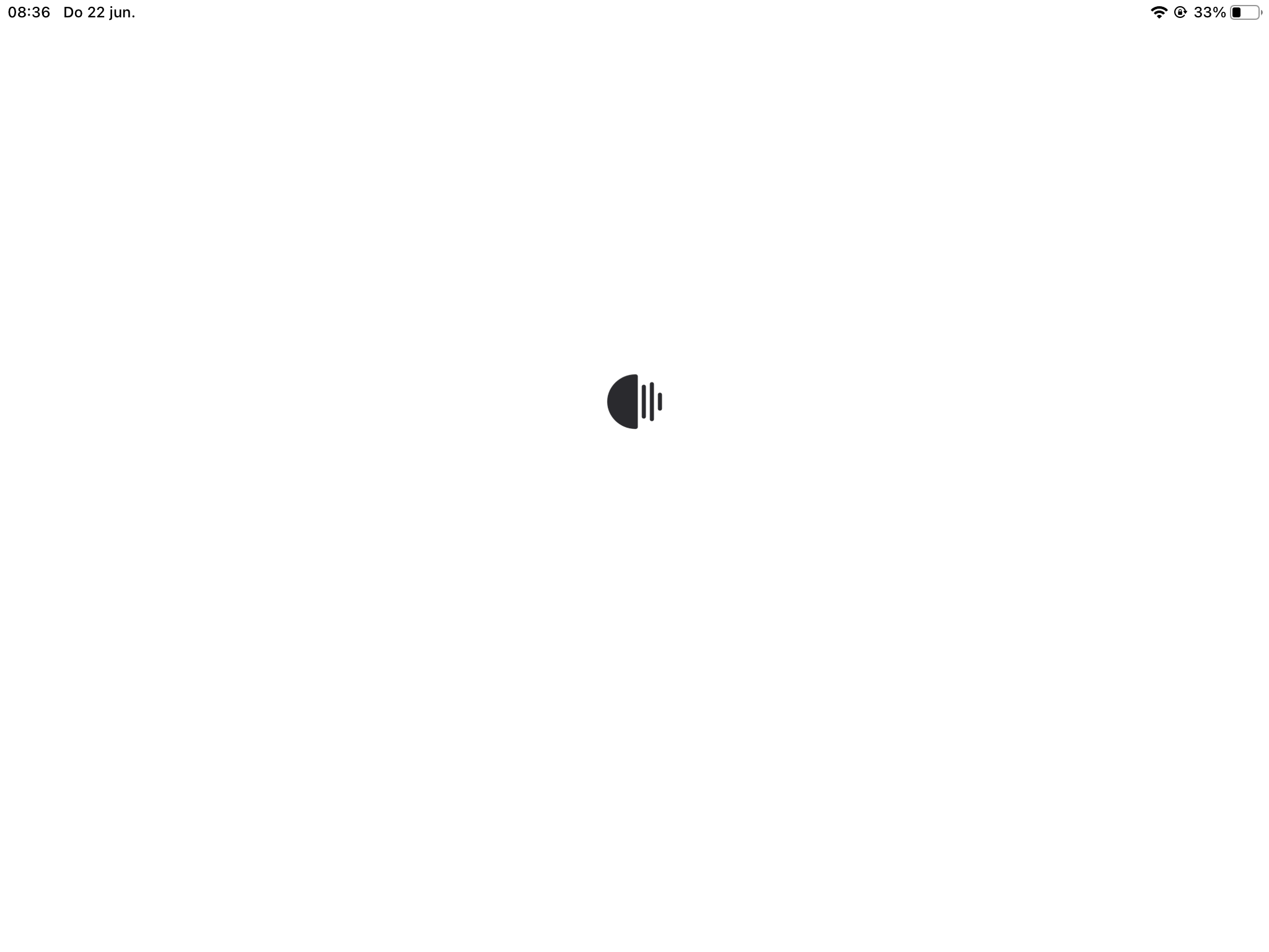

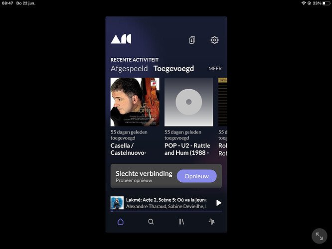

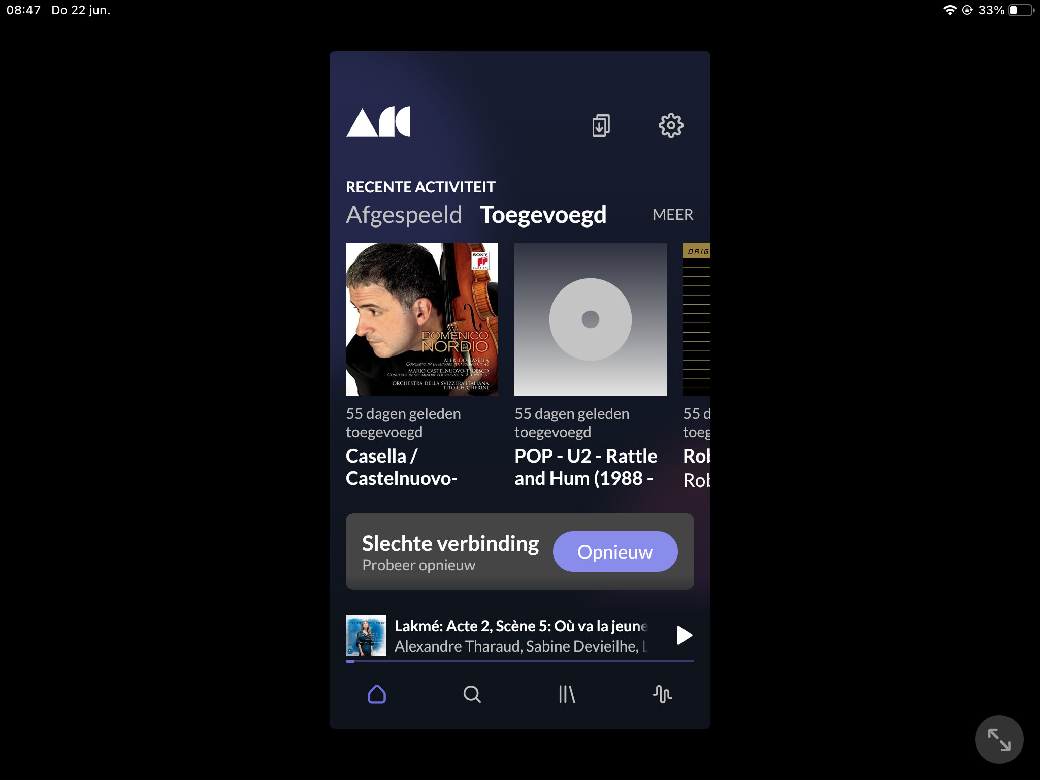

ARC is showing by my both iPad’s (iPad 2022 Pro) a bad connection, see below images but on my iPhone 12 it is possible to play music without showing this. Unfortunately the music stops playing after a minute or so
So, using ROON by my Nucleus Plus still has two issues
  • Starting to play music after a reboot takes 8 minutes
  • ARC is absolutely not stable and loose connection within 1 minute on my iPhone and showing a bad connection on both of my iPad’s 2022 Pro.

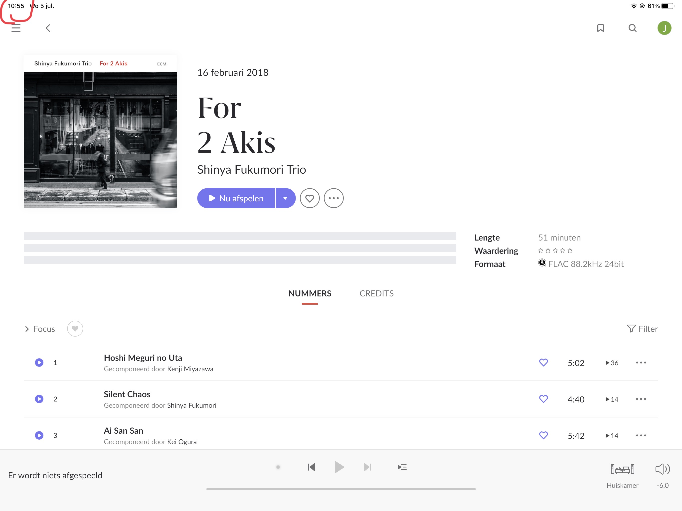

Please find attached pictures of rebooting time of 8 minutes and the bad connection to ARC by my iPad’s 2022 Pro although my wired connection to the Nucleus plus is 410 Mbps download and 45 Mbps upload

8 minutes to be fully available seems pretty long to me although this wasn’t the biggest problem.
Finding an album or starting a track was the biggest problem and took very long.
Although I did what Ben suggested already before his reply, backup and reinstall the OS, didn’t solve the issue.
Now I did it again this morning and finding an album and starting a track has been solved.

  • ARC totally not working, for about 1 minute on my iPhone and iPad showing bad connection, try again

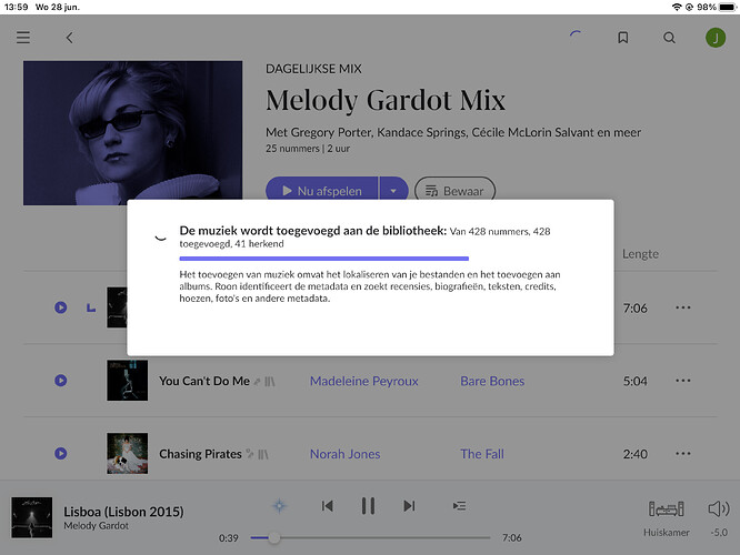

It also is telling me I have to wait while the is a new update (which is not the case if I am correct)?
There is also a message: Music will be added to your libary. 428 tracks are added, 41 tracks are recognized.
Can you please check or you do see any errors at the moment?

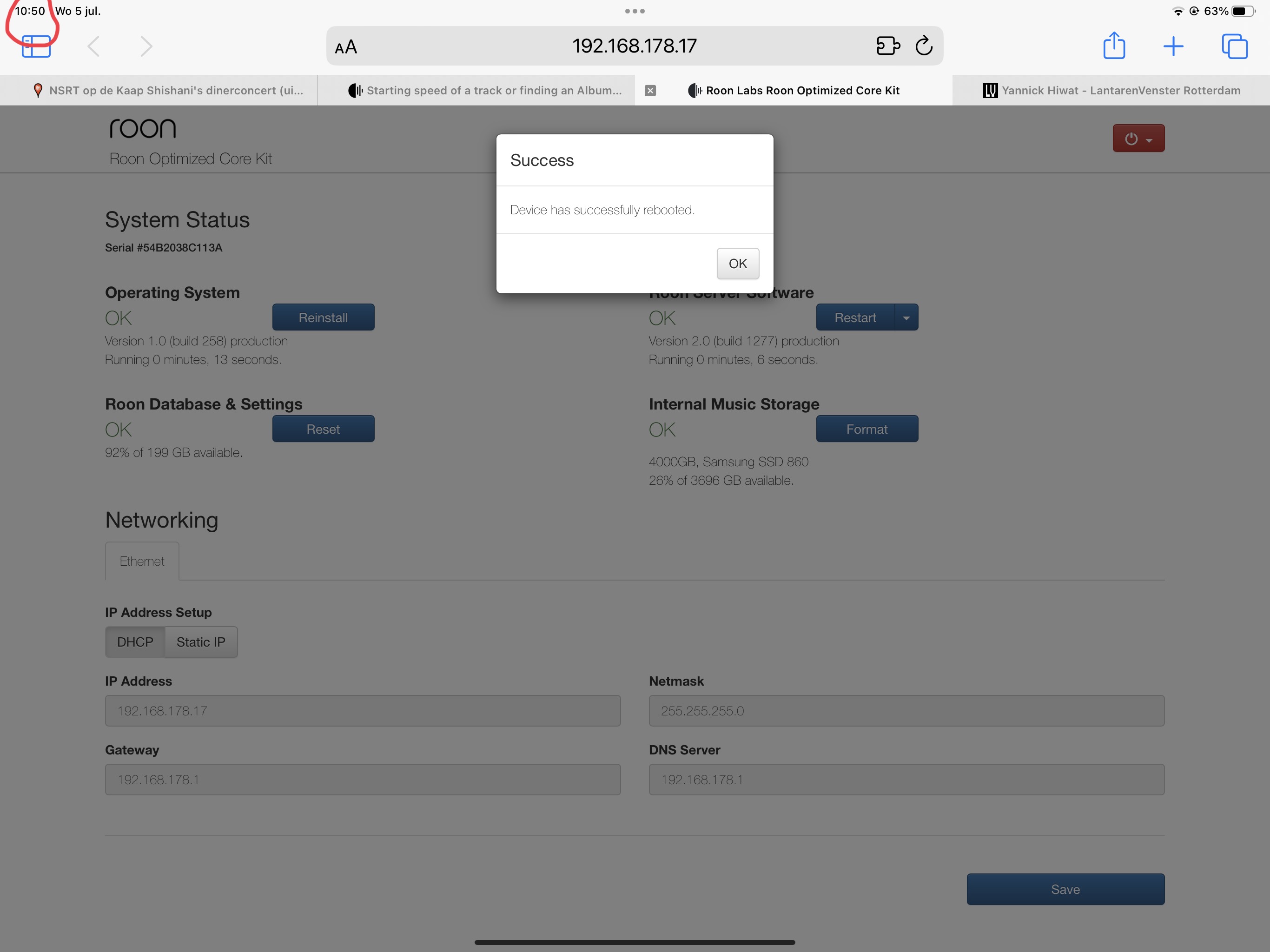

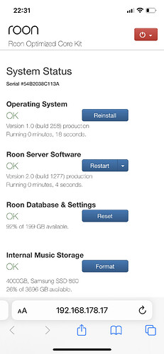

I will restart the Core at my Nucleus Plus right now. 22.30hr CET + 2
@benjamin

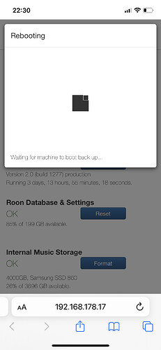

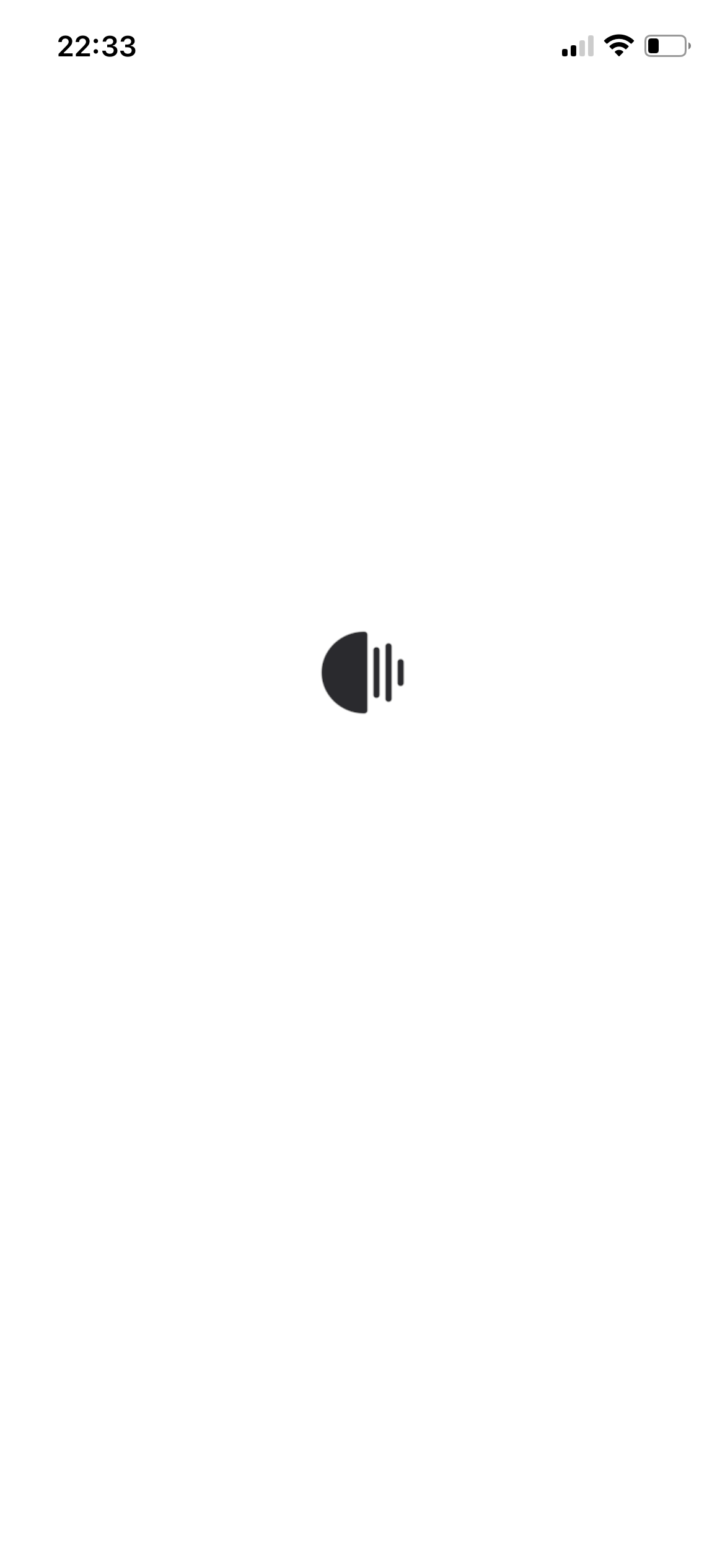

I rebooted by the browser the core exactly at 22.30hr CET+2. The Core showed at 22.31hr is was successfully rebooted.

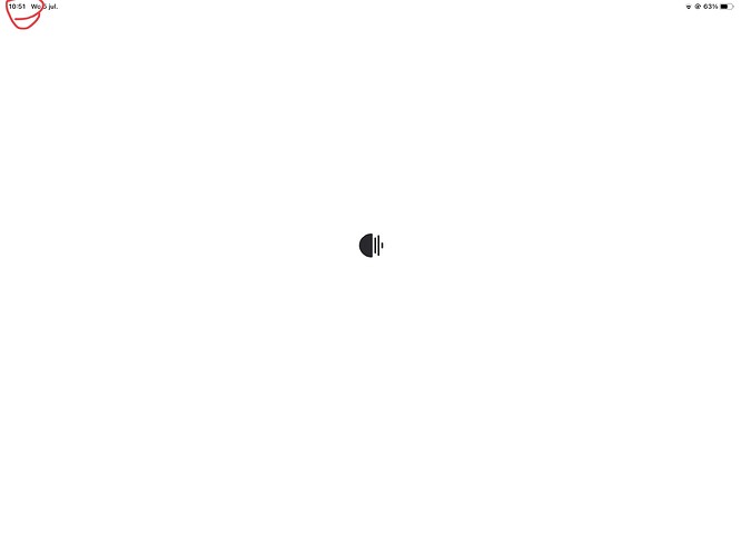

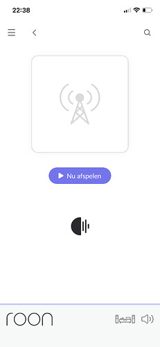

At 22.33 I took a screenshot of ROON at my iPhone. Still looking for ROON……
At 22.39hr ROON was accessible by my iPhonr again. All together from switching off, rebooting and available took 9 minutes. With no access to any watched folder. Just Tidal and Qobuz.
See below screenshots as asked for

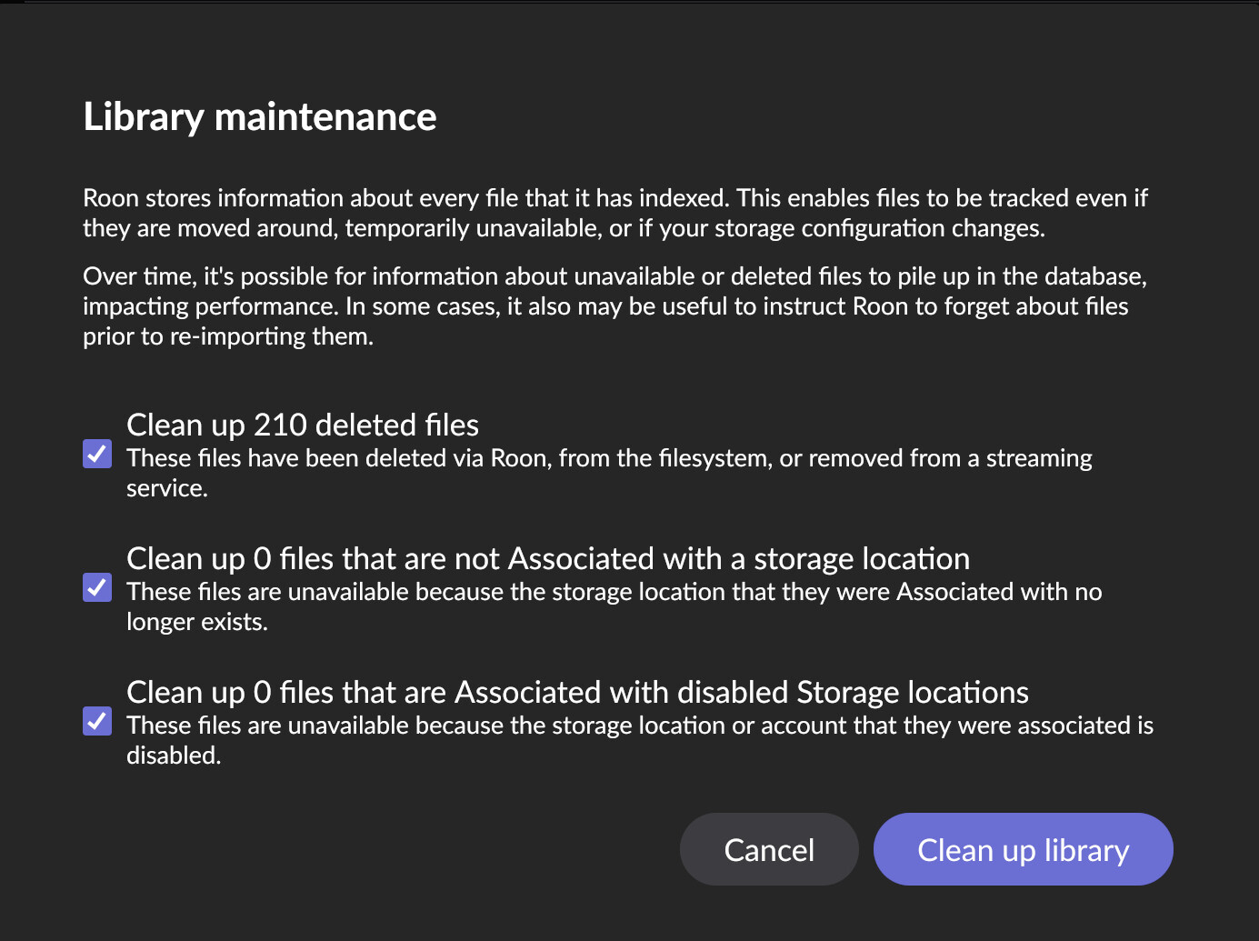

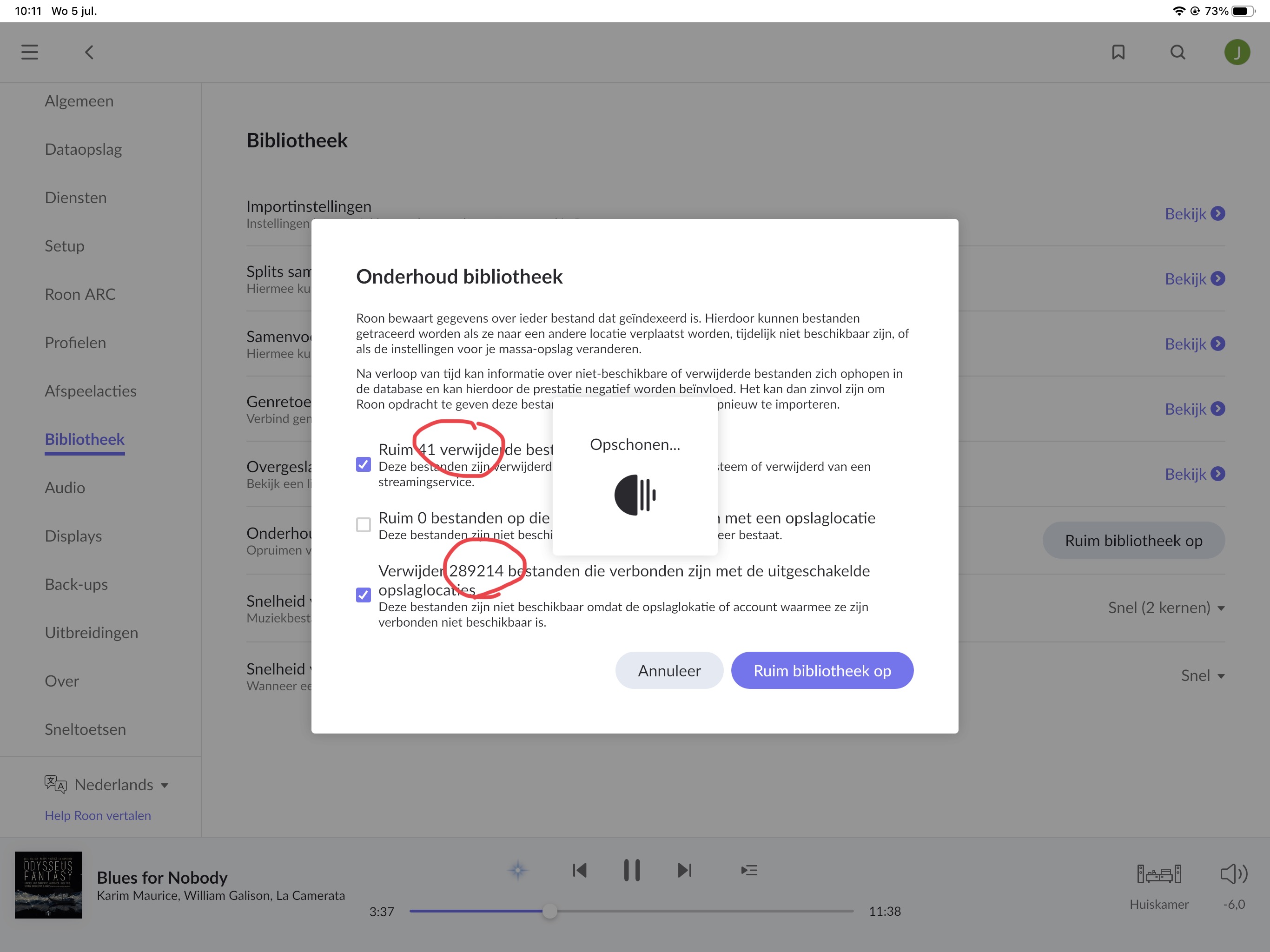

I’m guessing the missing library locations are still in the database and it’s this loading time that is likely the long load wait. If you do a library maintenance and remove the now non linked tracks this would improve I think. Otherwise start with a clean database but make sure you have a full backup before hand especially if you have metadata edits done.
@wizardofoz
Thanks for your suggestions, could have been correct assumptions.
Unfortunately this was not the solution.

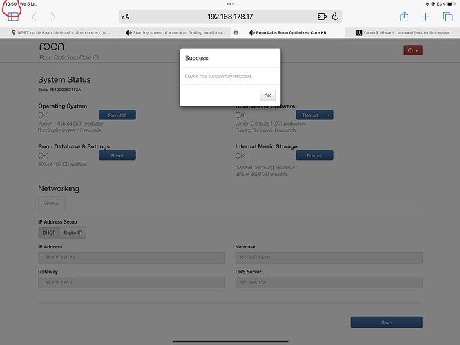

I did as you suggested and removed the 290K tracks which were connected to my disassembled folders.

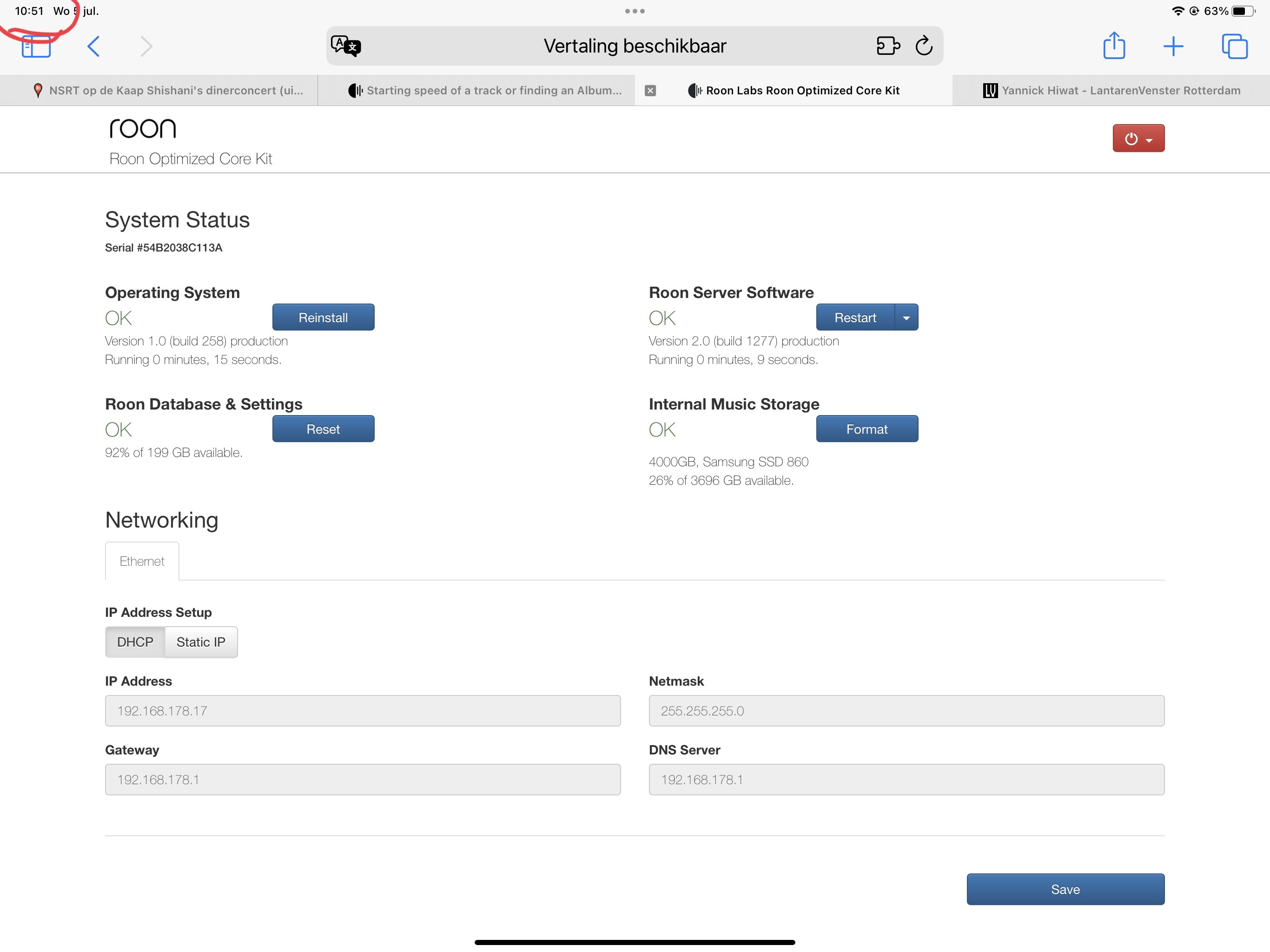

Rebooted several times but instead of 8 - 9 minutes the reboot now takes 6 minutes.
See screenshots and highlighted time at the left upper corner.
So, this wasn’t the solution but thanks for your suggestions

Reset the database in the web gui. It will start clean like factory new. Your database is still using 8% of the ssd
