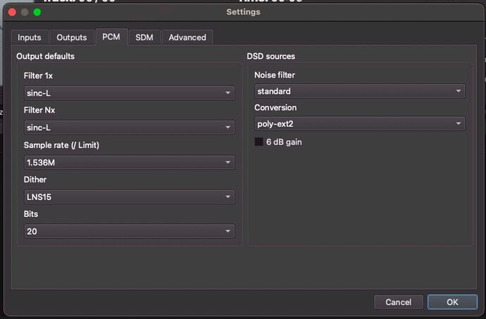

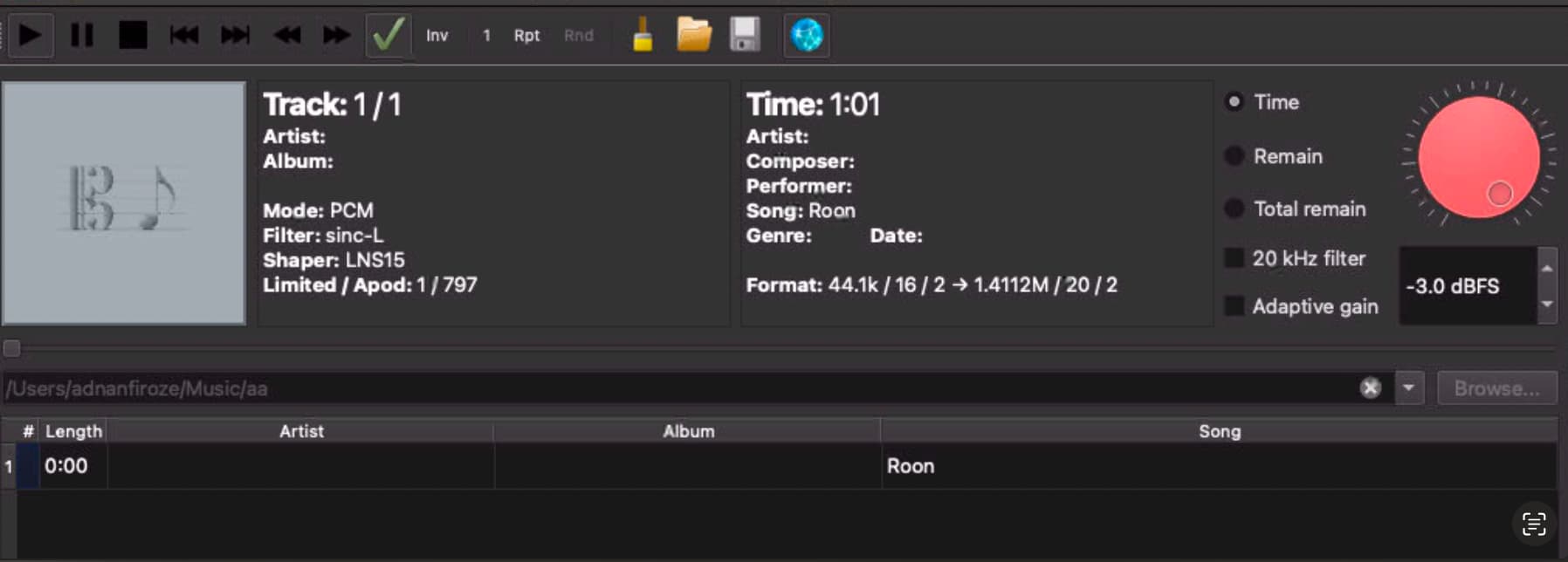

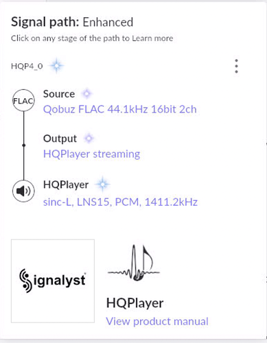

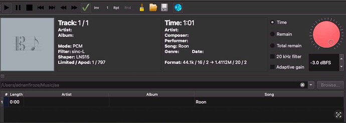

Even with “Adaptive sample rate” enabled/greyed (semi-enabled) and also forcing 44.1K sources to only integer multiples of it, I am hearing white noise behind the music (actually like 60% static noise and 40% music). The path is like this: Roon (44.1KHz) → Roon → Holo Red streamer → Holo Spring 3 KTE DAC (screenshot below). There is no issue with 48K (or 96K i.e., multiples of 48K) music files here. Only with 44.1 and its multiples does Sinc-L behave like this. I diagnosed the sample rates on the DAC screen, and everything “theoretically” is working fine except for the sound when using SINC-L. Computation power is not an issue - no stuttering.
Can anyone please make some suggestions? [some screenshots given below - the problematic case - if changed to 48K or multiple - all fine!]
