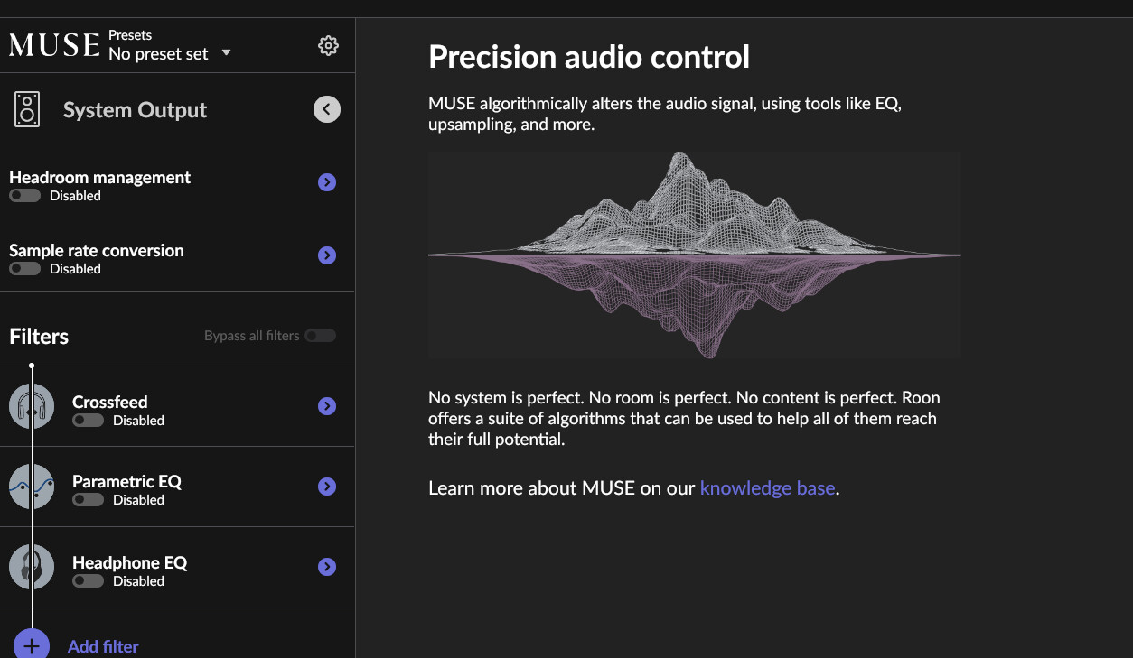

Have you tried enabling Headroom Management in Muse settings?
Thank you @AceRimmer. My Oppo’s connected to the P7 via RCA from the stereo outputs (as opposed to the separate front left and front right RCA outputs). The P7’s connected to the A31 via XLR. I remember reading somewhere that XLR has more gain than RCA. Could that be part of this?
Yes, turning on headroom and/or activating volume leveling both work to address the fuzziness/static. It’s like if Miles Davis forgot to blow out the spit from his trumpet before playing and all we heard was raspberries instead of a pure trumpet sound. Even though turning on volume leveling or activating headroom fixes it, I’d still like to address the underlying problem if I can.
