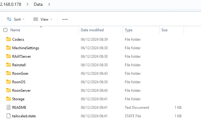

Just to check when I mount rock on my pc there is a data folder in here is a lot of folders. Is the storage folder the 3tb drive? Its not abundantly clear that is the case as clearly there is the system folders on here too.

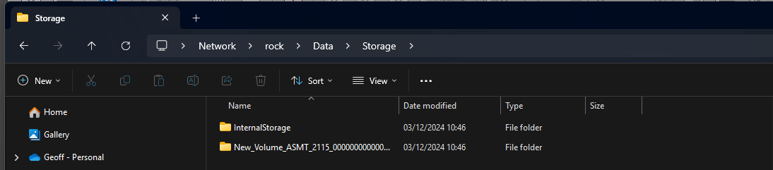

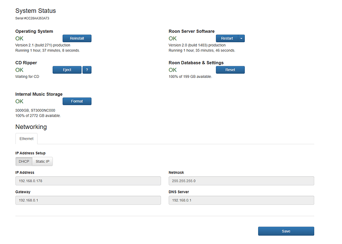

Can you post a screenshot of the Web Administration interface of your server, and also a screenshot of the contents of the \\ROCK\Data\Storage folder as seen in Windows File Explorer?
For example:

When i launched the interface the 3tv drive was there, I initialised it:
When I open from windows I get:
Screenshot 2024-12-06 101921
In the storage folder is ‘Internal Storage’ this shows up fine in windows, is this the 3TB drive?

You need to click under storage. Internal Storage would be there. At the moment, the pic you posted is the OS drive, not a secondary internal drive.
I am interested to understand how the storage exists within a folder on the main drive. I am assuming some sort of sim link or something.
Yes, that is a folder of links.

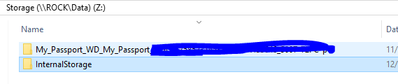

See mine…under storage I find both a folder of Internal Storage and the USB attached WD drive.
