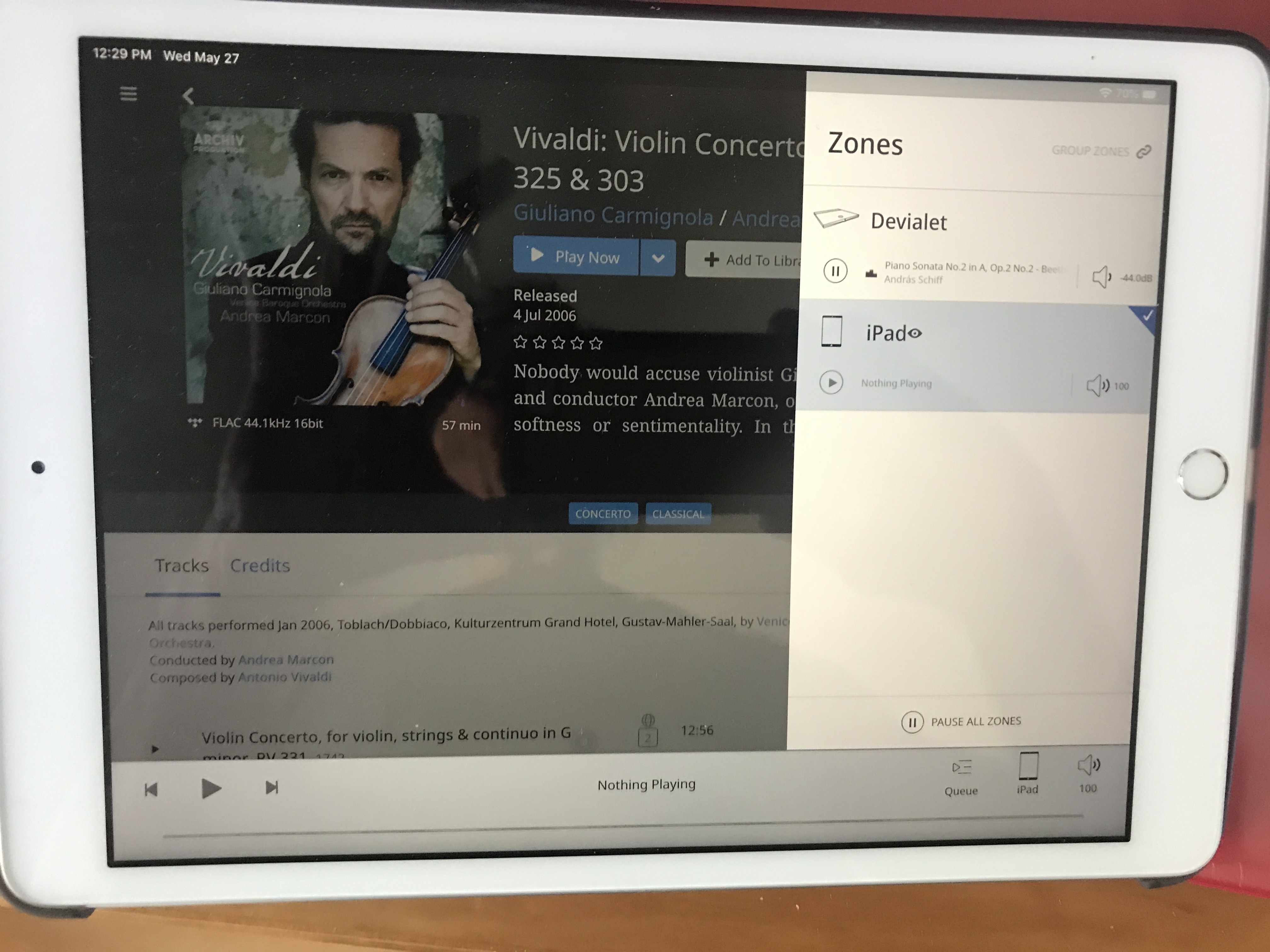

Thank you for getting back to me. The reboot helped. I am not getting the messages (select a zone, trouble connecting to Tidal) nor watching it seem to bounce around on Settings/audio page as if searching for a zone. However it has cut out intermittently this morning and then started up again a few seconds later as if it lost the connection. As I mentioned both the Devialet Pro and the Roon are ethernet wired into the router (although not to each other). In other words I don’t think this is a network signal issue at all. FYI I’m attaching a photo of there iPad on the current Settings/Audio page. As you can see it is using the “Devialet” zone. I’m not sure if I should be using the “Devialet Expert 140 Pro” zone instead (whatever ALSA) is. Your thoughts?
The iPad is the sole controller. That said, after enabling the iPad I’m not getting any sound out of it from the Devialet

The ALSA connection is the USB connection to the Devialet, while the Devialet zone under Roon Ready is streaming to it via the network. Generally, you’ll want to use the Roon Ready input on a device if it supports it.
If you have enabled the iPad zone and have selected it from the zone picker (click on Devilaet in bottom right next to volume control → iPad) then music should start playing to the iPad speakers.
Can you please confirm if the iPad zone experiences the same issue as the Devialet Roon Ready zone?

As for the iPad I’m a little confused because although I click on it as a zone it doesn’t produce any music. I’m not sure why that is. Do I have a setting wrong somewhere?

It looks like you have the iPad zone selected in the sidebar, so as soon as you queue a track, music should start playing to the iPad internal speakers. Can you give that a try and see if the issues occur there as well?
Got it. The iPad is playing now. Let me play it for a while and see if I get dropouts. Thanks for the guidance.
