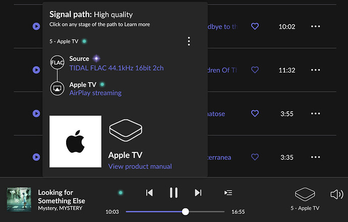

This is what the Signal Path shows when I stream via ATV.

In a nutshell, can some kind soul tell me how my ATV sound quality compares to a native Roon endpoint? If I’m reading my streaming details correctly, my PS Audio DSJ is RAAT, my MacBook is RAAT but the Apple TV just says “…describes the hardware and streaming technology used to render…” and has a green dot.
Am I limited to 44.1/16bit with AppleTV, or is it lower?
Nearly my entire collection is ripped CD’s and I listen to radio that’s sometimes even .mp3 but I also subscribe to Tidal and Qobuz from time to time. As I consider other additions to my system, it would be nice to know what ATV is capable of.
