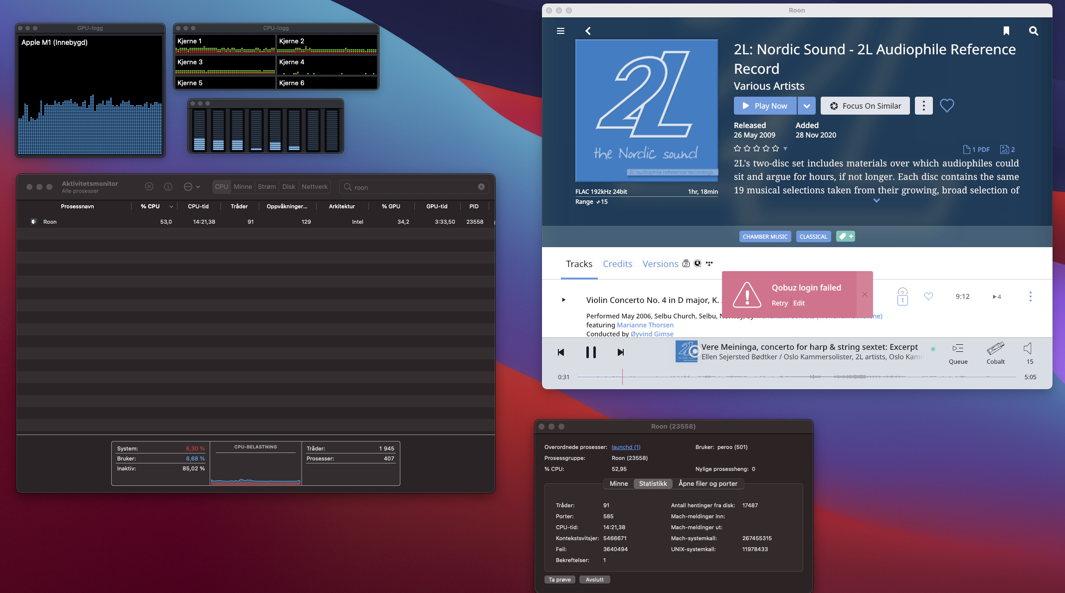

New info (and Robert have a point)
I tried working on the Mac mini while playing music from my local library. This time it did not stop after 10 minutes, but after about 13 minutes I got a Tidal not logged in message and music stopped. The Roon GUI looked like it reset at the same time.
All powersaving is turned off (sorry for Norwegian language)
Skjermbilde 2020-12-05 kl. 15.59.05
Might want to post it in support. Looks like a Tidal Roon communication issue. Quit both and try and fresh log in.
Thread moved to support.
I tried to log out both Tidal and Qobuz. After new login it was more stable for a short time then it is just as bad or worse (some drops after less than three minutes).
But I think this is on the right track debugging because when I open the app I get the qobuz error message. Even while I was writing this post I saw the Roon Core/App got a zobuz error message, got blank screen and got back to the previous view again. Sometimes I get Tidal errors also so both streaming logins have problems.

Screenshots attached with filename according to each description I tried to do multiple screenshots to show change in CPU/GPU load.
