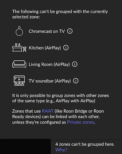

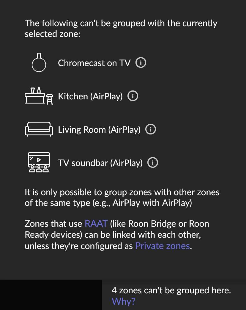

Are you able to group the CXN (as a USB device) with the Sonos Ones and Homepods? I didn’t think that was possible. I have a mix of speakers with Airplay, Chromecast speakers, and Roon’s RAAT:
So this raises a few questions:
With your grouped devices, Is the CXN getting music from Roon over ethernet, wifi, or USB?
Let’s assume it’s getting music over the network, otherwise Airplay grouping wouldn’t work. Has the CXN moved to a different location that improves network communication?

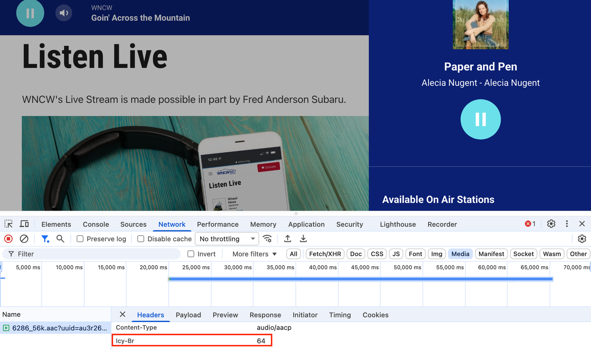

What’s the bit rate of streaming music from the internet radio stations you listen to? The answer may effect perceived audio delays between devices. For example, I saw you mention in another post, that WNCW is station you listen to. For me, it streams at 64 kbps which is approximately 22x smaller than typical 1411 kbps CD quality (16-bit, 44.1 kHz) streams from Qobuz, Tidal, and local files. Meaning that those radio station streams may reach Airplay devices fast enough that you don’t notice music getting out of sync.

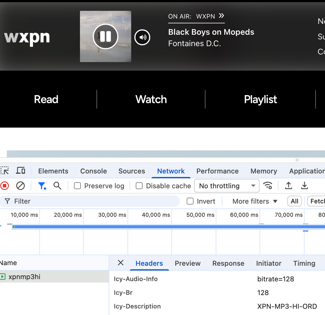

WXPN streams at 128 kbps
