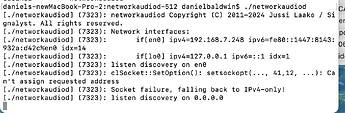

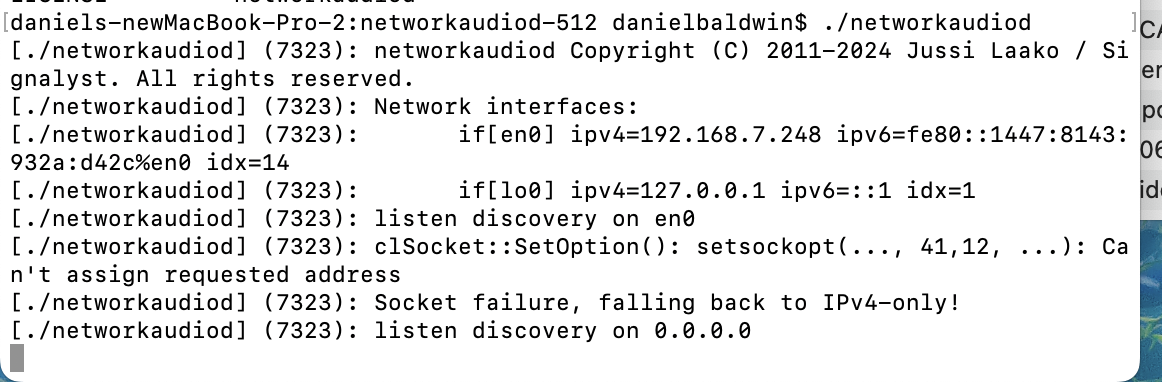

Also, when I download the most recent networkaudioid from
signalyst.eu/bins/naa/mac" and run it, it seems to fail and never terminates. See screenshot

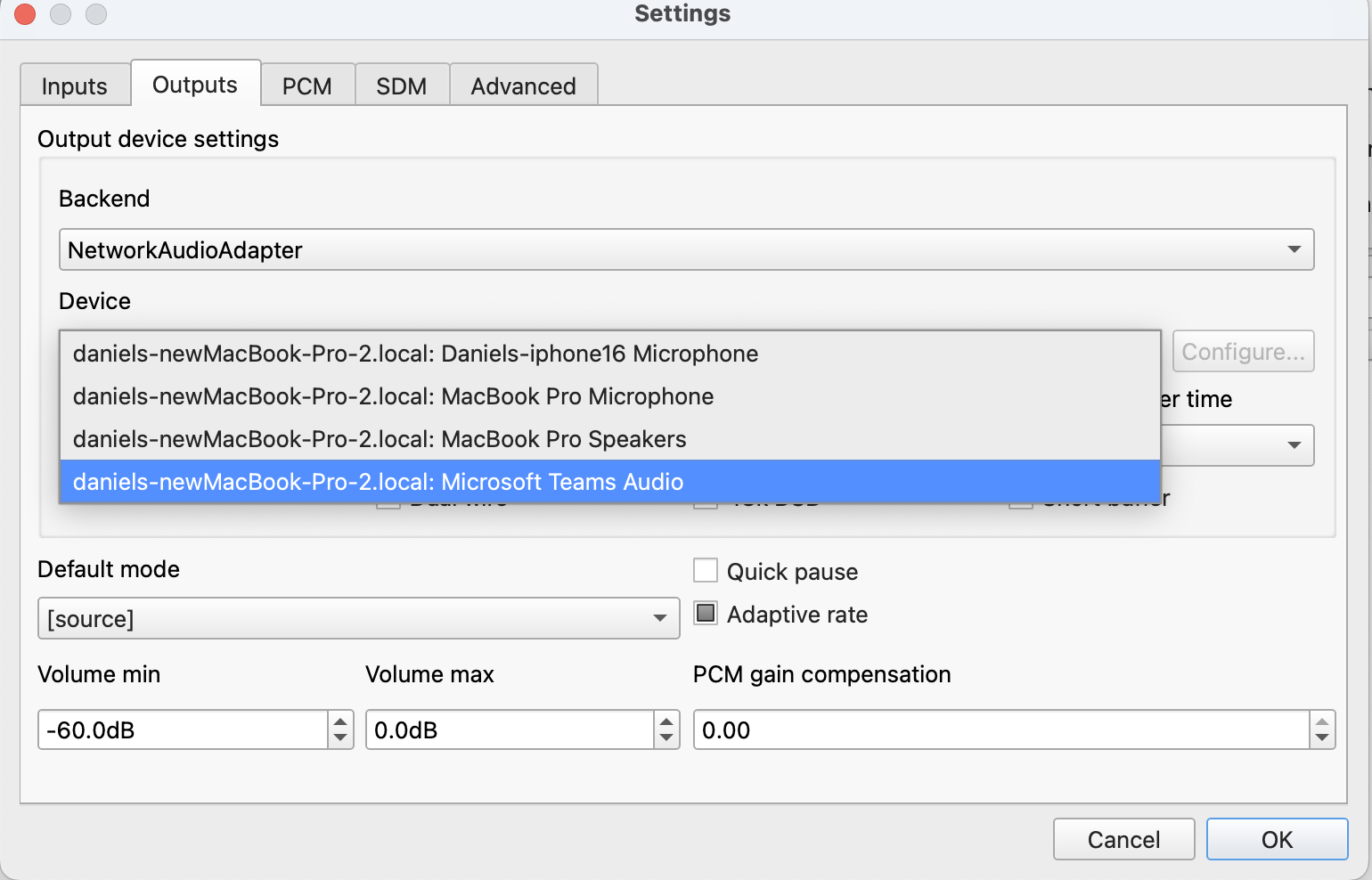

Something is changing, this is what I get now on the output settings:
Should I install the networkaudioid on the machine that hosts the Roon Core or the machine running HQPlayer ?

I don’t think this one is going to work with HQPlayer…
In this case, in the Aurender N200. It would be installed in the device where DAC 200 is connected by USB, if it is not the same machine where HQPlayer is running. It allows you to move the audio endpoint outside of the HQPlayer server machine.
