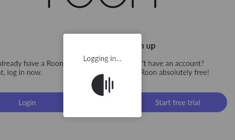

The login to my Roon Rock will not finish. I have the Roon app on my Iphone IOS 18, Ipad OS15, Windows 11 and windows 10 PC. I can connect to my Roon, can select my Roon Optimized Core Kit. Get a green indicator with ready. RoonOS 2.1. I select connect, then login, Message Roon wants to use roonlabs.com to sign in. I press Continue. I get popup acccount.roon.app. Select my account to login. Then it stays in the login screen for a moment and I'm back one step. Same on all my devices. I have a NUC for the Roon Rock. Just installed the latest image from your website. I can login to my account in a brouwser.
TPlink router, TPlink switch, wires to NUC an PC, WiFi to the rest
Yesterday it was solved but now it is blocked in login again. This after the message to update it went wrong.
