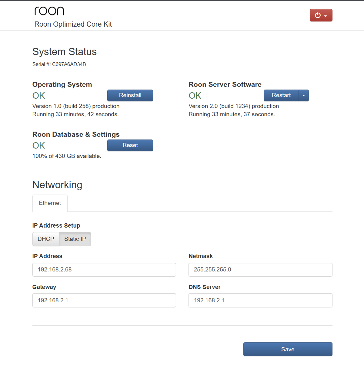

Current status in the ROCK Web Administration Interface:
- Operating System: Version 1.0 (build 258) – OK
- Roon Server Software: Version 2.0 (build 1234) production – OK
- Roon Database & Settings: OK
Network settings of ROCK:
- Static IP: 192.168.2.68
- Netmask: 255.255.255.0
- Gateway: 192.168.2.1
- DNS Server: I tried 192.168.2.1 (router), 1.1.1.1 and 8.8.8.8 – no difference.
- ROCK is reachable from my PCs via Web UI (http://rock or http://192.168.2.68) and via SMB share \\rock\data.

When I try to reinstall/update from the ROCK Web UI, after some time I get this error:
“There was an error downloading Roon. Please check your internet connection.
{"status":"Failure","exitcode":11}”

After emergency reinstall to RoonOS 1.0 (build 258), Web UI offers update to RoonOS 2.0 (build 1234) but it never completes (“Updating and Reinstalling” spins).
Internet access from other devices is normal; Qobuz app works directly. Issue seems limited to ROCK fetching the OS update.
