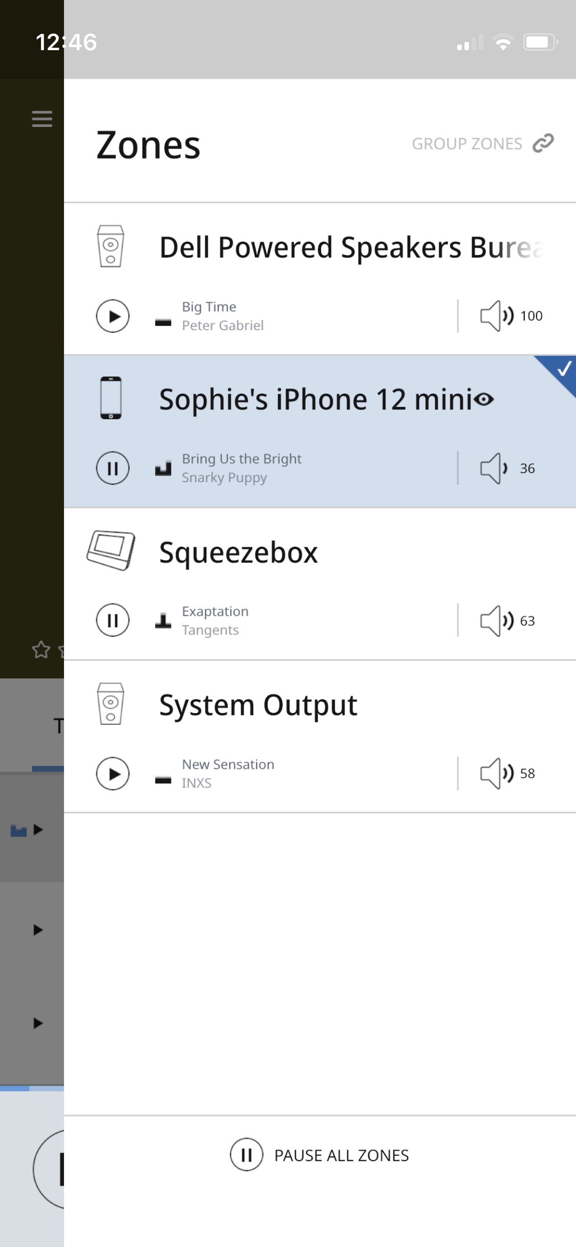

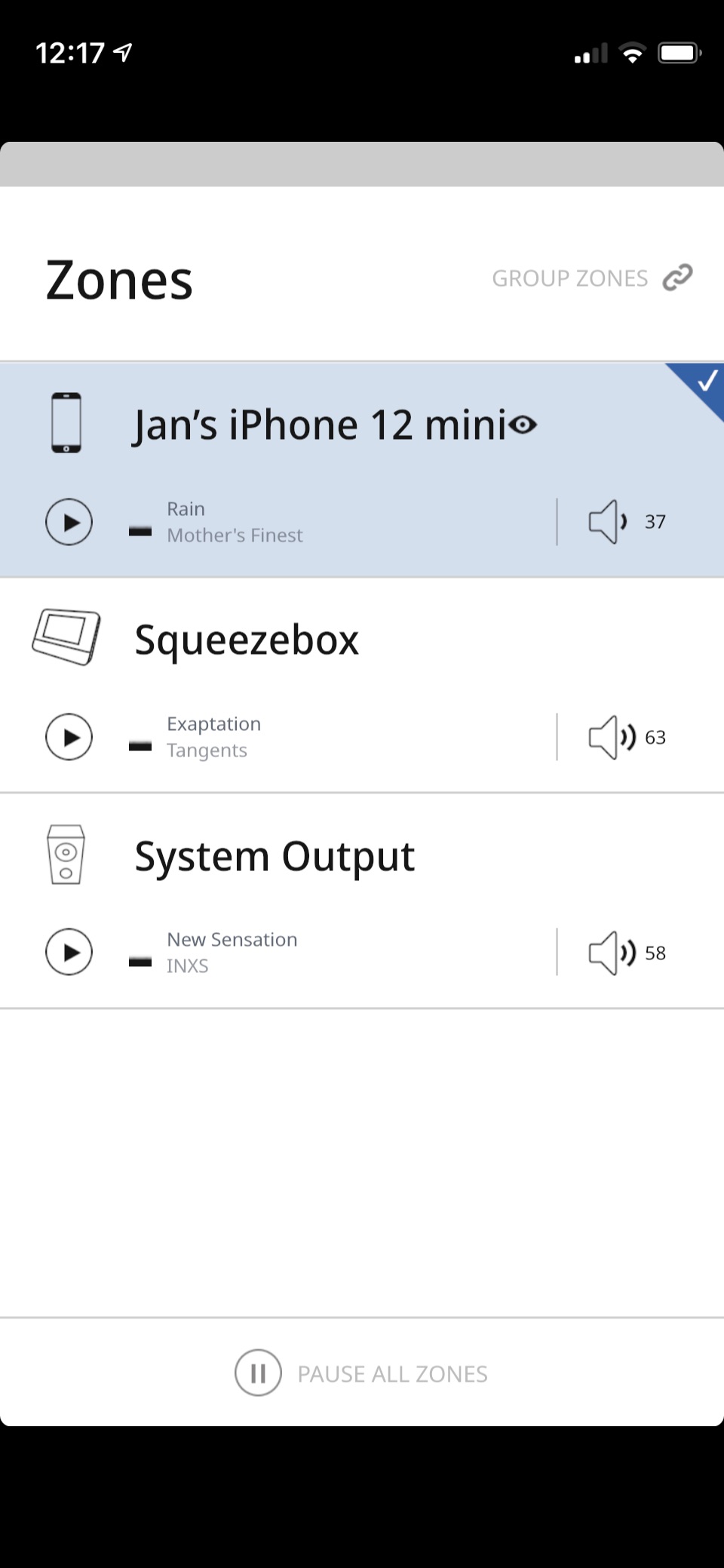

When selecting the Zones menu on the iPhone App on my new iPhone 12 mini the menu becomes full screen, see first screenshot. While it allows me to change the zone I want to control next, I can’t find a way to close the menu. On the identical device of my partner, the familiar edge on the left side of the screen serves to close the menu and return to playback control, see second screenshot.
The only way to resolve this in my case, is to completely shut down the App and restart it. Fortunately, it then starts in the normal view, with the zone changed to the desired one. But it is still a nuisance. I’d normally reinstall the App, but since it is the same version (Roon 1.7, build 610), that doesn’t sound like a solution.

Found it !!
The display was set to zoomed-in mode. The different sizes of the screenshots gave it away.
The standard display setting is working fine, but for compatibility reasons, I would suggest the App developer to make the interface accommodate this alternative setting (37% less screen real estate).
