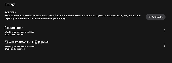

There is something else odd here, it looks like Roon is attempting to scan your entire Documents folder. Can you please take a look over your Roon Settings → Stroage settings, do you have your entire Documents or hard drive added there? Ideally you should only have your Music folder there. May not be related to the issue at hand, but it is causing Roon to do a lot more scanning than necessary.

Thanks very much for your responses. First, regarding folders - this is what I see on my end:
Do you see any problems with this?

Thanks so much for your patience here! We’re seeing some odd behavior occurring right around the time you started playback for Lay Lady Lay - take a look here:
Warn: [storage] [directory] Failed to extract audio format from 'F:\Windows from Music\Windows\winsxs\amd64_microsoft-windows-s..-soundthemes-garden_31bf3856ad364e35_6.1.7600.16385_none_f7a4bf1e15863e21\Windows Balloon.wav': UnsupportedFormat
It looks like you may have some unintentional windows system sounds nestled within one of your watched folders. Would you be able to double check this?
Specifically, we’re seeing a long list of errors surrounding this folder:
I’d remove this folder from your watched folders, as it looks like a long list of windows system sounds that Roon isn’t able to process properly.

Thanks for continuing to help! I tried to create a an exception for the Windows folder on my F: drive you referenced. I have no idea why these folders are there - I was unable to delete them, so hopefully the exception works. My internet speed tested at 800Mbps, so that is probably not the issue unless I am having intermittent problems. That said, this problem has only occurred with Bob Dylan albums which is just strange. Nashville Skyline is playing without issues presently - so maybe the Windows exception worked? Thanks again and I will let you know if the problem arises tomorrow. -Mark

There should never be anything other than music under a watched music folder.
This path…
is all sorts of wrong. There should never be any foundational Windows directories and sub-directories under the music folder. If it is, Roon will over and over again try and process these files which could be a reason for the drop outs.
Which is weird since the Windows folder should be on the bootable C drive.
I would suggest investigating and correcting why there is a Windows system folder under Music. That should not be. There should be nothing under the music folder except music files.

  1. Completely removed the separate disk (F: drive) that Roon was scanning and contained Windows files. The problem persisted.
