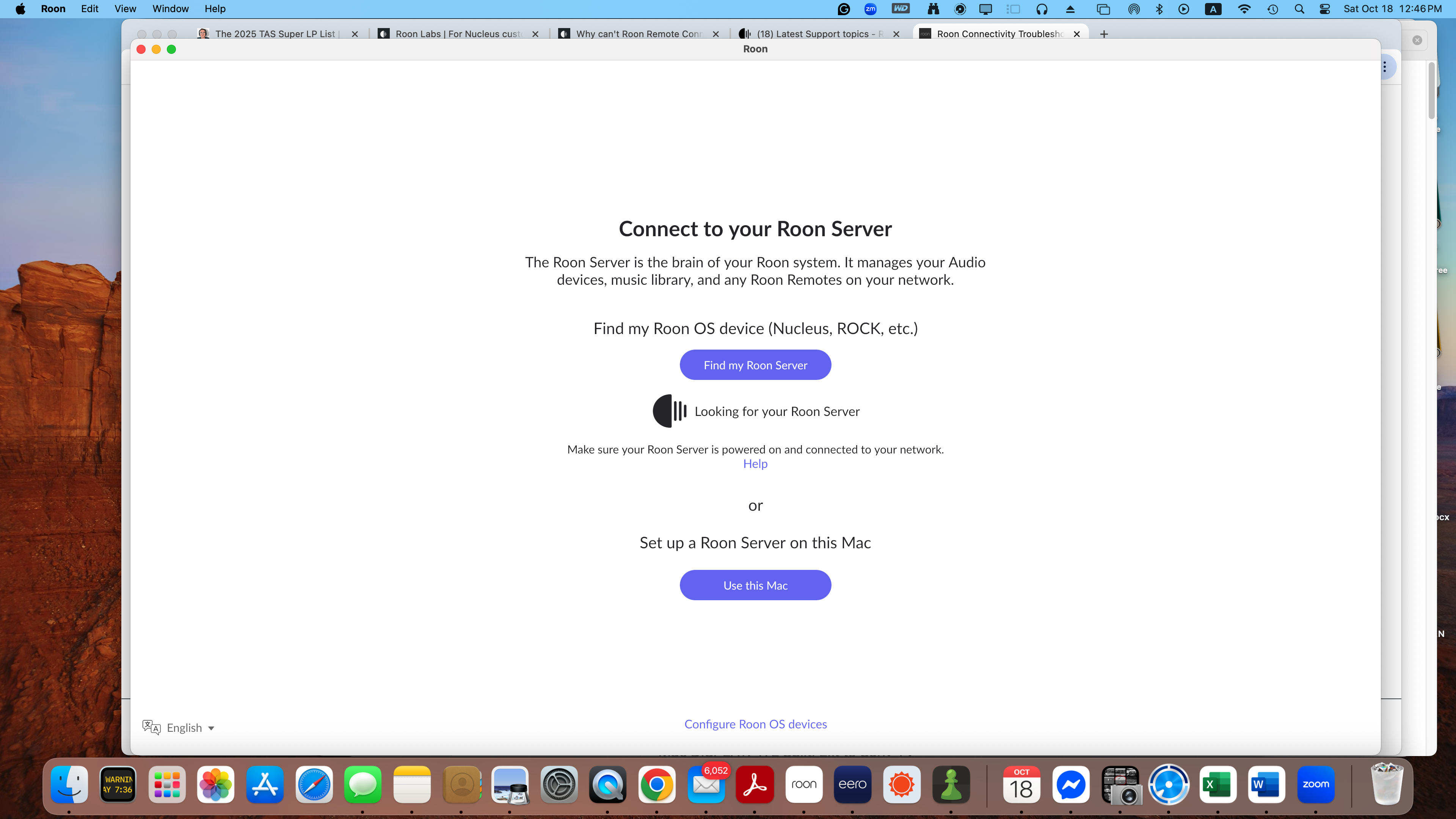

Roon suddenly stopped working on October 16th and cannot be detected by Control4 or OVRC, and Roon itself is unable to connect to my Roon Core server. All connectors are tight and I have reset the server, the network and every other device in my system. The subnets match... System: Control4 controller, Pakedge network distributor, Eero mesh network router; all devices are connected via Ethernet cables. Everything worked fine until sudden, unexplained failure on October 16th. Please help!
Xfinity modem and two Eero mesh routers

First thing we can see from the analytics data report is that your Mac has multiple IP addresses within your home local network. Can you please remove either wi fi or ethernet connection and keep only one ? Thanks!

I uploaded the roon activity log data from the Mac, but I’m not sure that was the “log” data you were looking for. Should I log out and switch servers, using the Mac as the server, instead of the Nunleus?
