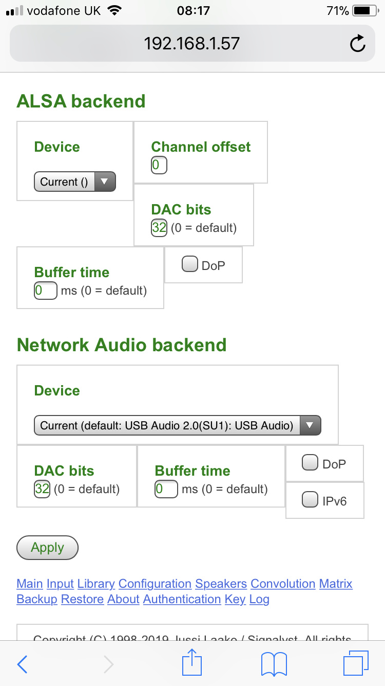

Then, after rebooting the microrendu and then the STi7 (or vice versa), a further attempt at playback results in the message “Playback failed because $ couldn’t connect to HQPlayer”. So, a look at HQPlayer Config to ‘re-Apply’ is attempted only for the same failure message to appear.
Ultimately, I have found that a hard reboot of the STi7 and/or the microrendu can eventually result in a need to log back into HQPlayer Config such that two options become available under ‘Current’ instead of one. This signals the point that I can recover playback by making an output device selection under ‘Current’ before returning to Roon to hit Play again with success.

And your HQPe config page to show all settings?
I have a pretty good idea of what the STi7 can and can’t handle (personal experience), so I might be able to see something.
