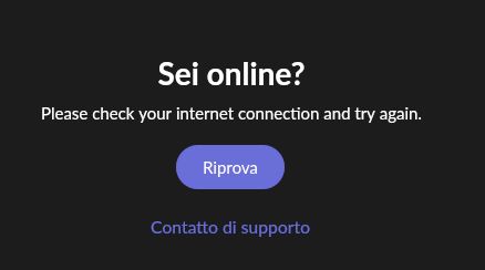

Suddenly, unable to login - I'm stuck with message "Are you online ?"

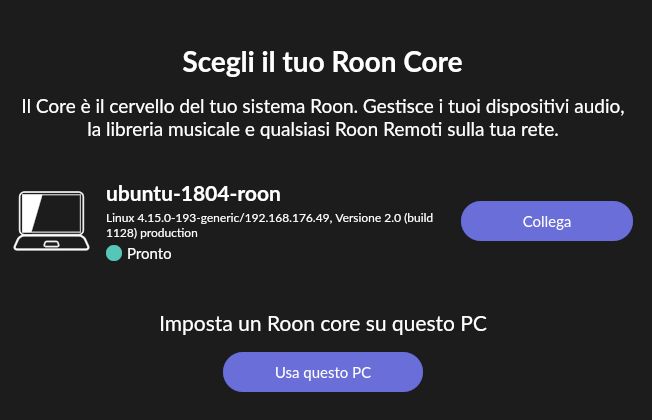

Roon Core Machine
Ubuntu 18.04 with version 2.0 build 1128 2Gb RAM
Roon Core is on a virtual machine, I have tried to use Roon Client from a pc (wired LAN) and from a tablet
Suddenly, after a reboot of the Roon server, the client keep asking me to login but fails with the message “Are you online ?”
The same problem from a desktop pc and from an Android tablet

The installation was ok, but now, when I run Roon on my pc, I’m stuck with two messages :
  • the already famous “Are you online ?”
  • the new one, regarding the old server, which I cannot de-authorize : when i click the button the page refresh but nothing change, without any error.
