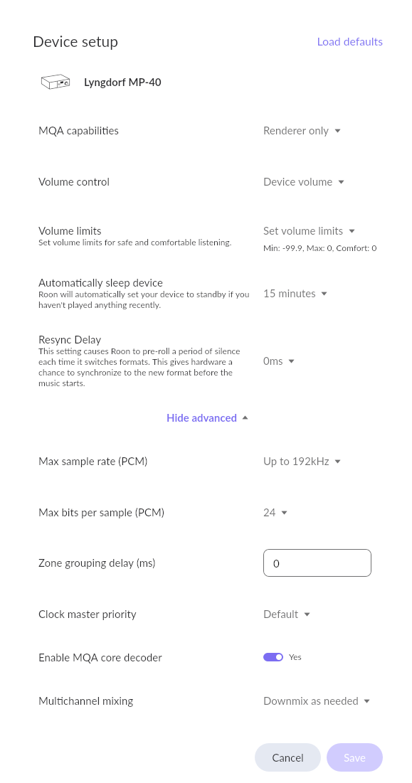

I have music in 5.1 format, but roon is playing it only in 2.0. In the roon set up (advanced section) of the MP-40 is no possibility to select the speaker set up:
the result is then this:

On the Roon Ready input you are limited to two channel PCM, USB can play two channel PCM or DSD and HDMI can play multichannel PCM. If you want to output multichannel content, you’ll want to use HDMI.

an additional question: In the setup of the audio device is no possibility to choose 5.1. This has nothing to do with the DSP processing, as this is a device setup. It doesn’t know where the music is later coming from. So it should at least her show the possibility to declare that MP-40 is a surround-processor.
