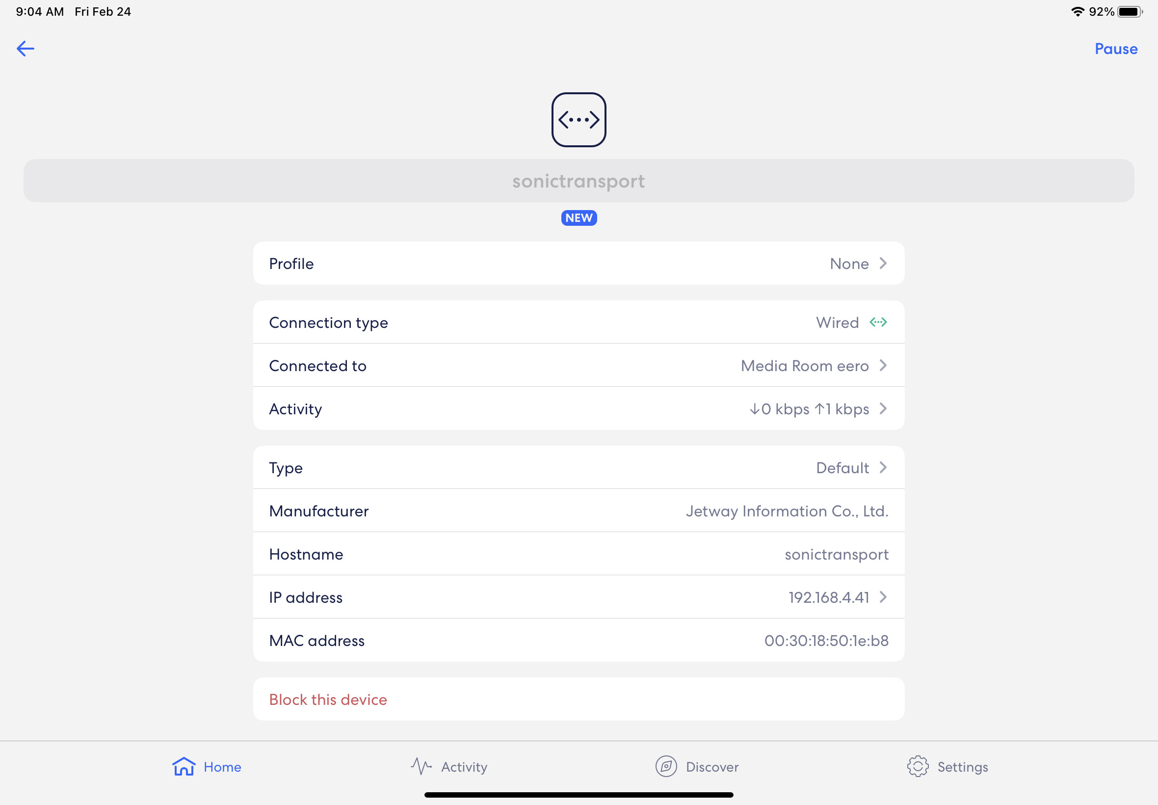

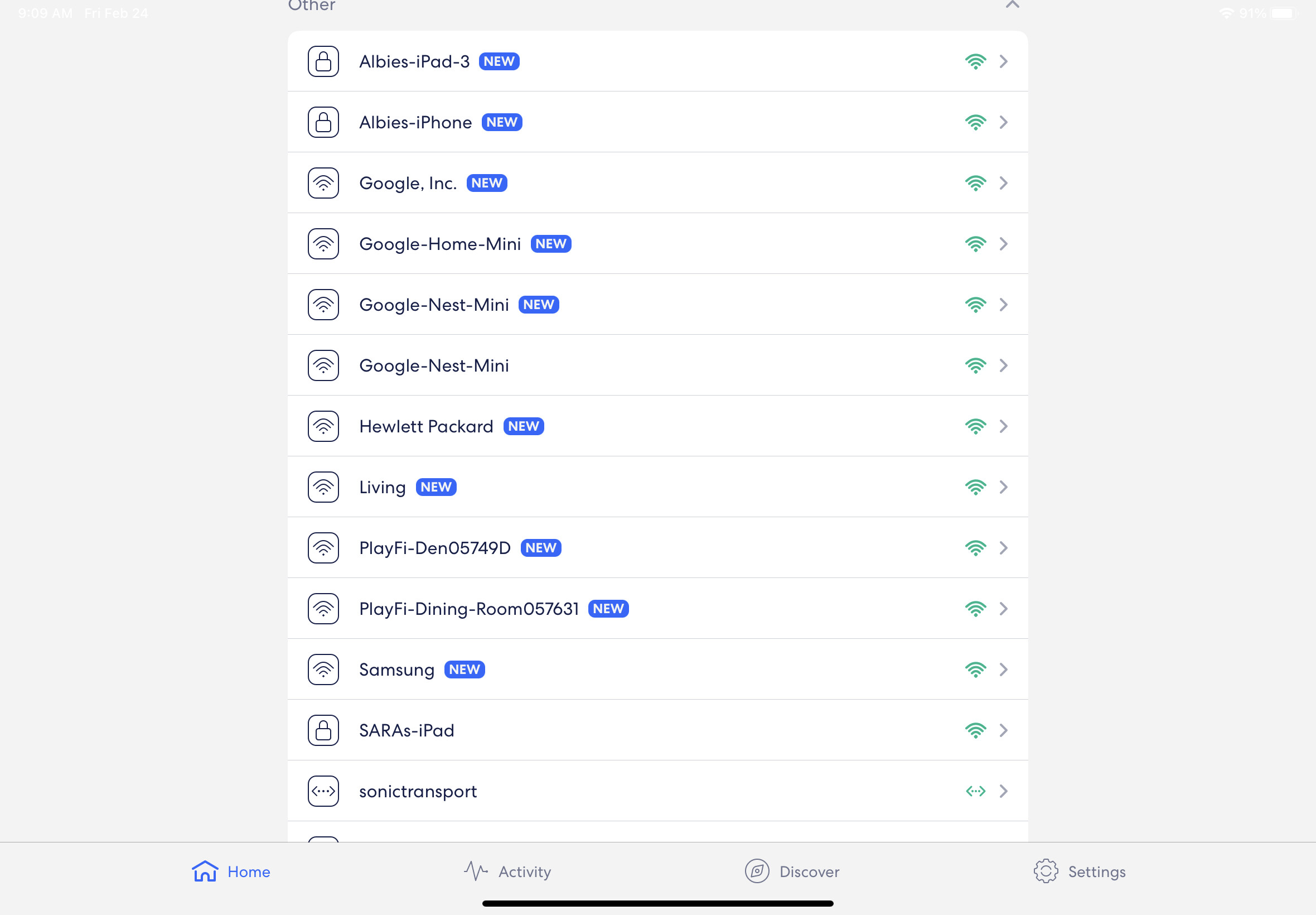

Can you post a screenshot of the IP addresses of the connected devices on your eero router?

Is it possible you now have two separate subnets going on?
They should have the first three sets of numbers identical if all are on the same subnet.
Is this the case?

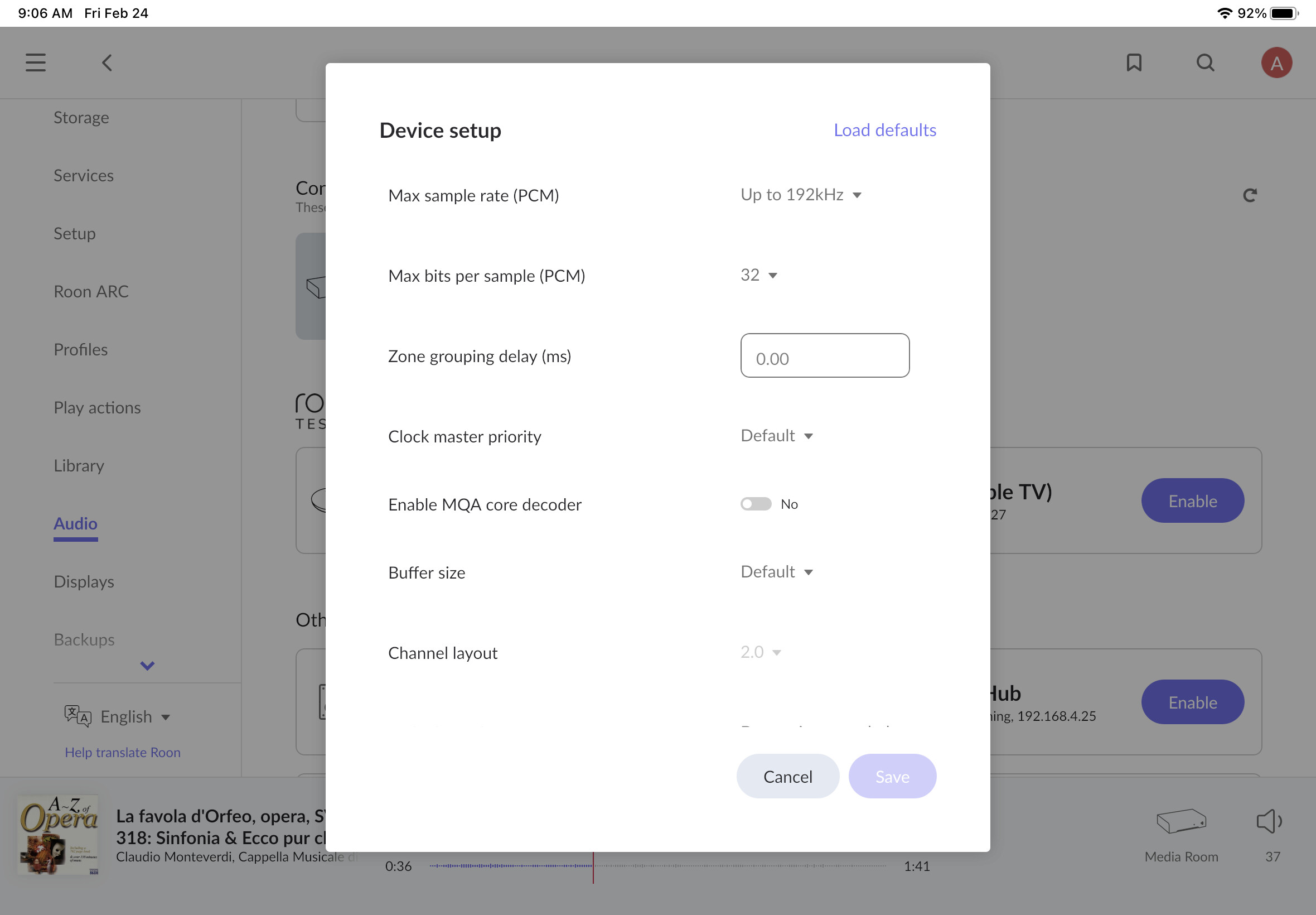

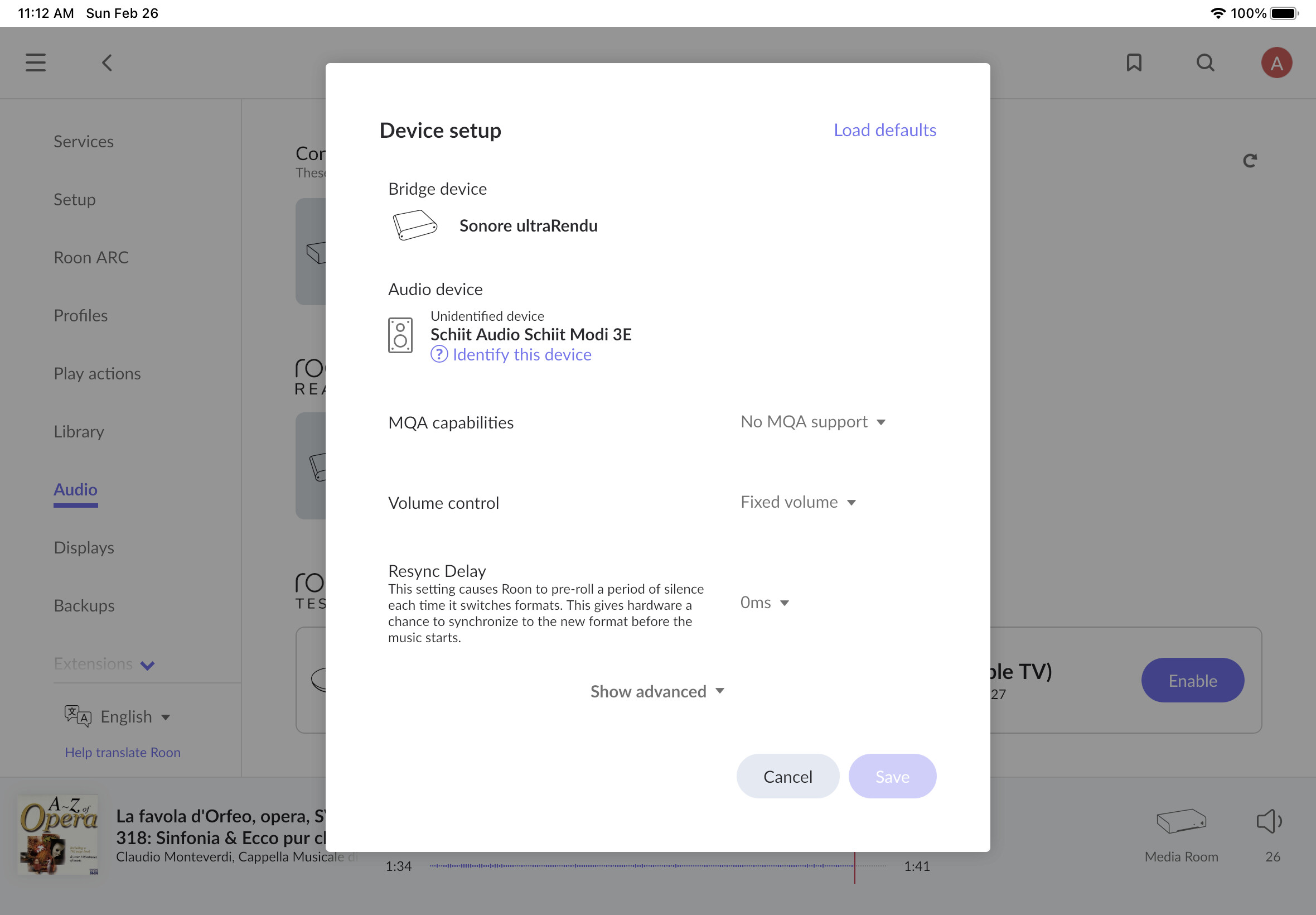

Thanks for your help. This all makes perfect sense and I’ve done everything you suggested. Both the rendu and the sonic transporter are connected to the router via an unmanaged switch. Still no audio through the DAC. Here are screenshots of the audio setup from Roon.
Never mind…it’s working. I now have two media room settings and switched to the other one and now everything is finally working. Really appreciate your help!
